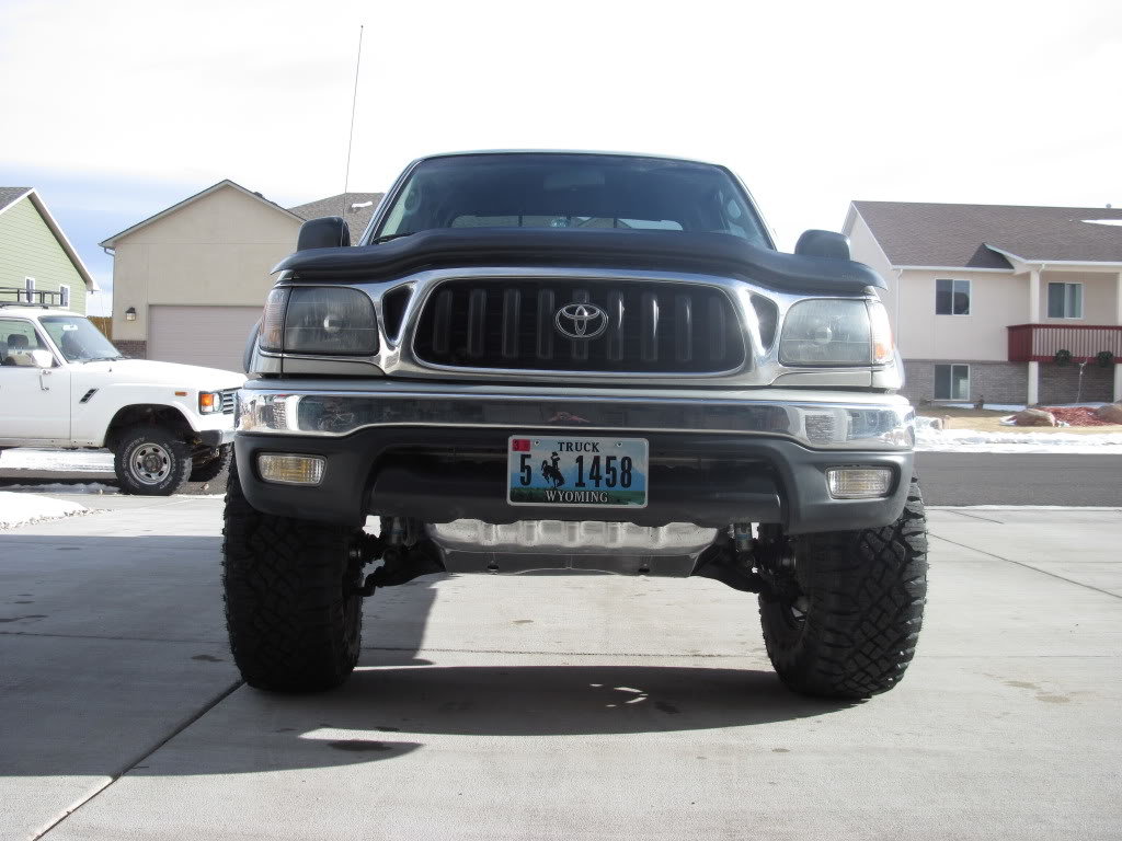

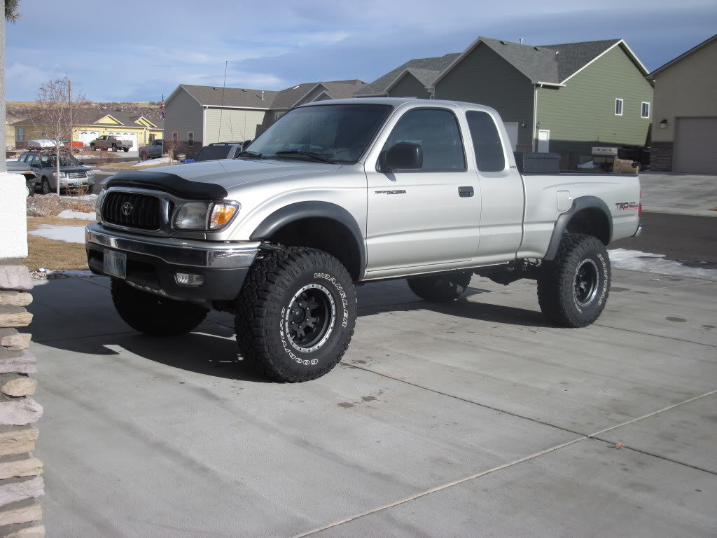

    Well, I figured it was about time I got one of these going…

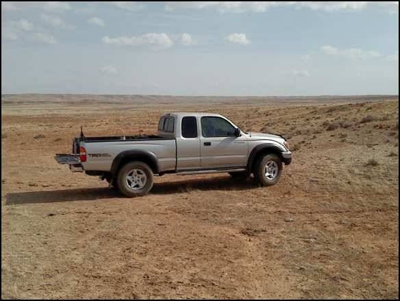

    This is how it sits today:

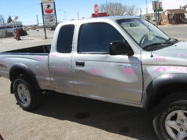

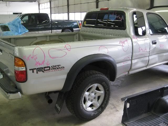

    Then, 7 days after I bought it, this happened:
    Towtruck flipped me back upright, and I drove it home. Ran like new! Gotta love Toyotas.
    Got it to the body shop and the estimate was $9,875! Laramie GM Auto Center Body Shop did the work. They did more than outstanding body work. I cannot believe how good it looks. You can imagine how devastated I was about the accident, and they made sure their work reflected their dedication to making me happy.

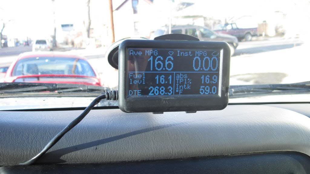

    I then picked up a UltraGauge to diagnose my CEL. Found it was a dirty MAF sensor. Pulled it out and saw it had oil on it from the accident, replaced it, and it was good as new!

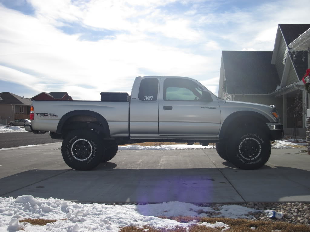

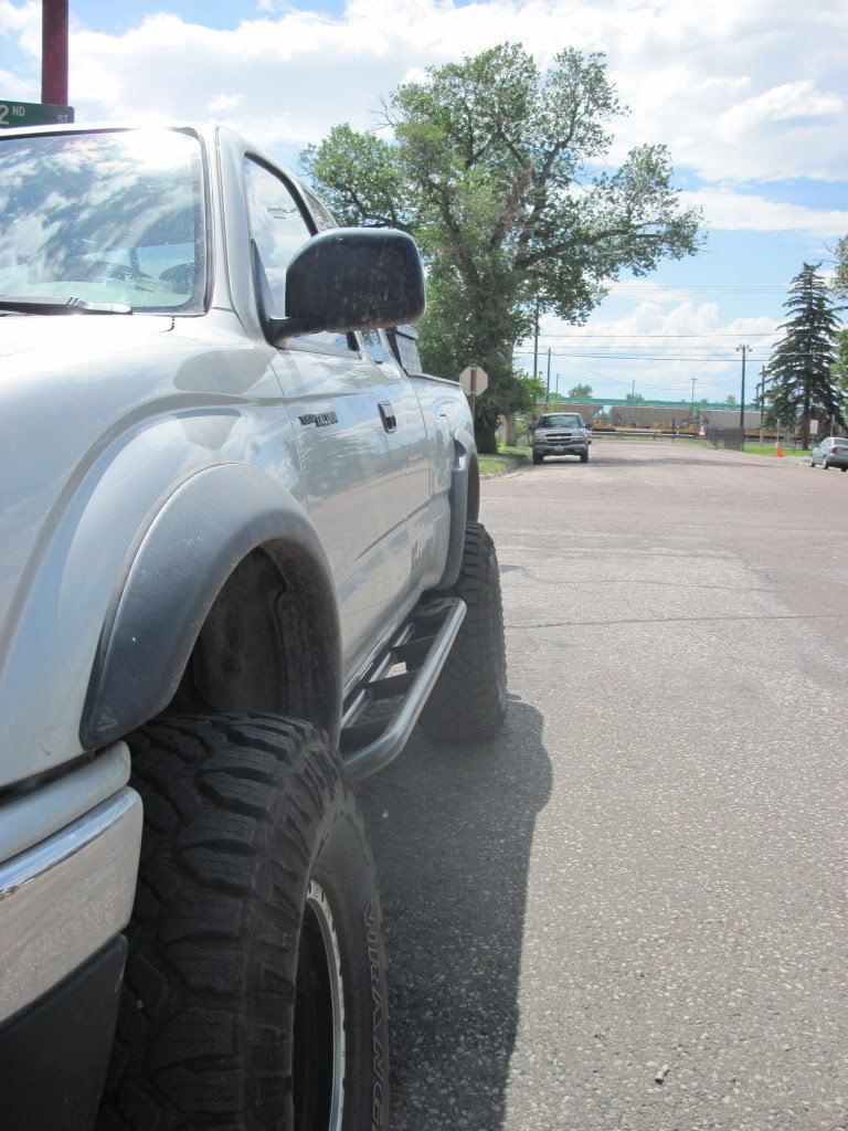

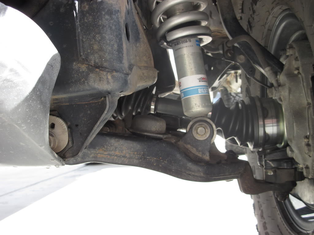

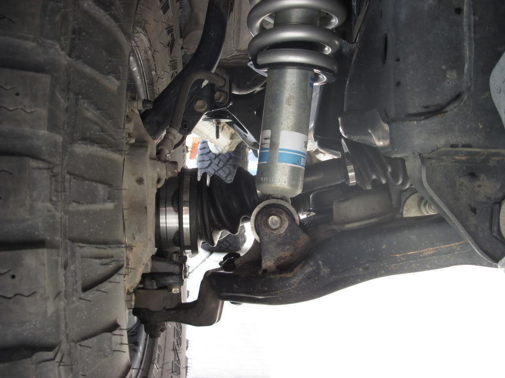

    For the front, I got Bilstein 5100 Adjustable Shocks and ToyTec/Eibach coilovers from ToyTec lifts in Colorado.

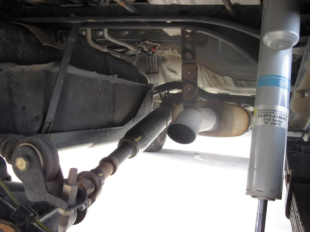

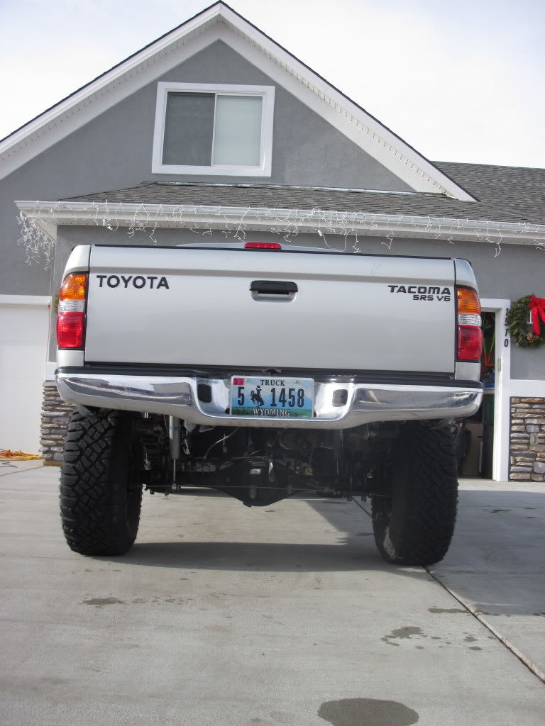

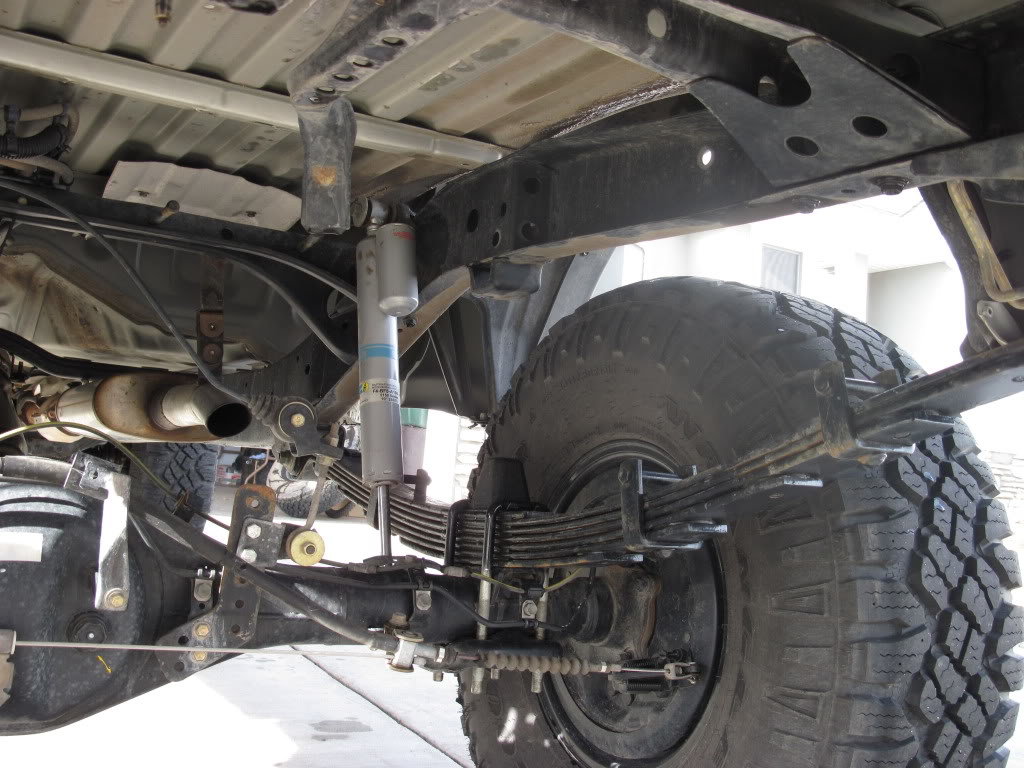

    And for the rear, I ordered AllPro Expedition Leafs, Bistein 5150 10.5” Travel Shocks, and an extended rear steel braided brake line. Jon from AllPro Offroad personally delivered my rear setup to me on his way to go hunting here in Wyoming. Good customer service!

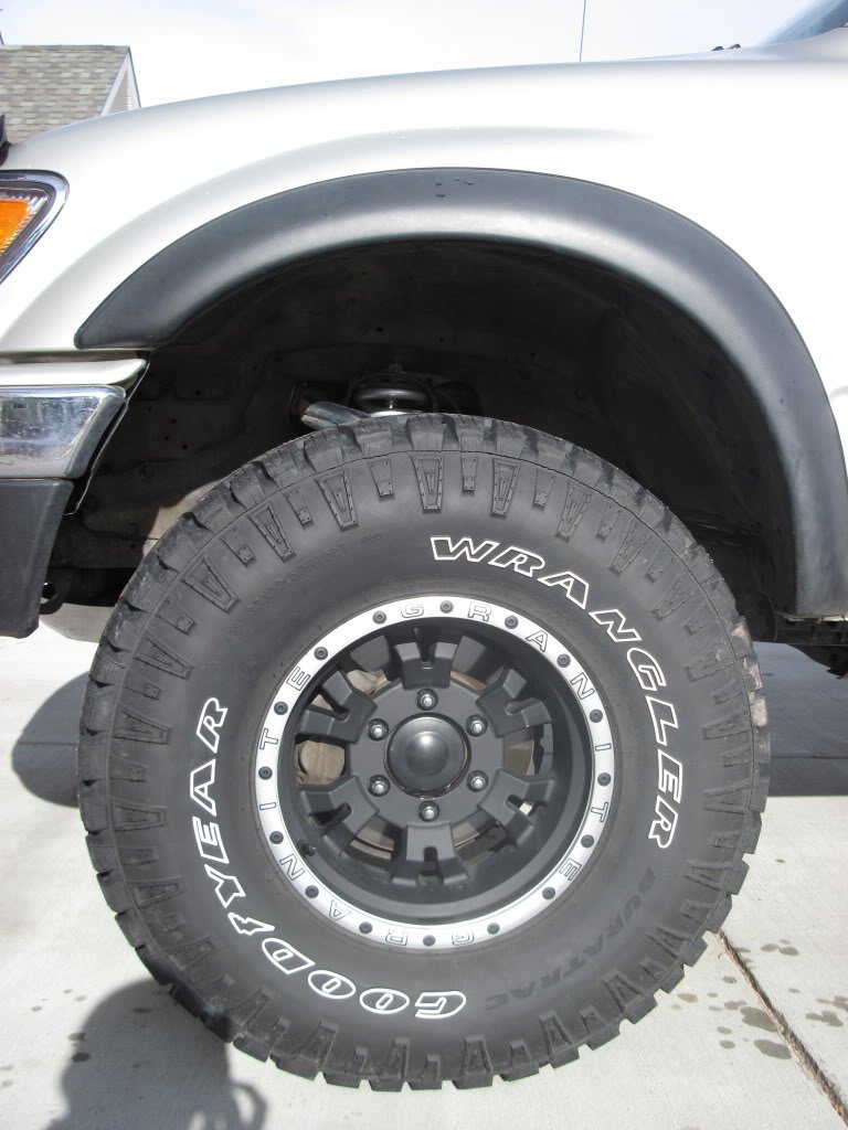

    For tires and wheels, I decided to go with the popular Goodyear Wrangler Duratrac in 33x12.5x15. I wrapped these around 15x8 Granite Alloy GA9’s. I have them set to 32psi currently.

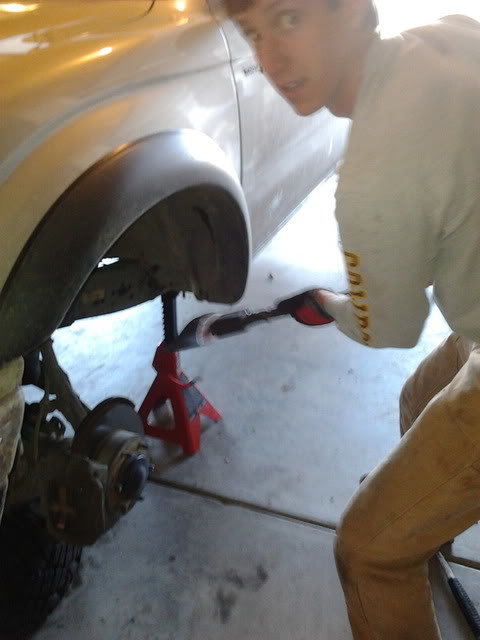

    Once I got a free weekend, a couple of guys I know who attend WyoTech helped me install. Only cost me a case of beer for the install! I got 3.2” of lift in the front, and 4.15” of lift in the rear.
    I had to do the BFH Mod on the pinch weld, thanks to 45acp for taking the picture :rolleyes:

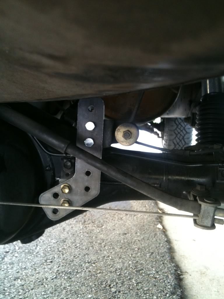

    I soon noticed my brakes weren’t quite normal. I consulted JLee, and he designed a BPV Relocate Bracket for me based off one he made for his own truck. These are the ones he now sells through B.A.M.F.! I would highly recommend them. Beefy ¼” plate. Made my brakes a ton better!
    (This picture is the one on JLee’s truck that has on his BPV Thread)

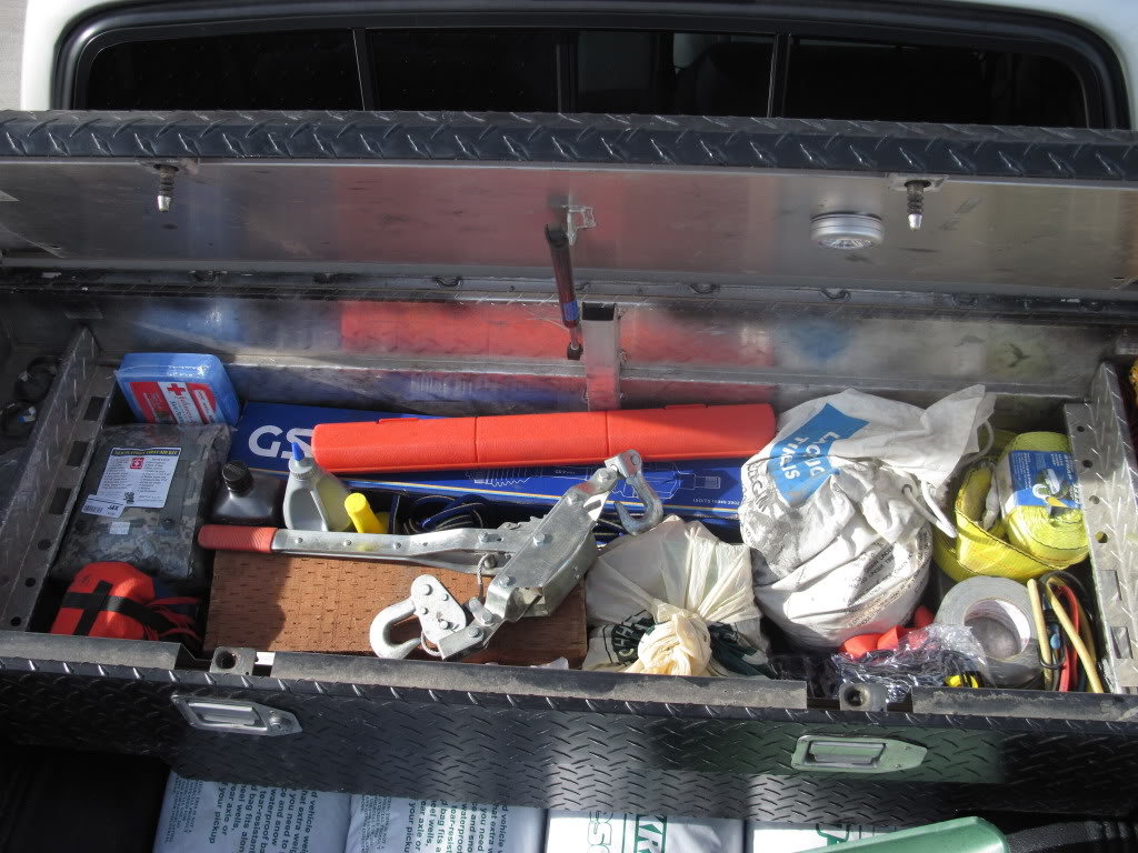

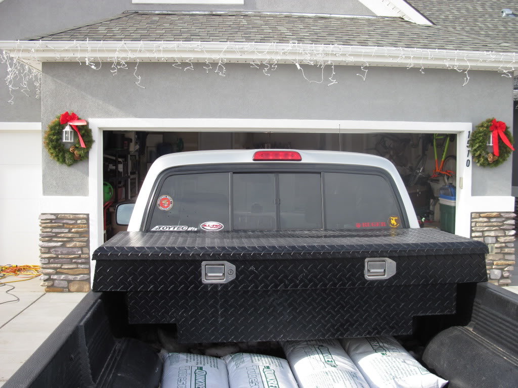

    Then I decided that I needed more space to put my recovery/survival gear, so I stole a toolbox off of 45acp’s truck (thanks Jonathan) :D.
    Inside, I have:
    -2 First Aid kits
    -Hunting Survival kit
    -Tire Chains
    -2 recovery straps
    -Ratchet straps
    -Bungee Cords
    -Duct Tape
    -500 ft. of multipurpose rope
    -5 Climbing grade carabiners
    -Wood block (for bottle jack)
    -Come-a-long
    -Shovel
    -Torque Wrench
    -Metric and Standard Socket sets
    -Various tools
    -Spare CV Axle
    -Front Diff. Fluid
    -Extra Oil
    -Heet fuel additive
    -4 MRE’s and heaters
    -Hose Clamps
    -Bed net
    I currently have 240lbs of sandbags in the bed to give me some weight/traction in the snow.

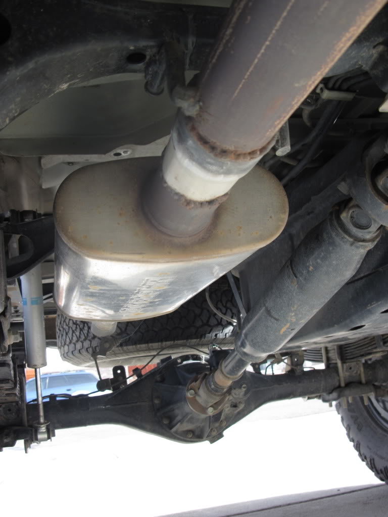

    I wanted to make some noise, so I ordered up a Magnaflow Muffer. Went with the 18” Center in/out. Had it dumped with a turndown right before the axle so it’s out of the way of my leafs. I love this thing! I definitely noticed a power increase, but can’t say much about my MPG, as I love hearing it roar :D :rolleyes:.

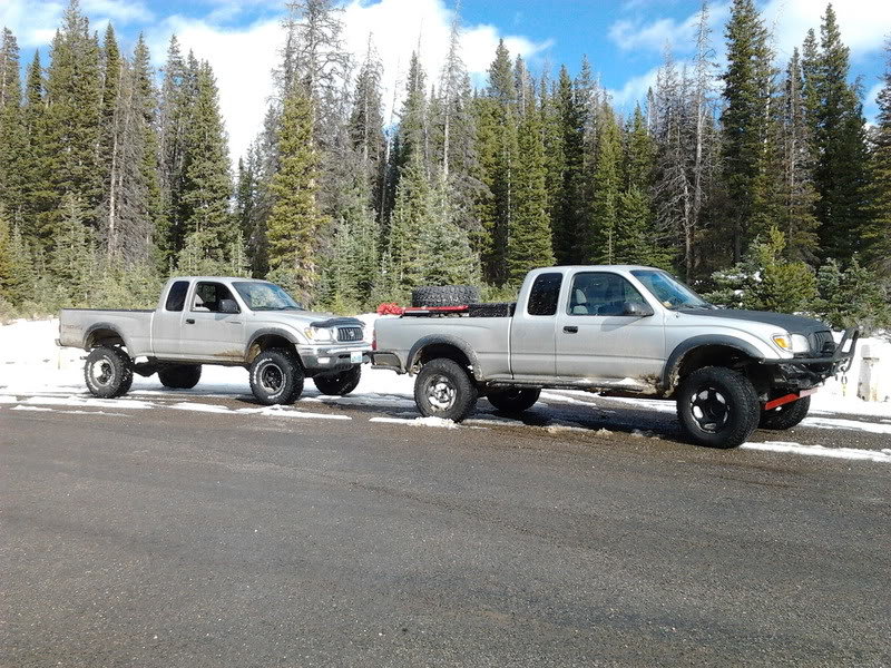

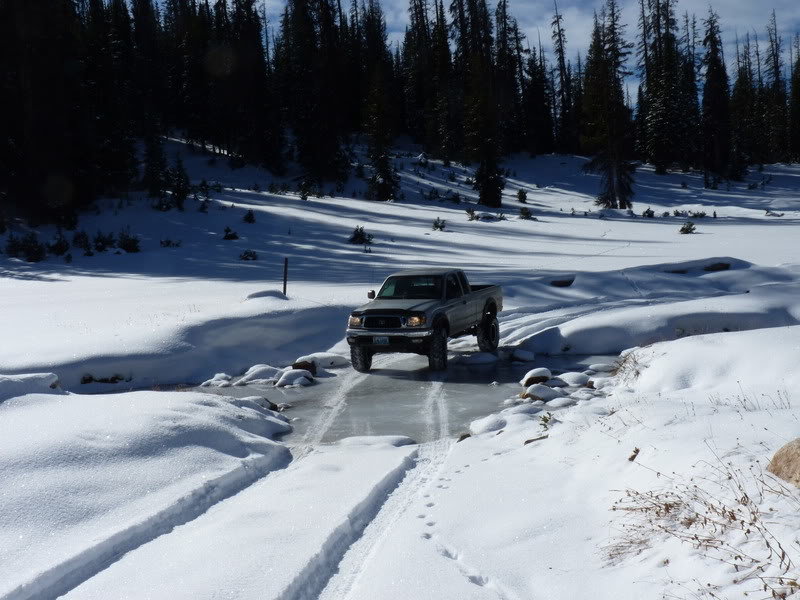

    And some fun wheeling with 45acp:

    -AllPro (Crown) extended steel braded rear brake line

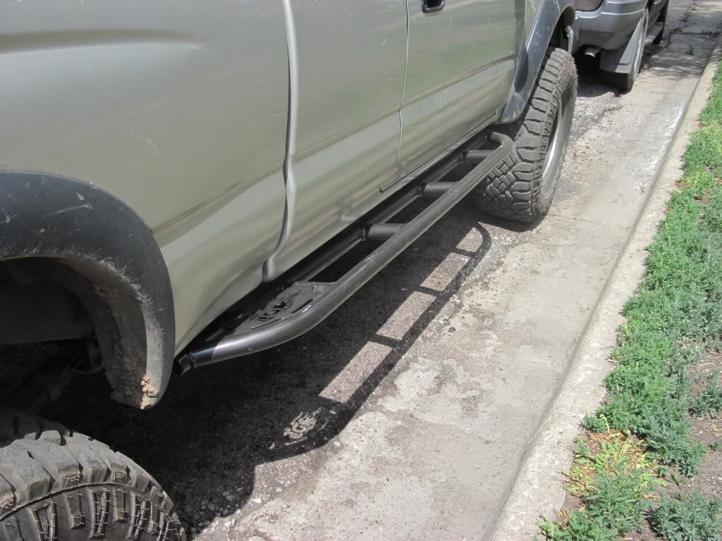

    I got my sliders welded on a couple months ago, in the Fall I guess:

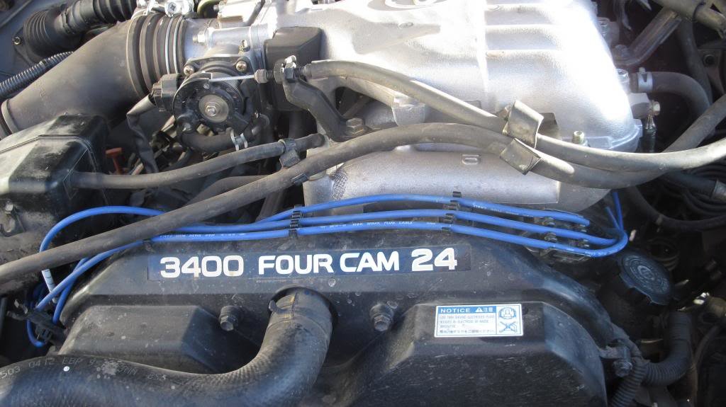

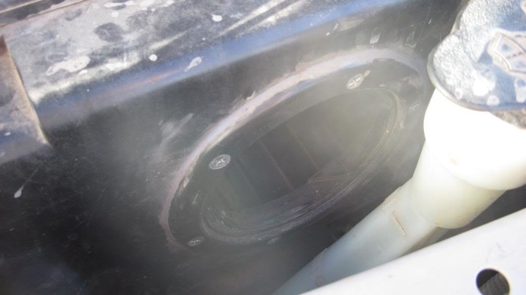

    Soon after came the deckplate mod and a AFe Pro Dry S

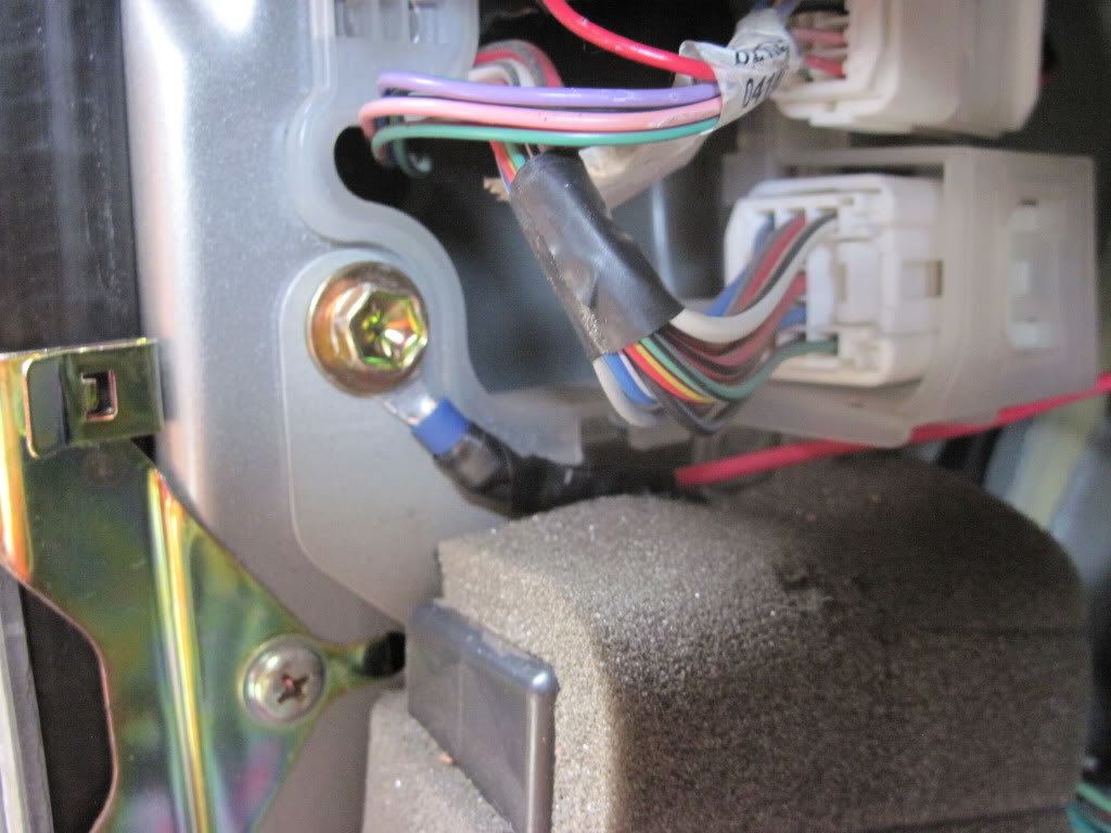

    Was bored one day so I did the Grey Wire Mod
    Then got an Ultragauge

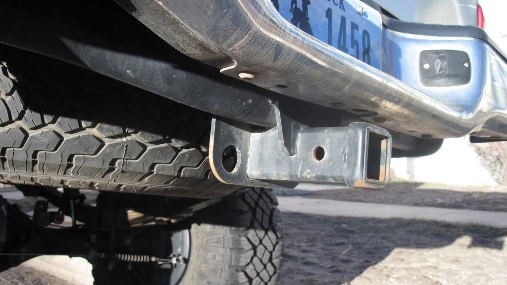

    Then I got a hitch, thanks to Blackdawg, 45acp installed it for me while I was at work (I need to find more friends like him)
