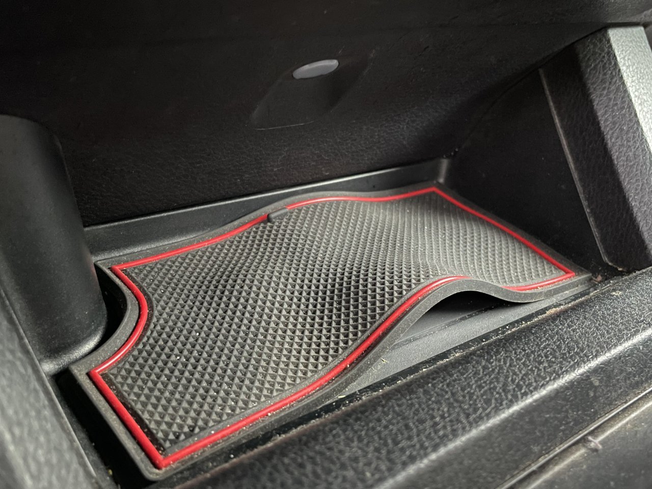

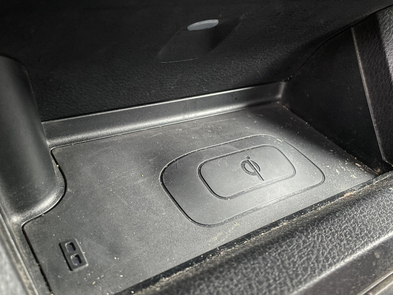

    As stated. Has anyone had this happen?
    And if so, is there any great way to disassemble the pad and replace or remove it? Thanks in advance!

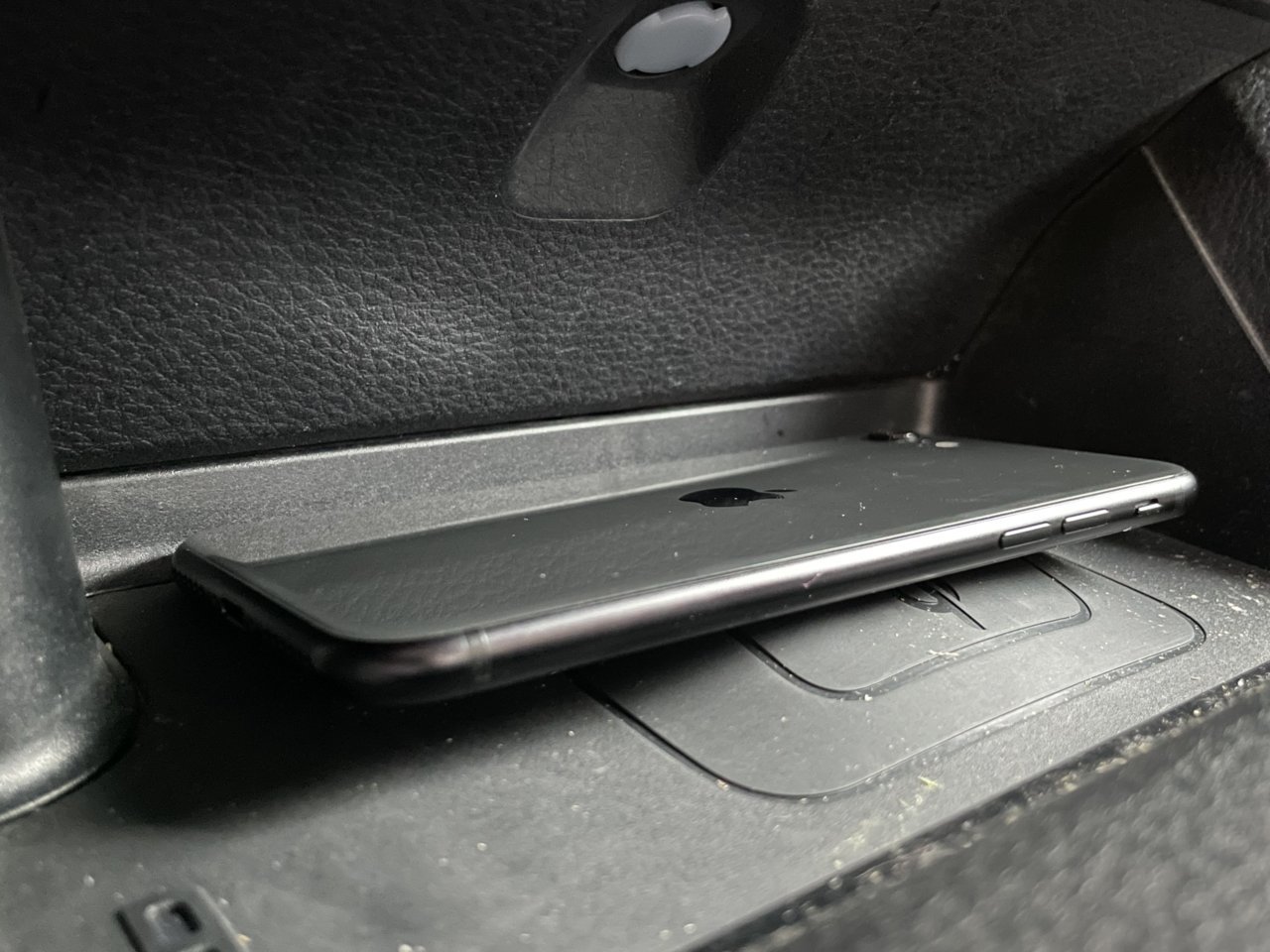

    iPhone on top for reference.

    I think it’s a pretty common issue. I took mine apart about a year ago and gorilla glued the pad down. Has been flat ever since and still works fine. From the factory the rubber isn’t attached to the charger pad so the heat causes the rubber to warp.

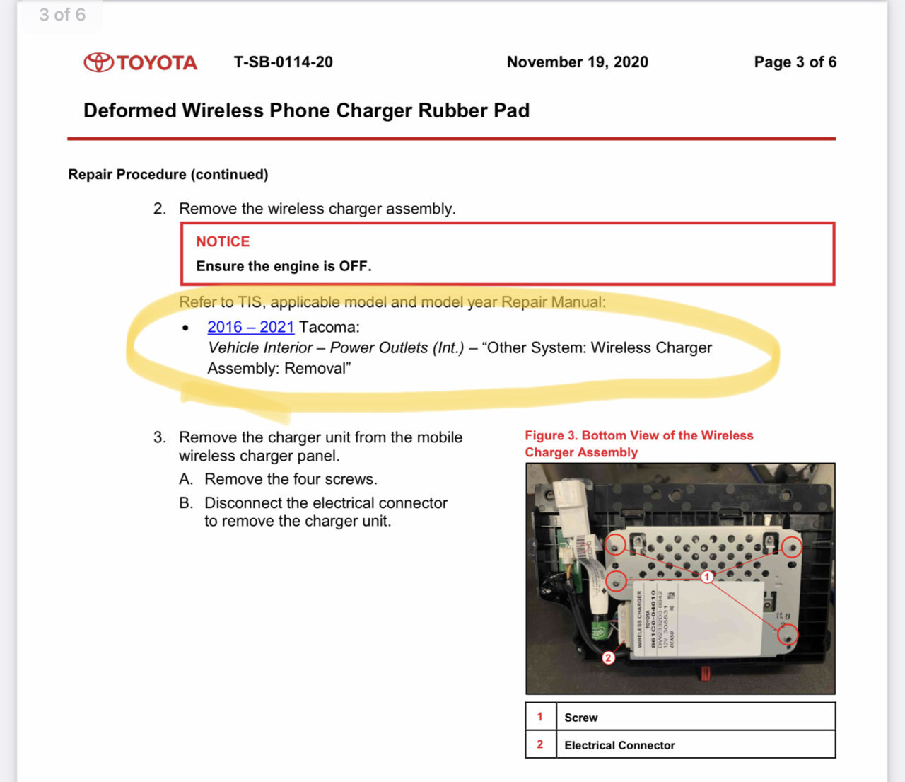

    Yes. Take a look at the threads that I created.

    I was just about to say I found it! But it doesn’t really cover how to actually do the disassembly portion.
    Would be nice if it simply covered where to get that. Is there a full Repair Manual posted around here or is that something only attainable via Toyota? Really just want to remove it and see if it can be re-glued or just replace it if it’s cheap (seems to be under $50). Would make a nice weekend project sometime.
