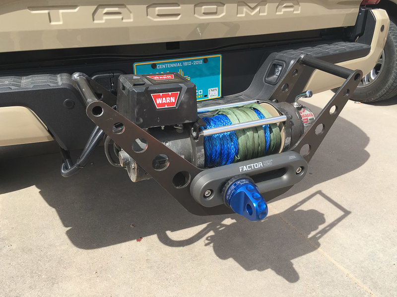

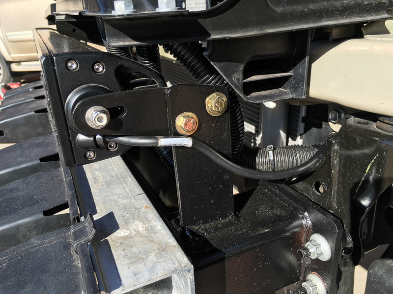

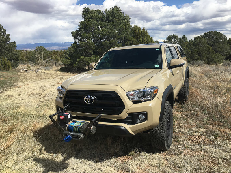

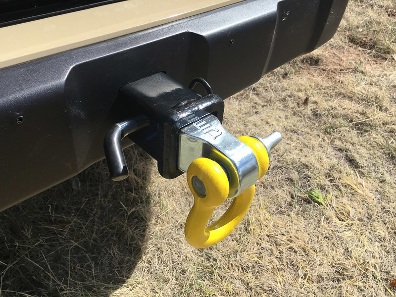

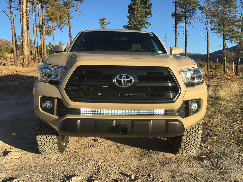

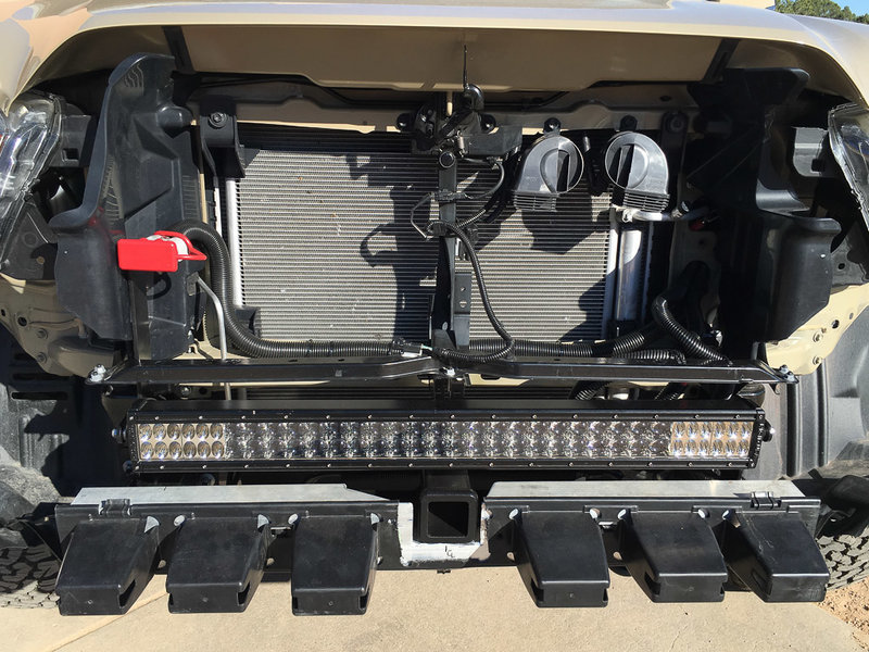

    Continuing with update on the front receiver install for front and rear receiver winch capability. I will post a thread on this when I am complete.

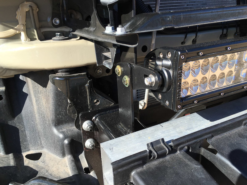

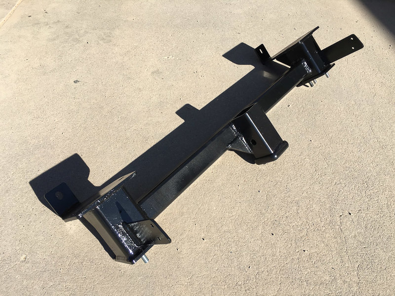

    I was worried about the thread engagment on the six studs that (along with two other lower bolts) mount the receiver assembly to the frame. The mounting plate on the steel sideposts from Mobtown is thicker than the Aluminum crush post normally mounted to them. Combined with that increased thickness, the additional thickness of the 3/16" mounting plates of the lightbar mounts meant that there was 2-3 threads not engaged on the nuts. Not acceptable.
    To resolve this issue and ensure solid engagement, we fabricated a couple of lightbar mounts welded directly to the sideposts, Since the (really nice) Apex lightbar mounts already held the lightbar in the exact correct position, we just used them as a jig and welded the new mounts to the posts and match drilled to the arm of the old mount. So the tips of the arms from the Apex mounts from Mojave Madman are reused but most of the mounts were hacked up and scrapped. I also bolted a mount for the winch power quick connector to the lightbar mount. The winch power connector can be easily accessed through the grill when plugging in the winch.
    The front receiver with the new lightbar mounts:
    SB175 connector for winch power:

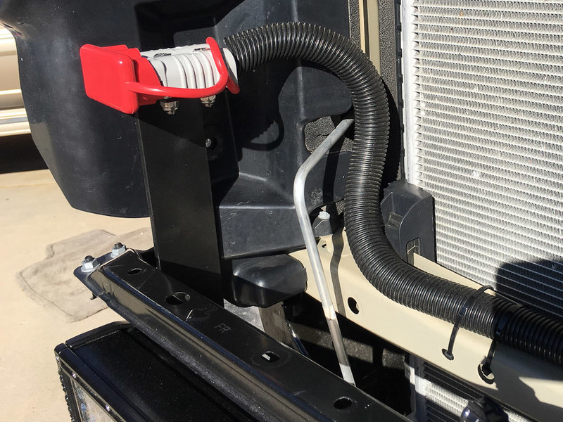

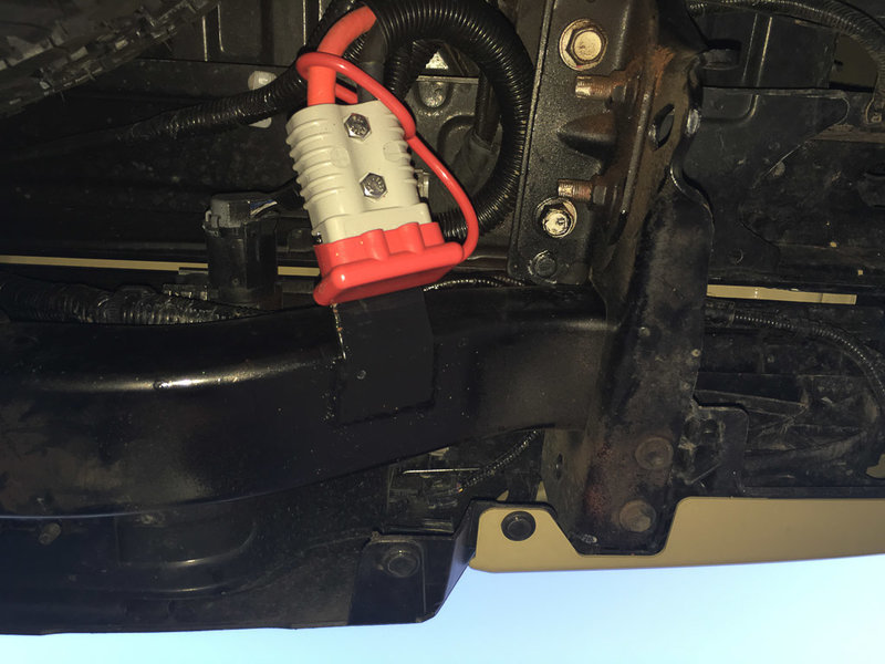

    Again similar to my 2nd Gen truck described in this thread:
    https://www.tacomaworld.com/threads/receiver-winch-install-front-and-rear.368480/

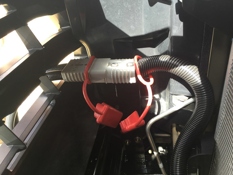

    I ran 2 gauge welding wire to the front and rear with gray Anderson SB175 quick connectors. There is a disconnect near the battery as I do not want to leave the front and rear winch cables hot except when in use.

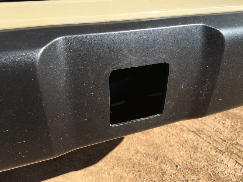

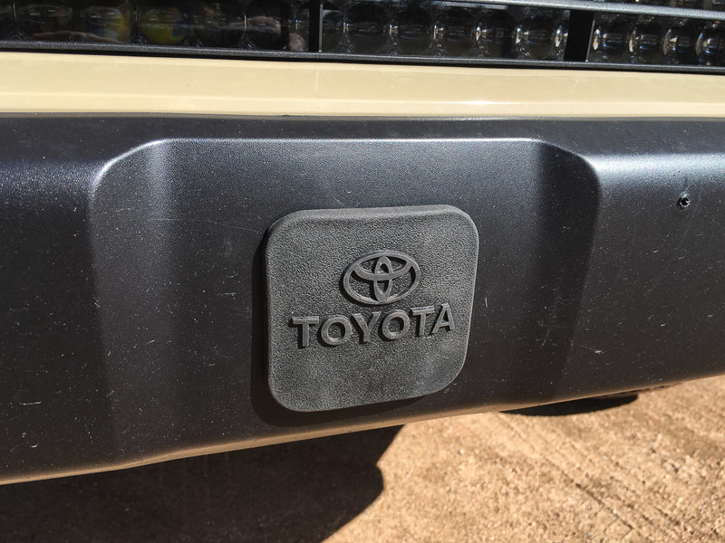

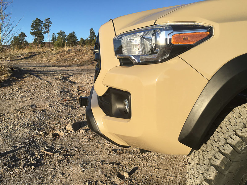

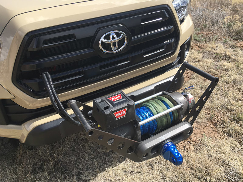

    The design of the 2016 grill and front clip left a series of bad options on where to penetrate with the receiver tube. Typically on 2nd Gen trucks, front receivers penetrate through the lower grill and given the fat lip lower bumper I was not sure how that would look and also I wanted to keep a 30" lightbar mounted in the lower grill.
    So after considering the various bad options I decided to penetrate right through the center of the bumper face. The bad news is that in order to provide clearance for installing/removing a hitch pin, the receiver would need to extend out from the bumper more than I wanted. I am not really happy with the result, but since the huge grill is already silly and I am a function over form sort of guy I went with it. The result is very functional, but leaves a lot to be desired aesthetically. The winch is normally stowed in the bed on a bracket and is only mounted for winching operations. I will likely put a plate bumper on the truck when more options become available, so I will just deal with the receive protruding out the bumper for now.
    Overall look with the front receiver:
    Truck with Warn M8000 mounted to front receiver:
    Winch power connection through grill:

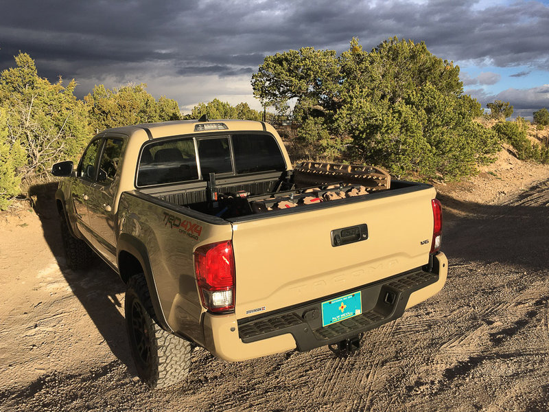

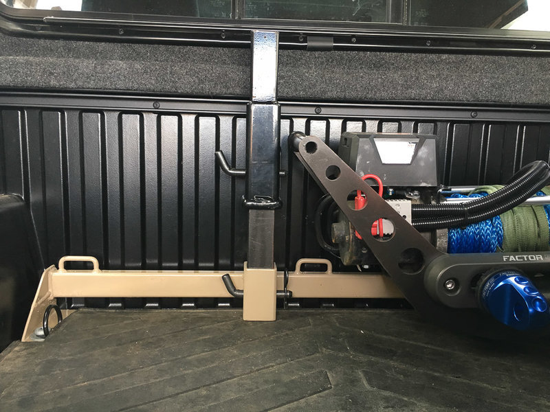

    Winch in rear:
    Rear winch power connection:
    Fringe benefit of a front receiver is a solid recovery point:

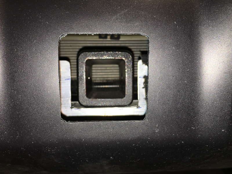

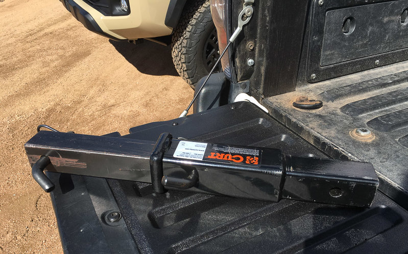

    Since I was not thrilled by the look of the front receiver protruding from the front bumper I looked again for a way to avoid it. I found it was very easy to install/remove the hitch pin on the inner connection between the inner receiver and the receiver extension I was using by just reaching behind the grill. I decided to pull out the receiver extension and store it connected to the winch drawbar in the bed. I then used a simple bungee and hitch cover to plug the hole in the front bumper. Looks better and nothing sticking out of the bumper to hit your knee on.
    I will build a longer winch drawbar from 7075-T651 Aluminum to replace the current heavy steel drawbar/receiver extension combo.

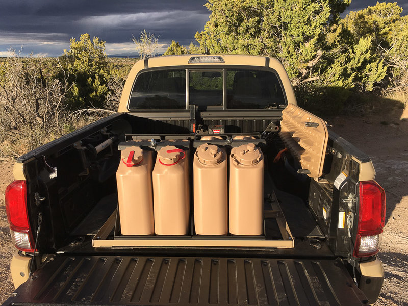

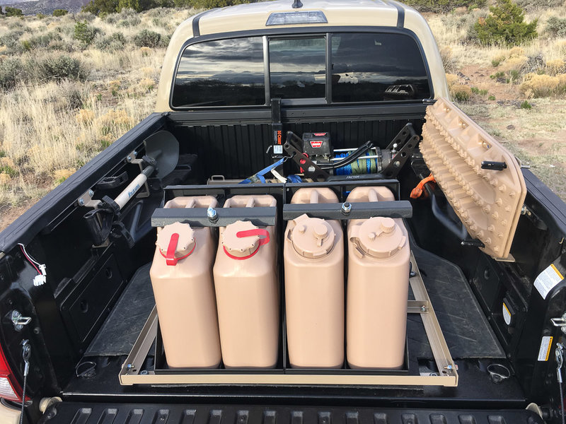

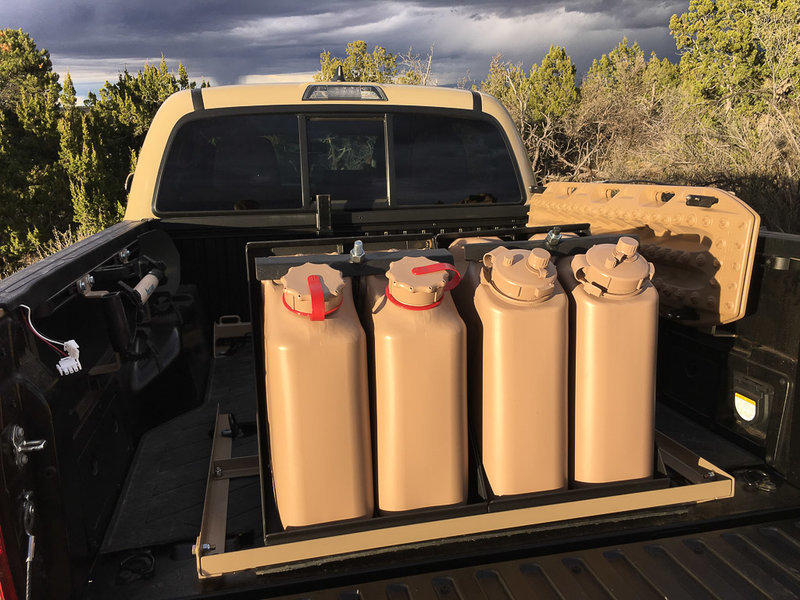

    I pulled off the Snugtop shell and built a simple bracket to secure the holders for the Scepter fuel (MFC) and water cans (MWC) to the bed bolts for a longer trip I have planned.
