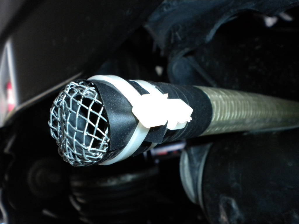

    #32
    OffroadToy
    OffroadToy This ain't Dodge City, and you ain't Bill Hickok
    Sep 12, 2009
    #22680
    5,327
    4X4 Offroad
    snugtop, piaa, weathertech, westin, oem bed mat, trd seat covers, avs inchannel vent visors, 2" suspension lift, front diff drop, rear differential breather extension, oil filter drain hose, a/c drain hose extention & reroute, front window tint, cat theft protection plate, tailgate clamp mod, xpel headlight/foglight protecters, oem block heater, bfg 265/75R/16 a/t k/o's, cabin air rodent protection screen, rcbs illuminated 4X4 switch mod
    A section of garden hose works...
    attached screen on drain hose to keep the critters out...

  18. Sep 14, 2013 at 10:37 AM
    #38
    Taco Pete626
    Taco Pete626 [OP] Well-Known Member
    Dec 31, 2012
    #94116
    624
    Peter
    Southern California
    2013 Regular Cab 5-spd (Sold )
    - Undercover Flex tonneau cover - Pop N Lock tailgate lock - Weathertech DigitalFit floor liner - Sick Speed Ol' Skool white shift knob - Bench seat mod - Wiper mod - Cruise control mod
    That looks like it didn't cost you anything! I do have some old garden hose lengths in garage. I may give this a try. Thanks for sharing.
