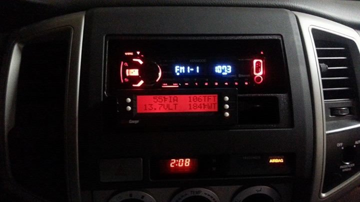

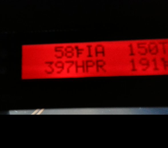

    heres the Scangauge 2 readout like I was saying..............
    top left, Intake temps
    top right, trans temp
    bottom left, a cute little Horsepower readout
    bottom right, water temp.
    all configurable, plus it scans, reads, and clears check engine lights.
    I have mine mounted here now and the configuration is the same, except I swapped the horsepower calculator for voltage
