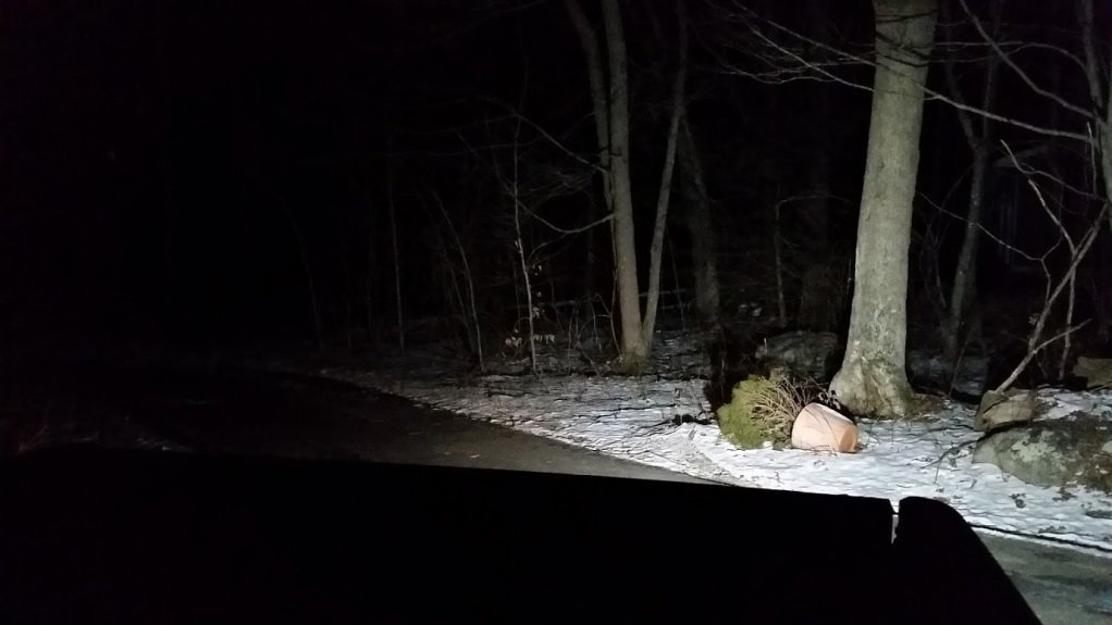

    Well I finally installed one of the lights on the back bumper, like Islander1089 did. Did the drivers side. Here is a picture showing the light output. It did take me some time, mainly just trying to get the nut underneath/inside the bumper. Not much room to tighten it up. I LOVE how much just one light puts out.
    ISLANDER1089 likes this.
