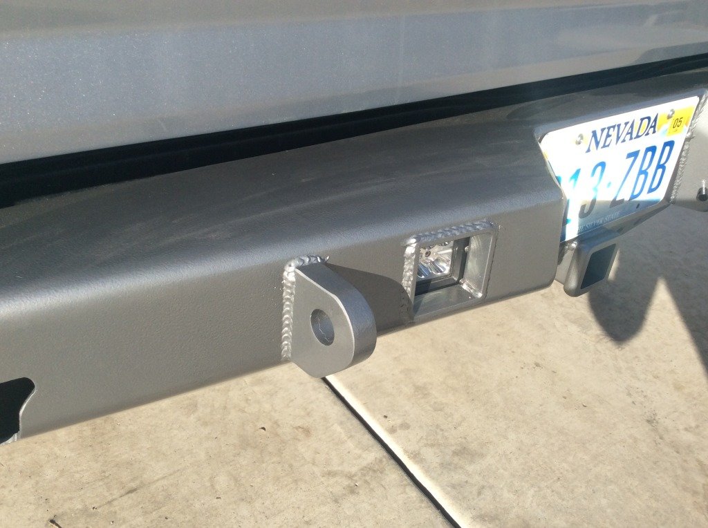

    I have one 3x3 pod in my bumper. It's plenty backing up. Just spliced into reverse lights

    At The Helm
    At The Helm ATH Fab Vendor
    Mar 25, 2015
    #151787
    1,361
    Morgan
    Gardnerville, NV
    2015 AC 4x4 TRD OR & 2019 T4R
    Kings, TC UCAS, SCS SR8's, ATH bumpers
    :cheers:

    I will be doing these flush mounts as well, how do you like them?

    They're fine. Plenty of light. I just put in reverse and hit the parking brake and use it to hook up trailers or what not

    How tough is it to cut out the holes in the stock bumper for those? Would it be possible with either a sawzall, jigsaw (I've got metal cutting blades for both) or 4 1/2" grinder? Or some combination like starting with the grinder then finishing with a saw for better precision?

    I havent done it yet but i will be using a pneumatic 3 inch cut off wheel and probably a dremal with a cut off wheel. 4 1/2 inch grinder wouldnt be as precise i dont think and a jig saw or sawzall would make a great cut. Let me know what you end up doing.
