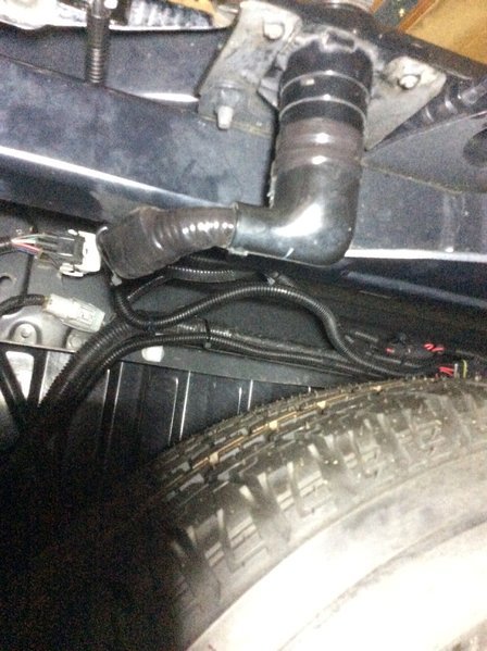

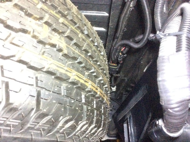

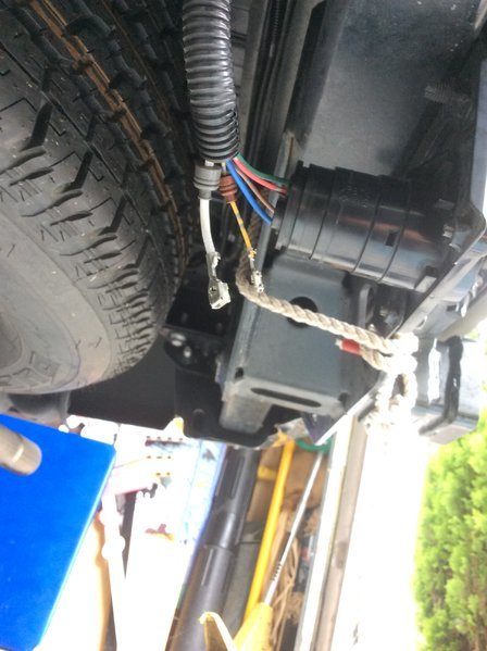

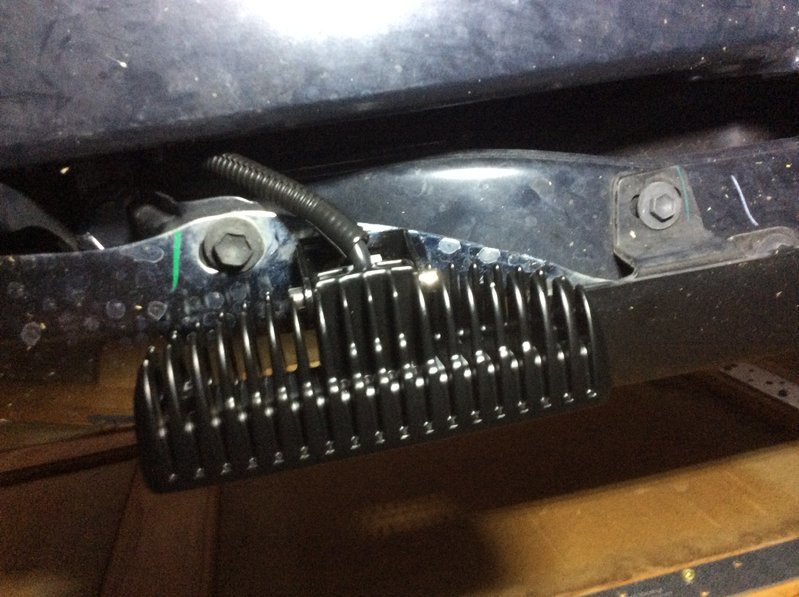

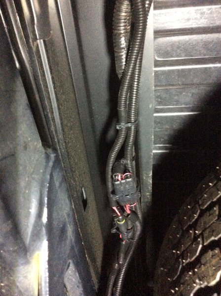

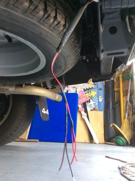

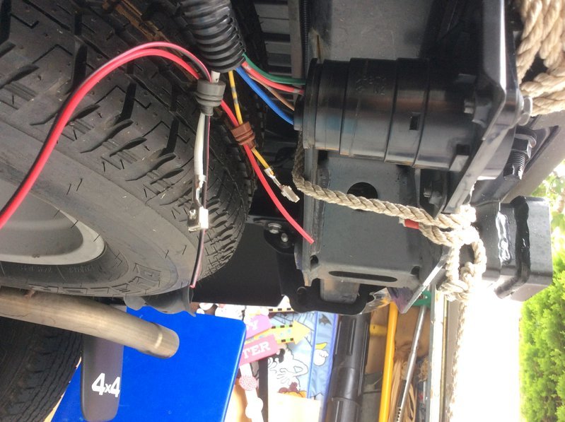

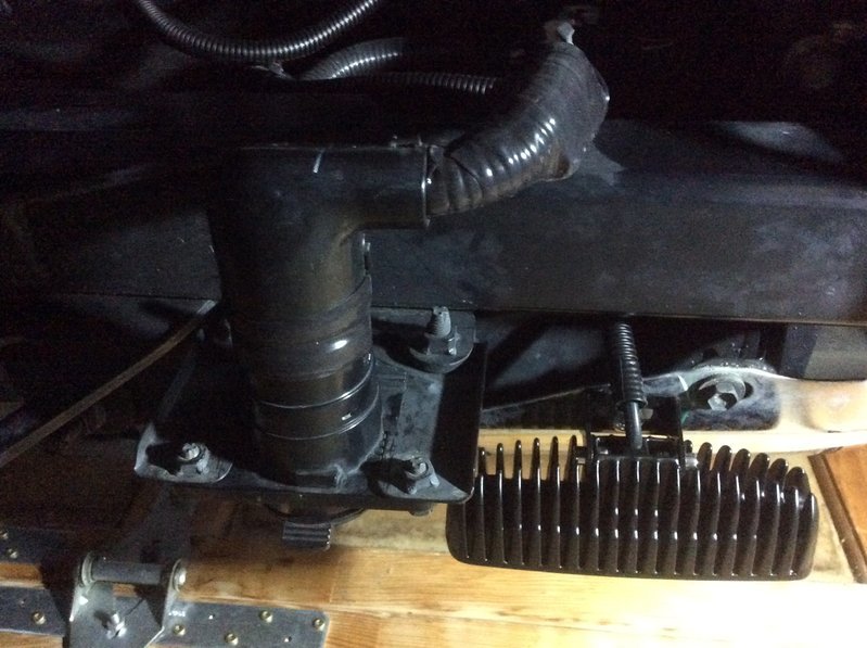

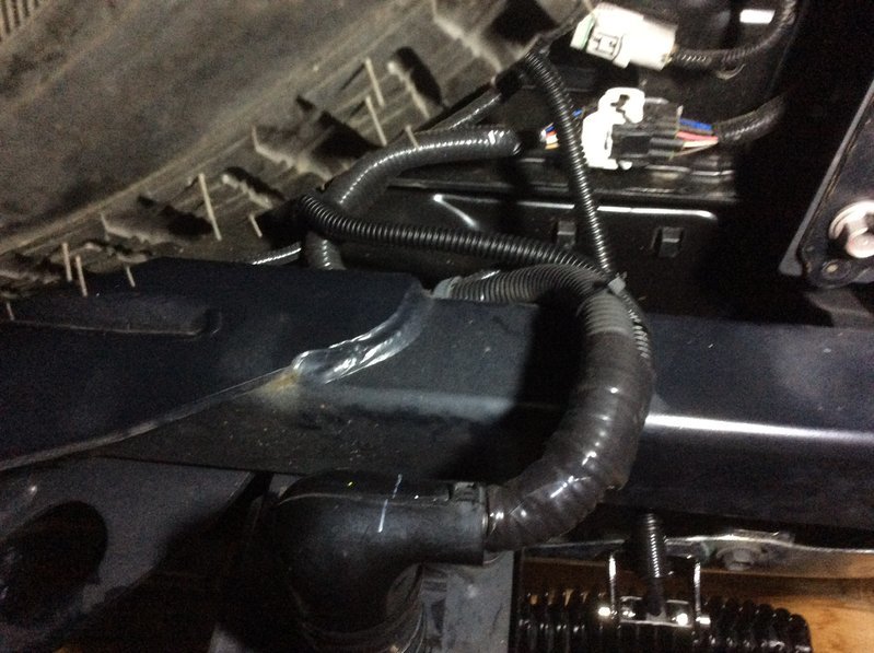

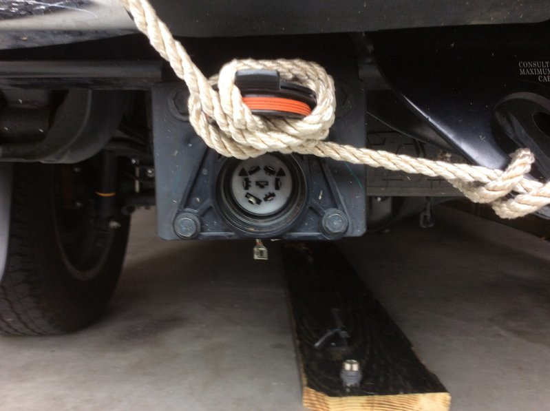

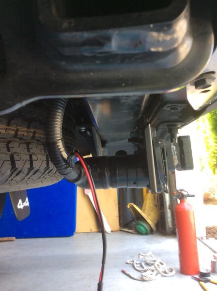

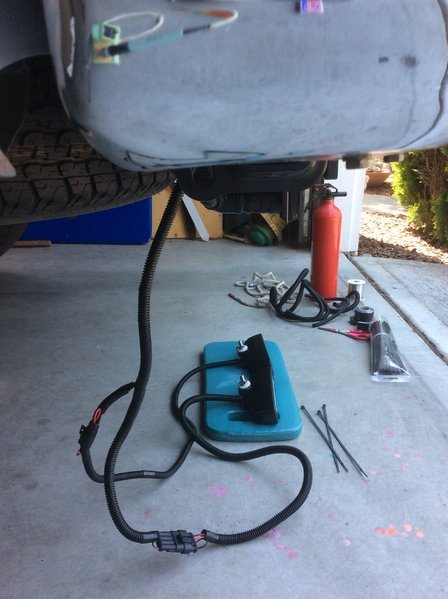

    I just added auxiliary reverse lights as well as changed out the reverse lamps from 921 halogens (I think) to LEDs today. I ended up wiring into the 7-pin trailer socket. I wish the 7-pin trailer socket used screw terminals instead of crimp terminals since it was a pain to get the ground and reverse wires out of the trailer socket. In hindsight I should have just replaced the trailer socket. That would have saved me an hour plus of frustration. The factory trailer back-up circuit goes through a relay and fuse so no need to add either one. The 7-pin trailer reverse signal activates at the same time the tail lamp reverse lights do. Maybe in the future I'll move the auxiliary backup LED lights to a separate switch instead.
    Here are some photos of my install. I soldered and heat shrunk (adhesive lined) each solder joint then wrapped all wiring with split loom. Self-fusing silicon tape was applied where needed. I also used water resilient connectors (I would have use two terminals ones but four terminal ones were what I had laying around). The LED lights were listed at 18W but consume closer to 11W (~900mA @12Vdc) each based on my multimeter readings. Total install time was seven hours . . . Would have been closer to five hours if I just replaced the 7-pin trailer socket with one with screw terminals.
    Hopefully this helps someone out. I referenced a bunch of different threads to get ideas for this install.

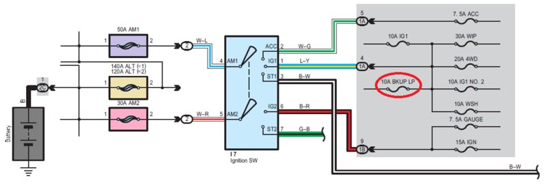

    I think you meant to say fuse...

    The stock/factory reverse signal on the trailer socket runs through a fuse and relay. I updated my original post. Good catch.

    Nope..no relay..just a fuse after the IGN switch.

    Are you sure there isn't a relay on another schematic page? Or perhaps it's different depending on the model year. I referenced wiring diagrams for a 2013. There is definitely a fuse and relay in the circuit.

    That is a 2013 info. There is a relay n fuse for the tow tails and battery charging. Only fuse for the reverse circuit.
