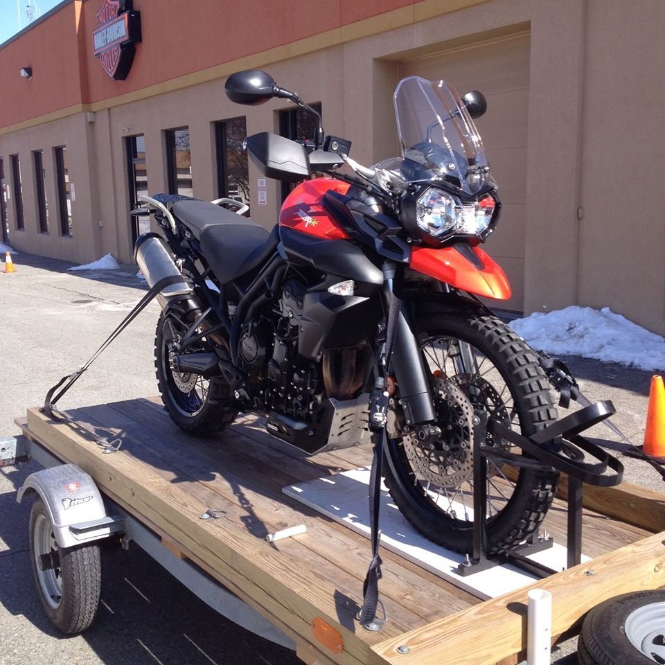

    I've been using 8x10 planks with the ramp end kit. http://www.amazon.com/Highland-0700...8&qid=1428594218&sr=8-1&keywords=ramp+end+kit
    If I had to do it over again, I'd get some decent quality bi-fold aluminum ramps or perhaps a single tri-fold ramp. Whatever you do, make sure the ramps are long enough so the pitch is at a minimum.
    Love my tie downs. Ratchet straps with snap hooks so no chance of slipping off.
    http://www.amazon.com/Keeper-05723-...2787&sr=8-2&keywords=motorcycle+ratchet+strap
    No damage to tailgate yet but always made me nervous.

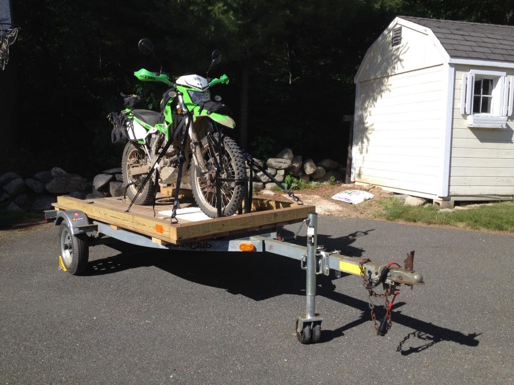

    Having said that, I got tired of filling my truck bed and went with a homemade utility trailer using a PWC trailer.
    B609C63F-AE55-45B4-BB71-6E8E436DBA82_zps_fce18a4baf4ce531c0b970011dad69280db092f7.jpg

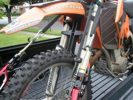

    I have a Box Bar secured to the bed with a backing plate for added support, the front tires cinch up to the wheel slots, no movement.
    Ready Ramp that doubles as a bed extender (no longer available).
    I use a fork support so I don't compress the suspension in all the way in.
    By the way truck is for sale.
    [​IMG][​IMG][​IMG][​IMG][​IMG][​IMG]

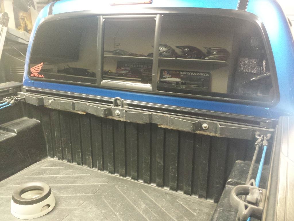

    A member here makes these tie down bars. I have one and it's perfect for having 1-2 bikes in the bed. Def an investment in properly securing your expensive motorcycle while transporting. As far a ramp get a folding aluminum ramp, lightweight and strong.
    Tacomatruckparts.com
