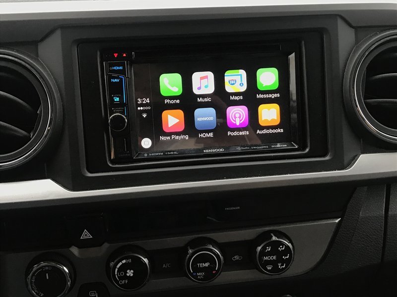

    My SR5 had the audio plus system (weak amp. And the scout app) so I replaced it with a Kenwood DNX-573s. It has CarPlay and built in Garmin nav. so that gives me 2 navigation options. I installed with adaptors and the idatalink maestro, from chruchfeild. I can still access OEM settings the original could, song info still displays on the multi-information display, and steering wheel controls work. Sometimes nav directions will show on the multi-information display and sometimes they won't. But I keep it on speed and fuel economy anyway. Dash mounted USB port hooks up with an adaptor too. I would do it again in a second. The DNX-773s is the same with a slightly larger screen and no volume knob. Hope that helps.
