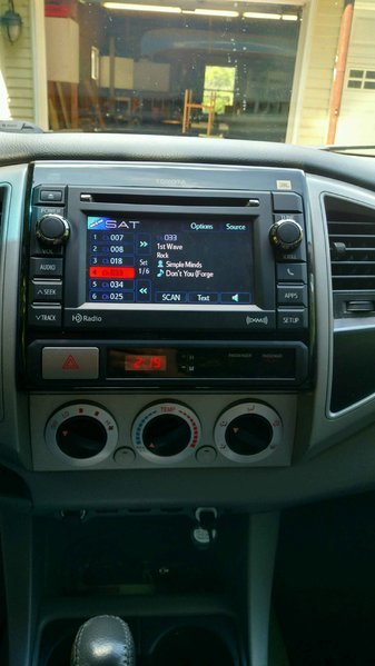

    anyone want to let me borrow their vin to make an account? PM me if you have a 2013 and are willing to let me make a myentune account. I don't believe I need the vin for anything else but to make the account.. once the account is made I can add the entune app to my phone then it should be bluetooth to the head unit?!
    old55guy.... I got the unit off this site in 2nd gen for sale. I got the cables by searching google... the metra came from Crutchfield and the PT546 from Ebay.
    here is a pic of it installed.... I verified the aux port works... note I only have a headphone jack aux port... the 2013 had a usb... that would be a new cable and adapter but easily done.
    I also verified that FM works.. not sure how well as I live in the boonies and reception stinks.... it probably stunk for the other unit. it does work though.
