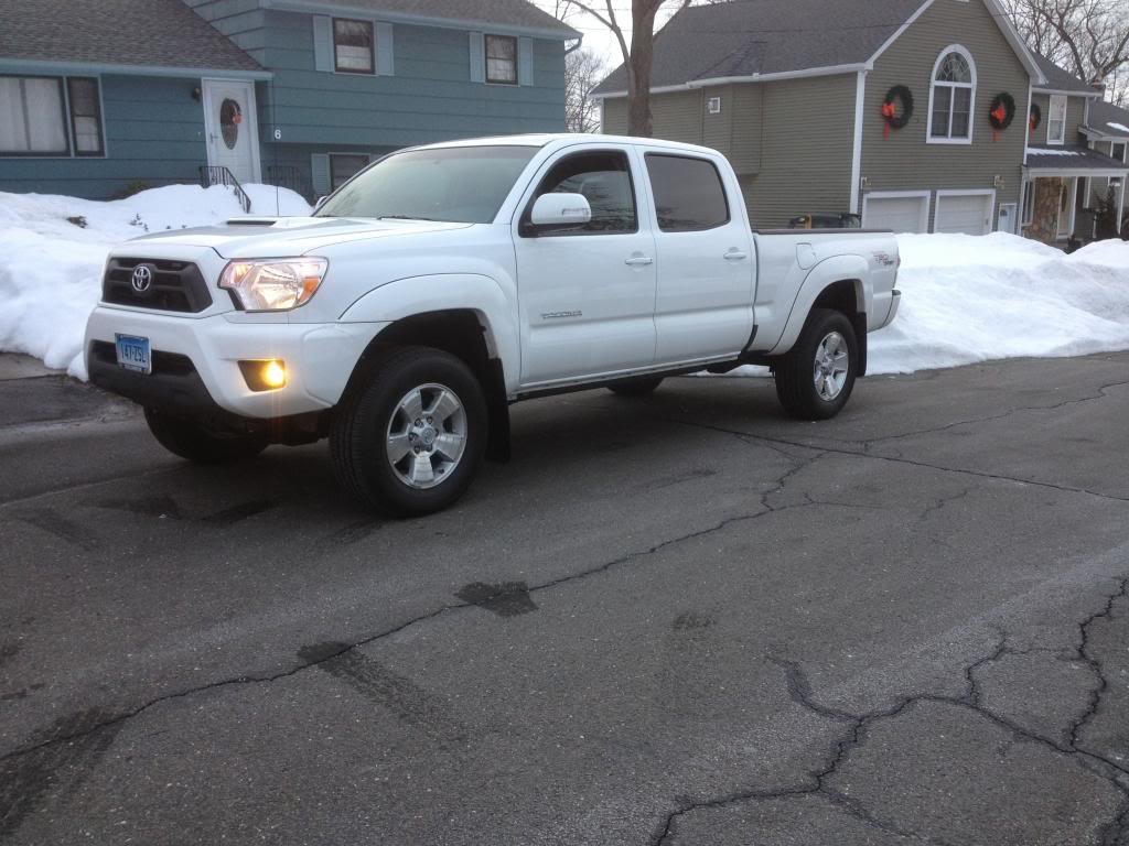

    loaded 2013 TRD sport
    I just installed 5100 , set front to 1.75 with 1" rear blocks.
    I love it , cant beat it for the cost.

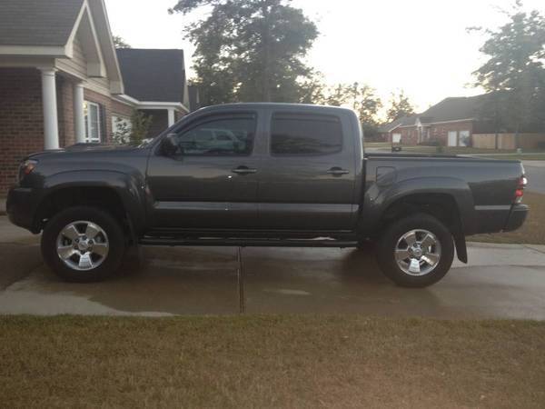

    2014 Tacoma TRD Sport Blue Ribbon Metallic
    LED Dome, LED Map, LED License Plate Bulbs, , Konig SixShooters Matte Black, Toyo Open Country ATII's 285 70 17, Satoshi, Bilstein 5100s (set to 0), 885s, LR UCA's, Icon RR 2.0 +2, All Pro Standard 3" Leaf Pack, All Pro Flip Kit, Sway Bar Relocate, Exhaust Chop, Antenna X 14", Debadged, Tint, Matt123 Black TRD Skid, Black Weathertech Mats
    Billies @ 1.75" and 2" rear block ride is much better than stock shocks. Yes an AAL will raise it as well and make the ride a little stiffer. Upgrading to the 5100's should help too.
    That's completely up to you if you wanna raise the rear or lower the front. My front end is 1" lower than my rear at the moment, but I like the look.
