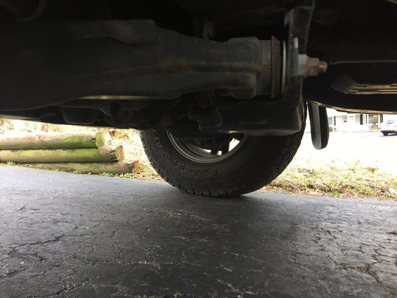

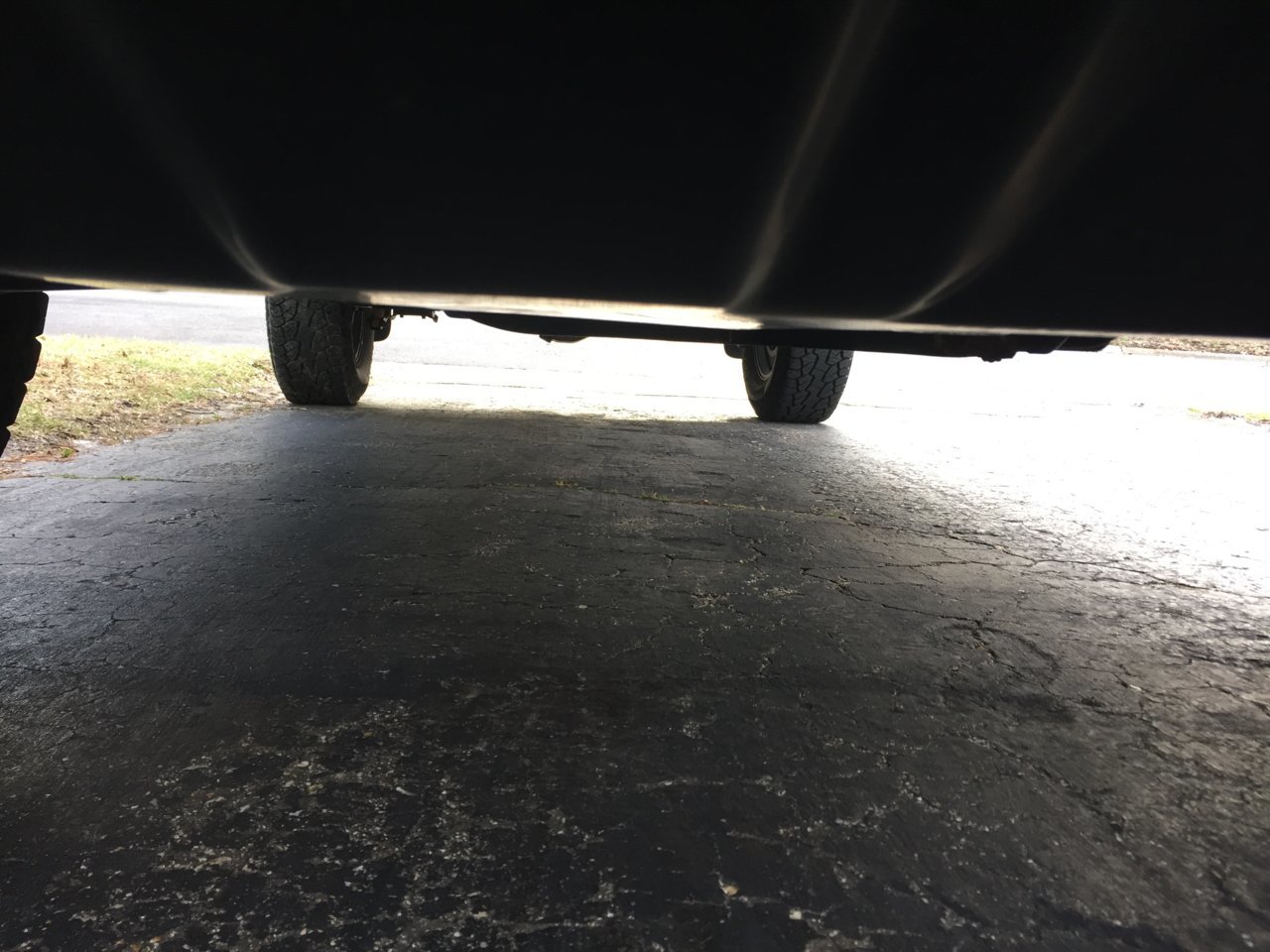

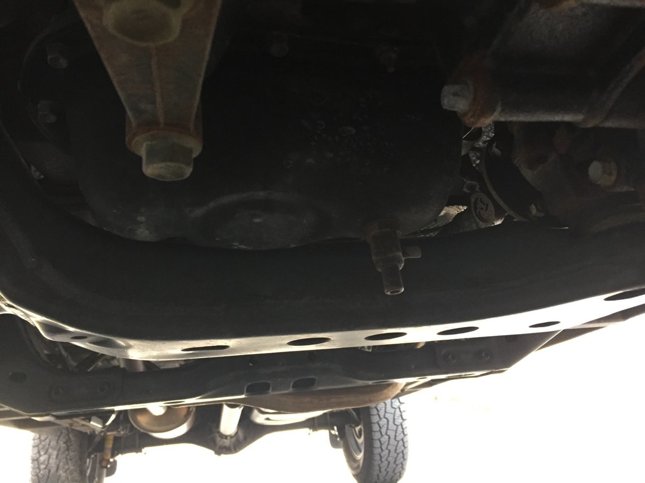

    Oh, another thing. Here’s pics of my truck, with one of those “cute” valves on it. It’s tucked up. Skid plate and cross member are protecting it. The oil filter is more exposed/lower than the valve.
