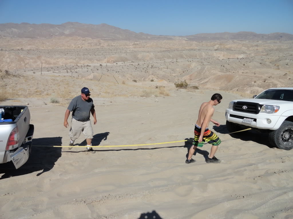

    Both will work but with a snatch strap you can get a running start and it will stretch like a rubber band to help pull you out of mud, sand or snow. A tow strap you want to have tight when you pull because it won't stretch like a snatch.

    Thought I would elaborate...
    Snatch straps allow a lighter vehicle to pull out a heavier vehicle via momentum/inertia. A tow strap relies on horsepower and tire grip. You take the slack out and then pull with a tow strap(to avoid parting it), you get a running start with the snatch strap before the slack comes out.
