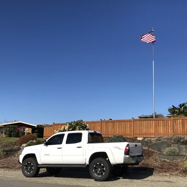

    Ok so how do I tell if I have a lift or level? My truck was bought this way and nobody I know can tell the difference. I'm looking to upgrade as well but have no idea what I'm doing, and not afraid to admit it.

    Idk what I'm supposed to be taking pictures of really... but here are some IMG_0480.jpgIMG_0482.jpg IMG_0485.jpg

    Didn't see your pics earlier...it looks stock to me.
