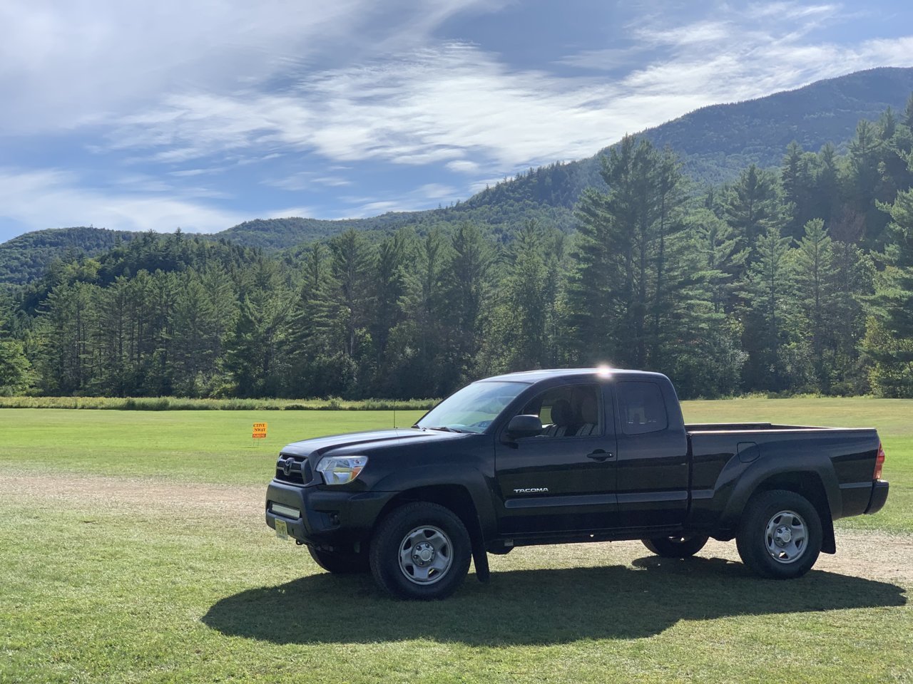

    This is 3rd gen suspension with 1/4” front spacer and 1.5” progressive AAL. If I were to do it again I’d go with a 1/2” spacer up front

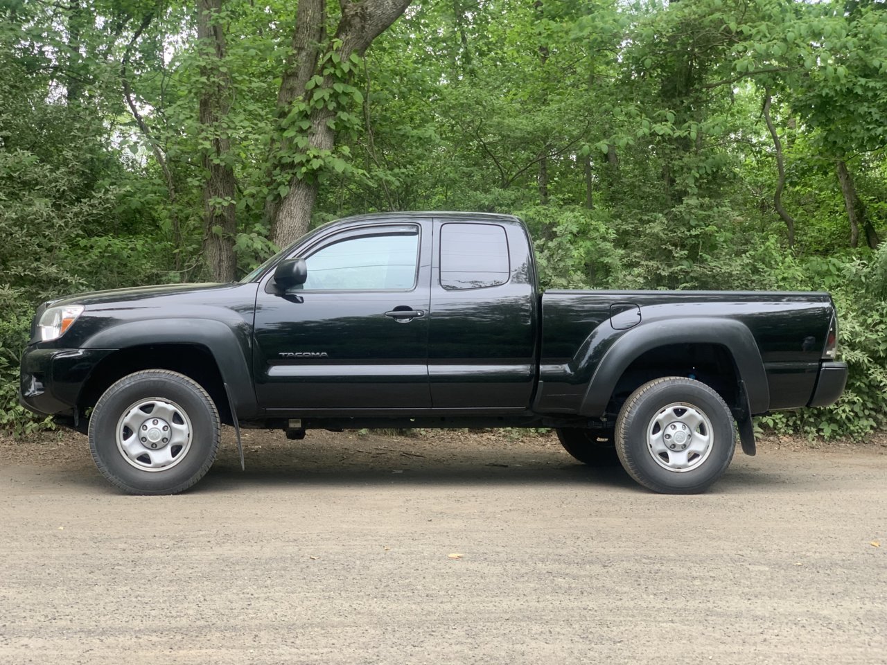

    '13 5 lug AC w/convenience package
    A few OE parts from fancy trucks
    3rd gen low mile front coilovers.
    You might decide this is enough.
    No shock creates lift. Springs set ride height, shocks control oscillation.
    More than 2-2.5" starts to create more expense and potential wear issues.
