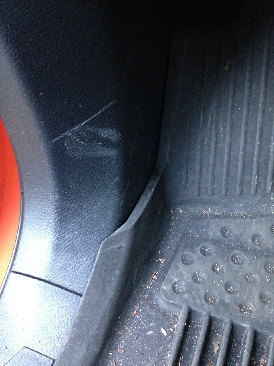

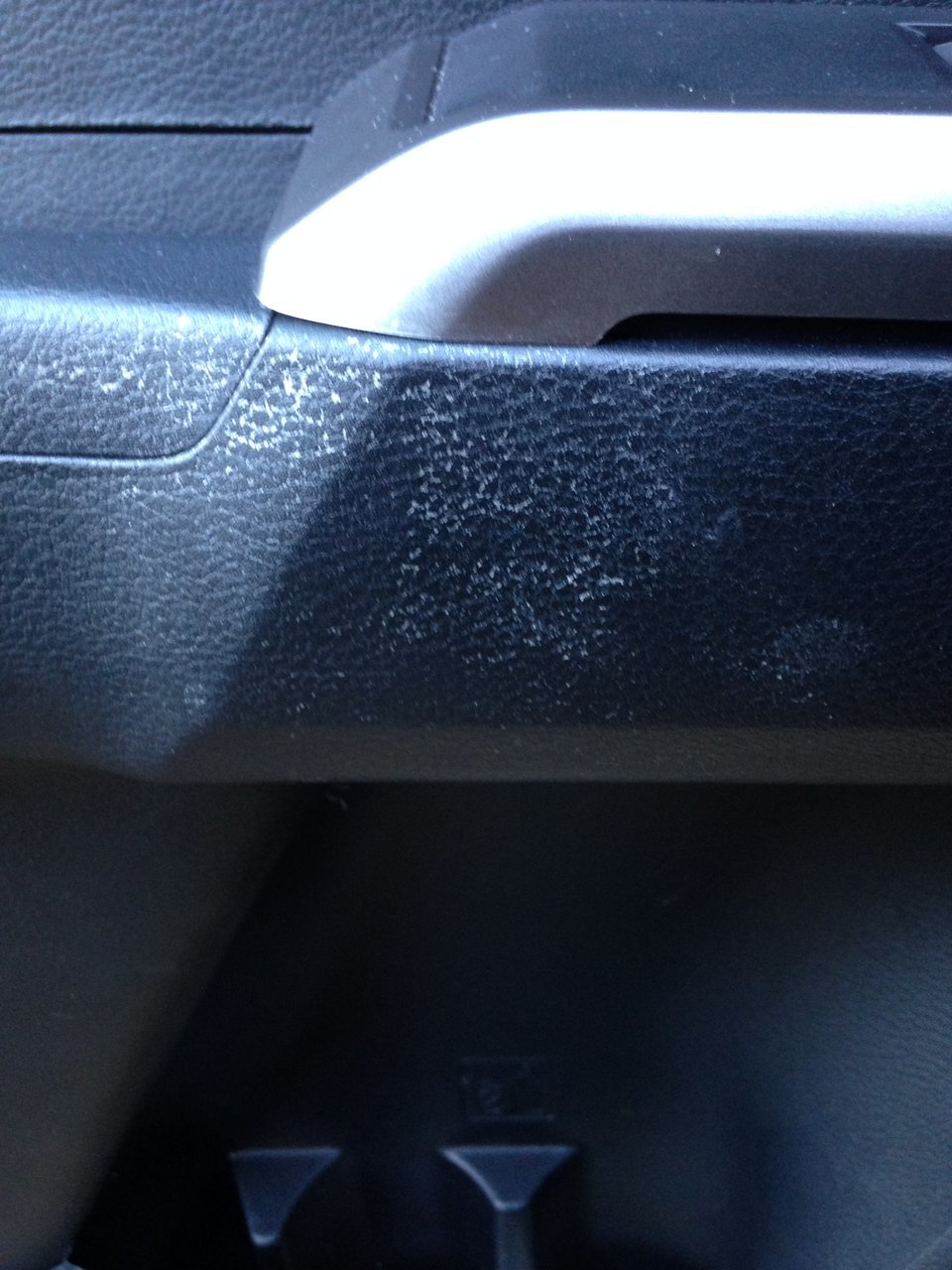

    I think I figured out an easy solution for scuff marks:
    BEFORE:
    AFTER:
    BEFORE:
    AFTER:
    I just used WD-40.
    Spray it on a paper towel and then rub the area. Then go back over with a dry towel.
    It removes scuff marks AND provides a nice air freshening scent.
    Seems to work like charm. Easy peasy.
    Let me know if this is a bad idea...
    BTW it works perfectly on the speaker areas without slopping fluid in the holes.

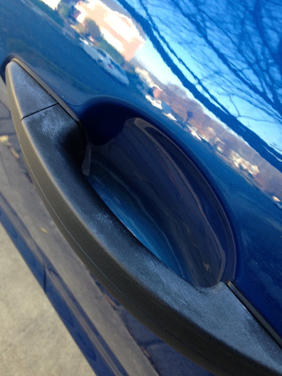

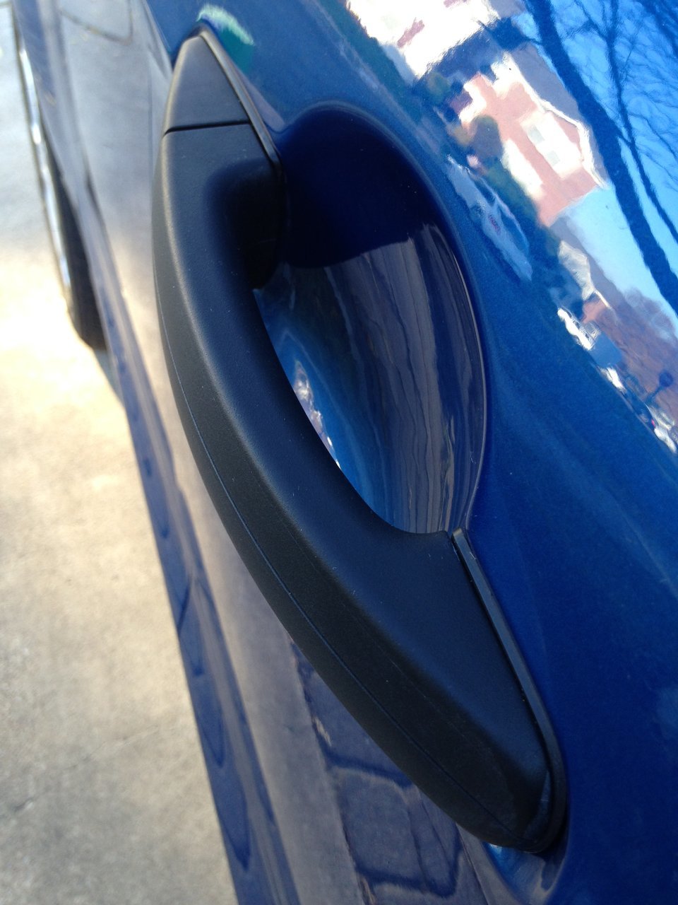

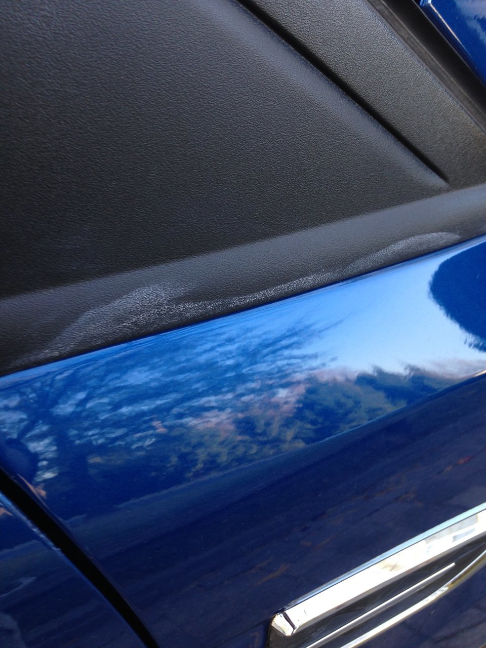

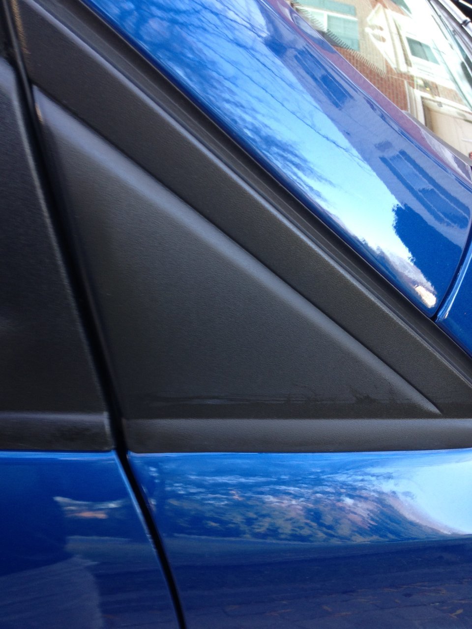

    I attacked my wife's Ford Escape today with WD-40. Her car has alot of black plastic on the exterior and I always get wax on it when waxing. Here's the results:
    BEFORE:
    AFTER:
    DOOR HANDLE BEFORE:
    DOOR HANDLE AFTER:
    So it looks like WD-40 is handy dandy on interior plastic trim and exterior plastic trim. Just a little bitty spray on a paper towel goes along way.

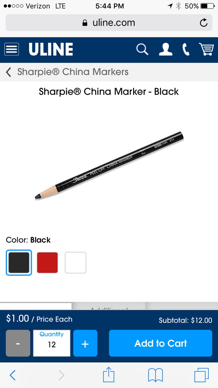

    Dealerships use a China marker and a carpet square. Completely removes them. :thumbsup:
    Scrub the area with the carpet square after using the China marker on it
  19. Nov 29, 2017 at 2:24 PM
    #19
    InfernoTonka
    InfernoTonka [OP] Infernal Order of Knights Templar of Inferno-ness
    Dec 14, 2016
    #204889
    2,664
    TOD aka Toyota Onroad Development
    2016 Inferno SAF base model SR5 4x4
    Is a China marker like a grease/crayon pencil? This is good to know.
    PvilleJohn[QUOTED] likes this.
  20. Nov 29, 2017 at 2:45 PM
    #20
    PvilleJohn
    PvilleJohn SVT Raptor
    Aug 10, 2015
    #161469
    5,344
    John
    Powdersville SC
    SVT Raptor
    Yeah they have them in different colors. I think they're also called wax pencils.
