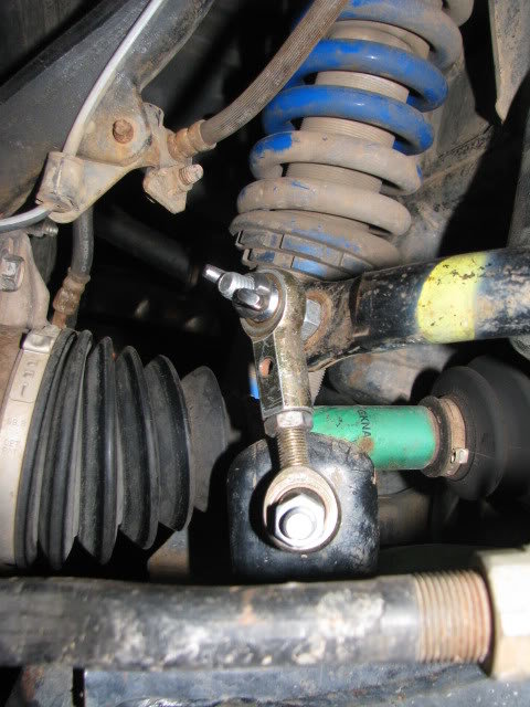

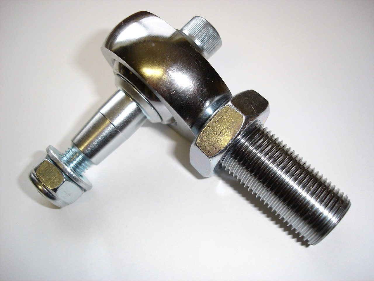

    Here are a few ideas I’m making mine from:

    How often does that need to happen? Just do like they do with cats and other emissions stuff here in Cali, bolt it back on, clear your codes, and have it smoged. Then go home and remove it all again. Once every couple of years isn't that big a deal.
    FWIW, when I got my Kings, I removed my swaybar entirely. I was hesitant to remove it when it was my daily driver, but honestly I'm not that concerned about it. It drives just fine. I do drive it a bit more timidly, knowing it doesn't have a sb, though.
    The problem with the dissconnects is once you disconnect them, now you have these pieces (not just the swaybar itself, but the links, too) flopping around unless you bungee them down or something, which, IMO, is kinda hoaky. So you'd need a clean, and strong way to keep the dangley bits in check, too.
