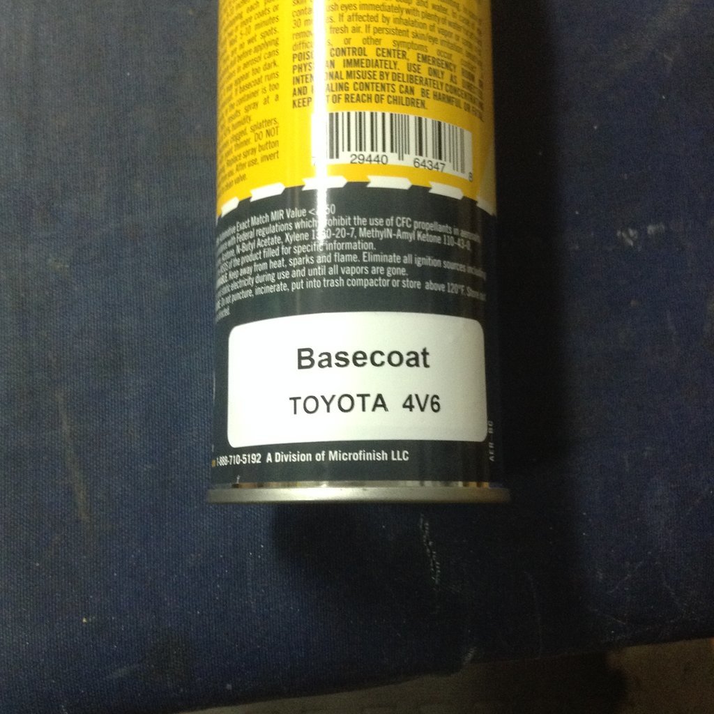

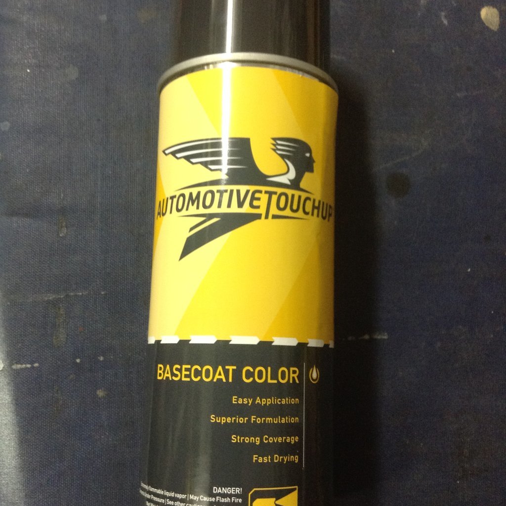

    Here's the paint I use.

    I just got the same stuff for a color matching project. Are you using the clear too?

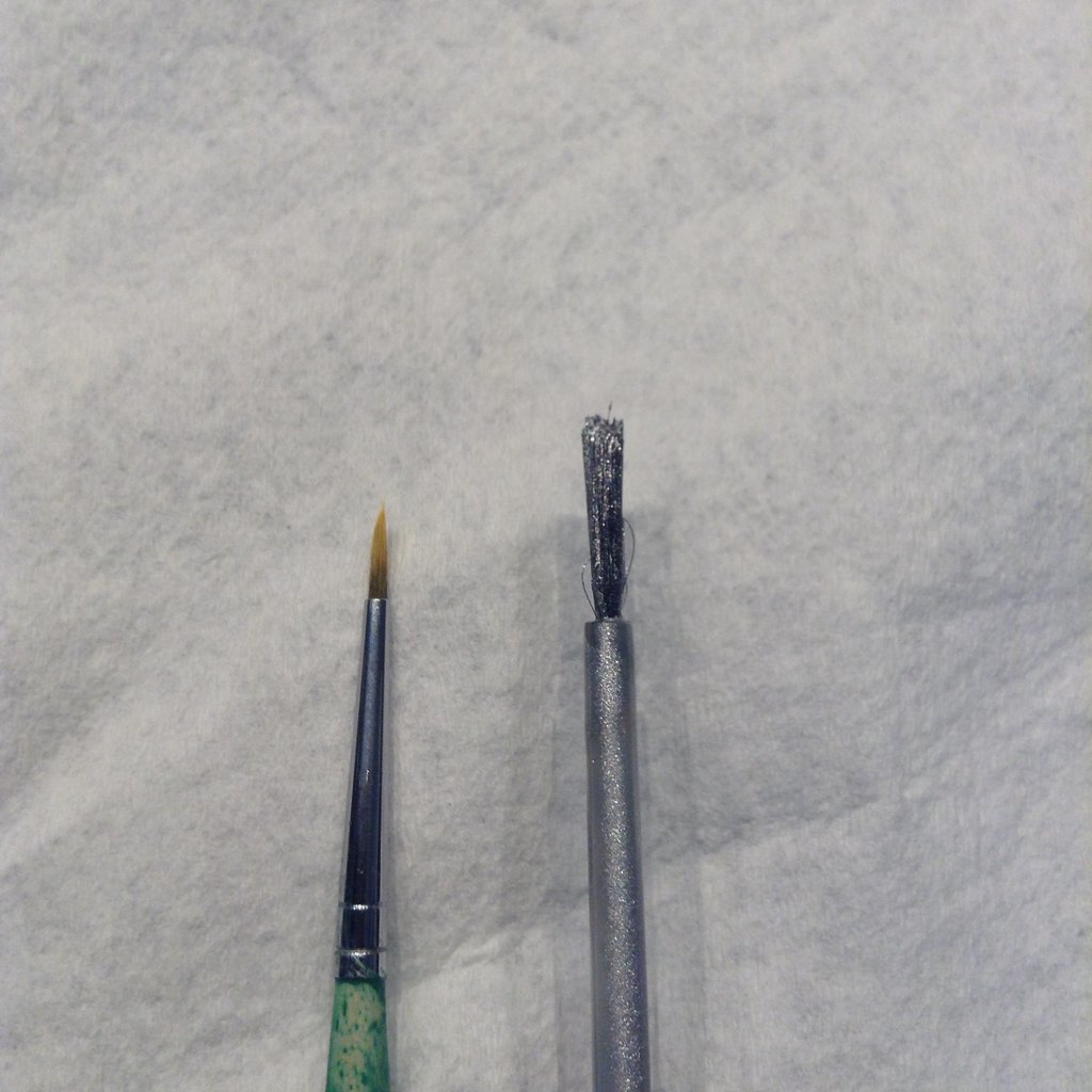

    For small chips I spray a small amount of paint on a piece of plastic and use a fine tipped hobby brush. The brushes on the touch up tubes are huge compared to the one I use.
