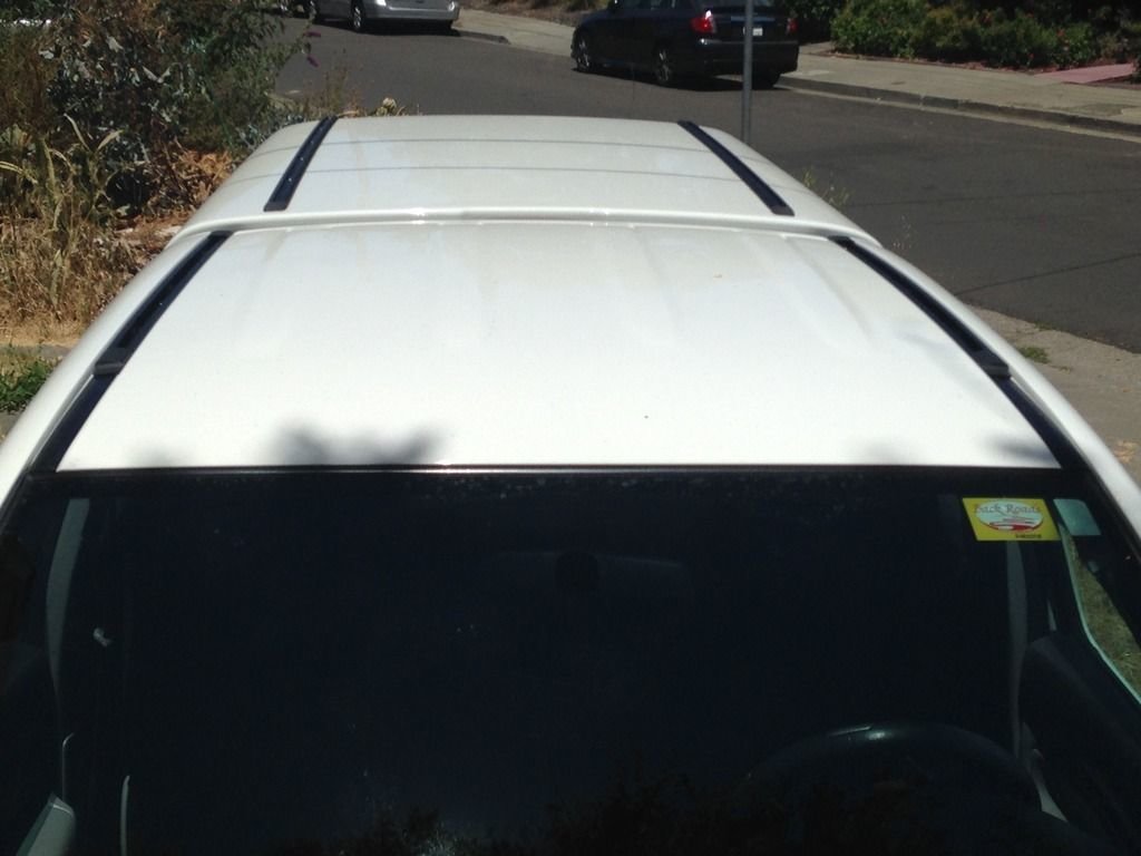

    Previously, based on what I’ve found online, I’m lead to believe you can’t mount a roof rack on an access cab but I just saw one drive by with a Yakima Rack somehow attached. Anyone have any info on putting a rack on an access cab??

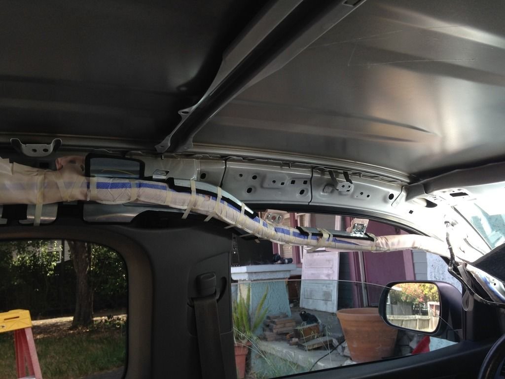

    Double cabs have nuts welded under the ditch channels but neither the regular cabs or access cab ps do. I pulled the headliner on mine and just used washers, nyloc nuts and caulk in holes that I located and drilled. Once the headliner was out I decided it would be safer to loosen the air curtains for more room.

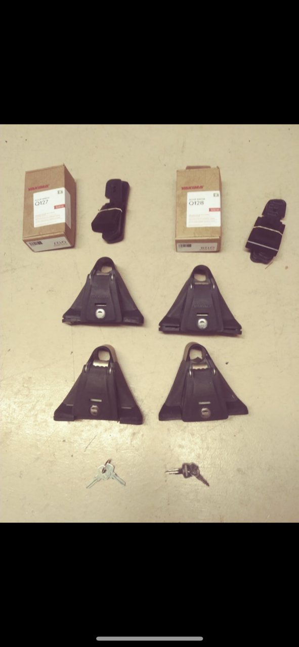

    I didn’t want to drill, so I went the q-tower route. I pieced my set together for about $100.

    do you have a parts list?
    i see 127 and 128. do i need 2 different ones also, how long are the racks and faring

    0238539C-145C-4443-8E85-B510F01FF385_zps_45f0a71ff31de1899e2fafbbe0640cce1aea95e1.jpg
    Drilling holes doesn't intimidate me, I know how to seal them. Where to drill was another question, here it's is with the headliner dropped and the air curtain loosened.

    That picture really reminds me how badly I need to drop my headliner and put some dampener material and insulation up there.
