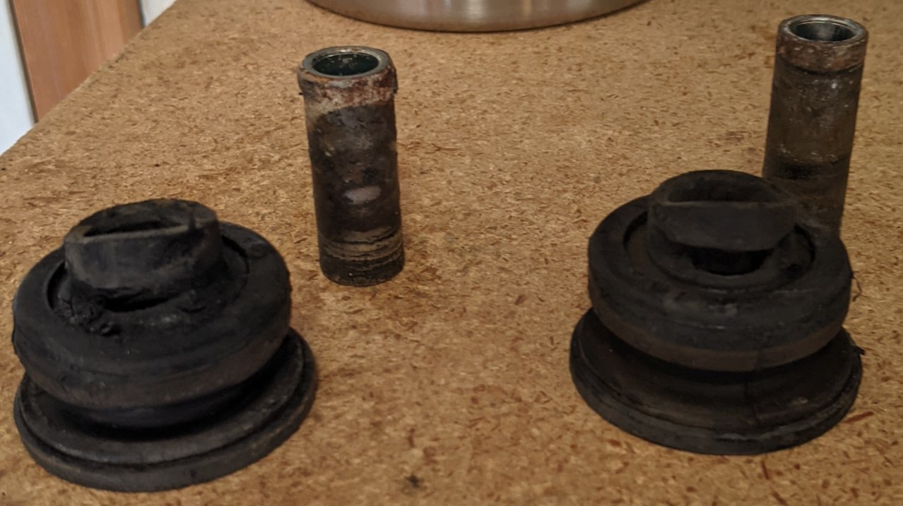

    2020 Trd off-road. 1000 miles same noise. Took it by the dealer and service guy said it was a bumper mount? They ordered a part and it will be installed next week. I would imagine the part he is calling a bumper mount is the front body mount. But I’ll know next week.

    2 Months old TRD off road, less than 2k miles truck squeaking. I thought it was the suspension but thanks to this post I verified issue and had dealer fix it. I first did some troubleshooting hoping it was an early fix. So when I took it to dealer I showed them the video and they confirmed it and replaced both left and right body mounts. https://youtu.be/VdRRl-JpTQc

    Having this issue on my 2021 with 4800 miles. I thought it was the UCA bushings but after researching and reading this thread I would bet it’s the bumper mounts.

    or just pull the bolt and lube it with some white lithium grease or NGLI #2 and that rubber will last a long time

    I wish that was a fix, but given the time that it takes to get access, folks might as well swap the parts. Mine was making noise from about 30k. I finally swapped them at 50k.
    If folks are sticking with Toyota parts, I would say to bath them in grease like you are saying. It might help keep the frame from cutting the sleeves?
