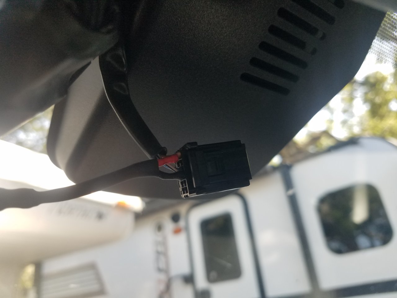

    I'll be using the Escort X-50, so I purchased this kit. Parent company here. Official instructions are here.
    Here's how my install went if anyone is interested. @kasberry gave me this idea over in my garage door opener thread. :hattip:

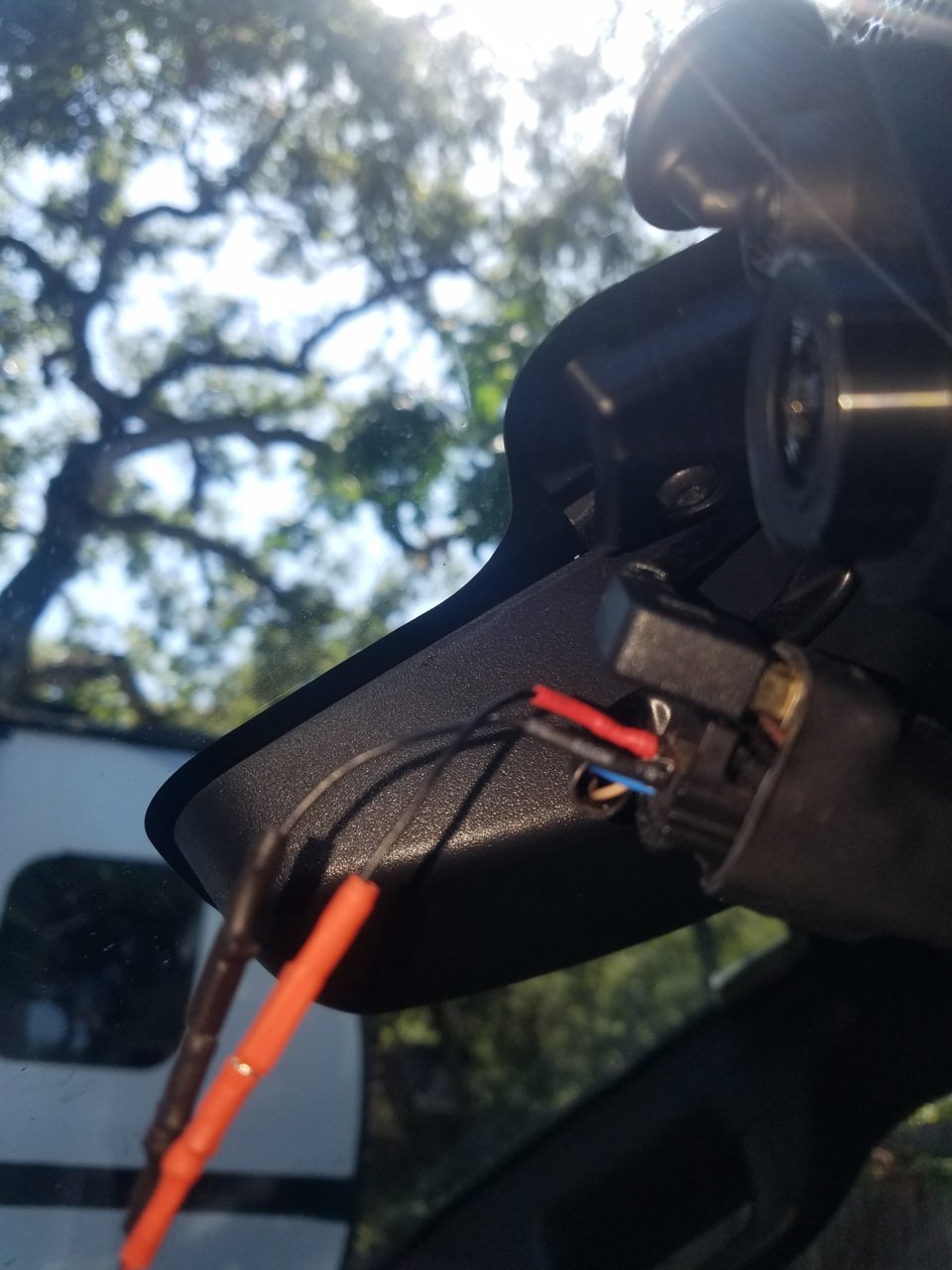

    The mirror tap plugs into the back of the mirror plug using "pins". The Tacoma Smart Mirror requires the supplied "smaller" pins:
    Here's how the smaller pins look shrink-wrapped to the cord:
    The pins plug into the beige (positive) and black/white wire (negative). Confirmed with @caribe makaira :thumbsup::

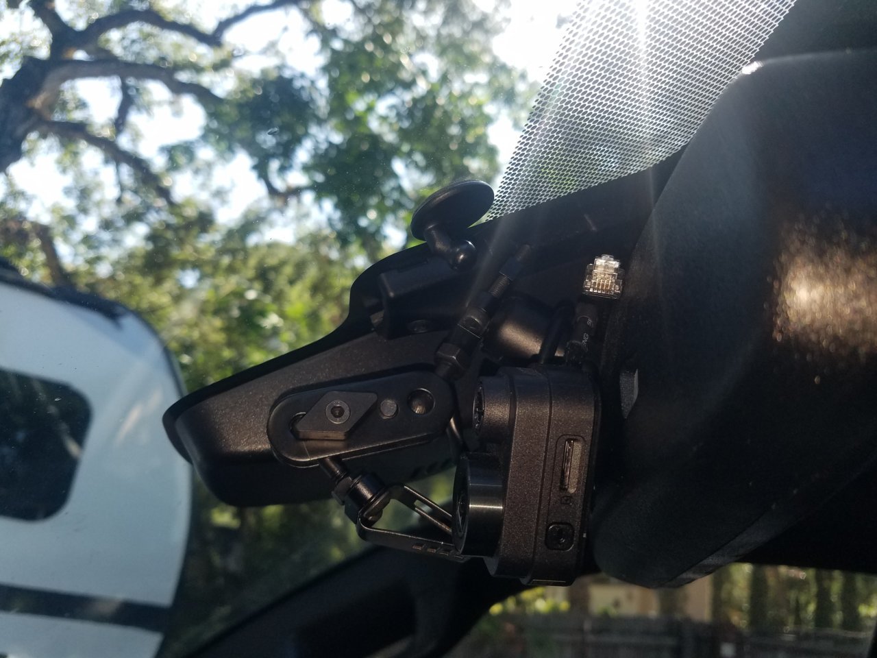

    I have the Mini 2 dashcam with the dongar tech USP adaptor, so it ended up looking like this:
    The Mirror Mount bolts up to the mirror arm pushed as far forward as possible. Attach the correct mounting point for the radar detector:
    Here's how everything looked buttoned up:
