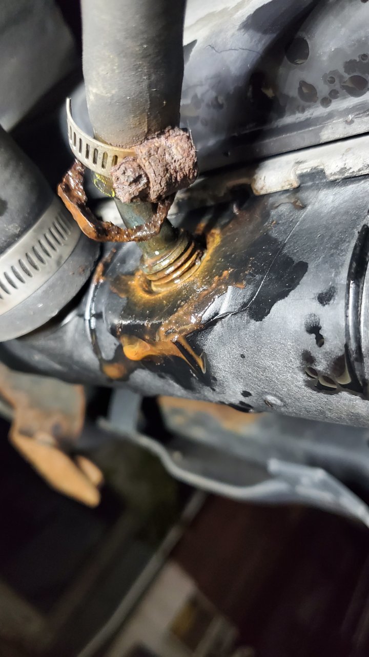

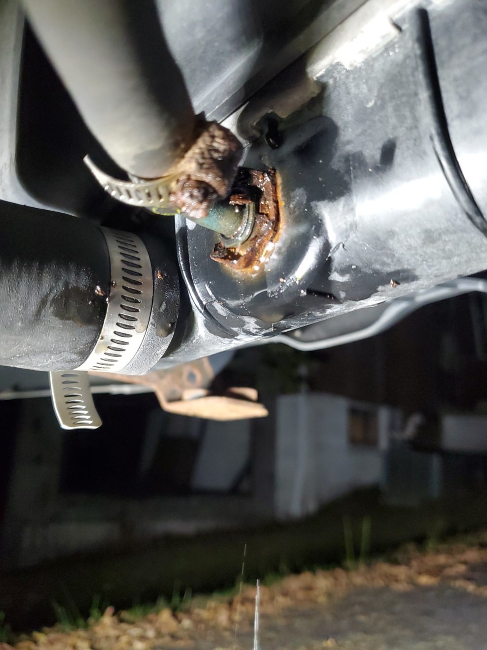

    So after 19.5 years my radiator has spring a leak. not in the usual place but where the A/T line attaches to the bottom of the radiator. rust has it's downsides :|
    It appears to be a threaded connector that keeps the A/T tube and gasket tight so that the fluid does not leak from the bottom reservoir
    I've been looking by my TRD/Google Fu is not strong on this.
    Can anyone locate a replacement "nut" so I don't have to replace the entire radiator?
    it seems like this is not a "push" fitting at the entire tube can move in an out (unless I'm wrong)
    pic for reference

    There's an internal cooler for the ATF. Highly doubt you can re-tighten that fitting to prevent the leak. It's a chance you're taking imo. Especially under pressure and heat.

    You could preemptively clean and jbweld the entire surface if you're worried...then go get a stainless worm clamp
    Something tells me you'd need access to the internal race of the rad to change that nut

    You got your moneys worth spring for a New radiator. The cost to repair that one would cost more doing it the correct way.
    Install a independent Transmission Cooler and Call it good!

    There's a rubber seal on the internal part of the cooler, the nut holds it tight against the plastic end-tank so it will seal.
    Just replace the radiator. I get being frugal but you got 20 years out of it, the truck is worth it.

    so after looking at it (I may tear it apart after removing) it seems the "nut" is actually part of the trans cooler tube. the outer nut must have rusted off years ago and I never noticed (judging by the new rad)
    I was able to find a Denso for <150 so yeah just going to replace.
