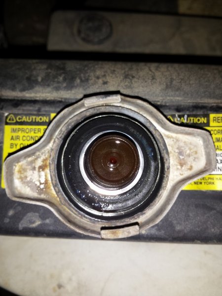

    This, and every cooling system tester I've used, will have a gasket like the one that goes on the cap to test the system. The adapter on the top right is used for the cap and that one needs a good gasket to seal otherwise it will leak as already stated. It could be that your new tester is defective, wouldn't be the first time.

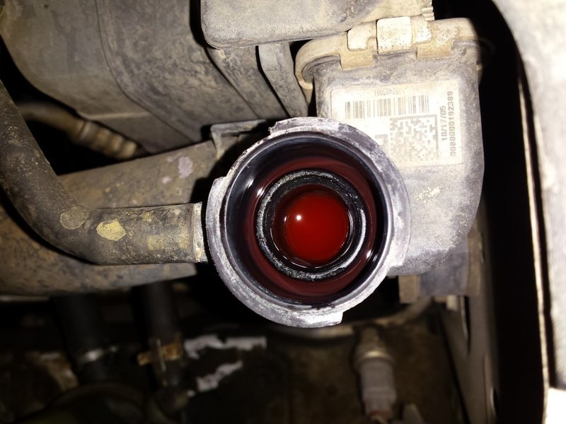

    I just updated the OP and attached a picture of my rad opening, which I'm suspecting of missing the top plastic contact surface.
    Perhaps it would be helpful if one of you could post a picture of your healthy one for comparison.

    You have a gasket that seals the smaller inner surface which is spring loaded to allow excess to drain into the overflow tank and an outer gasket that seals the radiator and allows it to build pressure.

    Is that red outer ring (that's in between the two black rings) a gasket or spillover coolant ? I'm asking cause it's the same color as the coolant in the bulls eye.
    If that's a gasket, it would be the one I am missing.

    No it's coolant. There are only gaskets on the cap.

    OK. So by looking at my picture, can you tell if anything is wrong with it ?

    The gasket is part of the cap. looking at the picture it appears that the ring in the radiator is either badly pitted or has a bunch of crap stuck to it so the cap or tester can not seal try a new cap and clean or smooth the surface in the radiator that it seals to.
