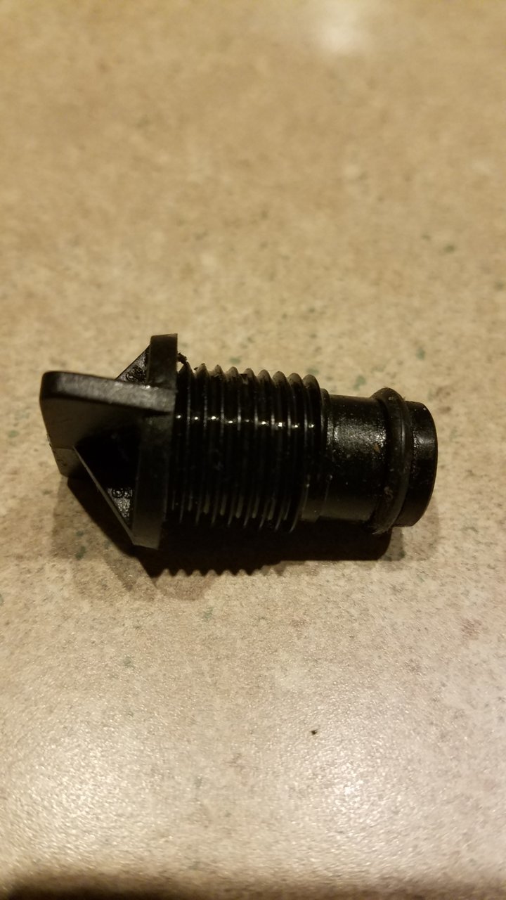

    I am in the process of replacing the radiator in one of my 1995.5 trucks. Here is a pic of the OEM drain plug. Is it possible that the oring was missing off of the plug in yours?

    It was the o ring, when I removed the screw the o ring got pushed into the bucket without my knowledge, and it’s definitely an aftermarket radiator. Thank yall
