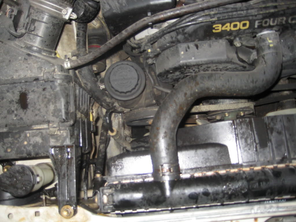

    Hey guys,
    I popped my hood open in preparation for an oil change. As I opened it, I noticed there was radiator fluid getting ready to drip down the hood. I looked at the reservoir and sure enough it was empty. I took off the radiator cap; empty. I can see signs of radiator fluid splattered throughout the engine compartment, mainly behind the hose connecting the radiator to the engine. I don't see any cracks on the radiator nor do I see any tears in the hose. I haven't experienced any symptoms of over-heating and am completely blown away as to why this has happened.
    Pics to come shortly and I would really appreciate any help.

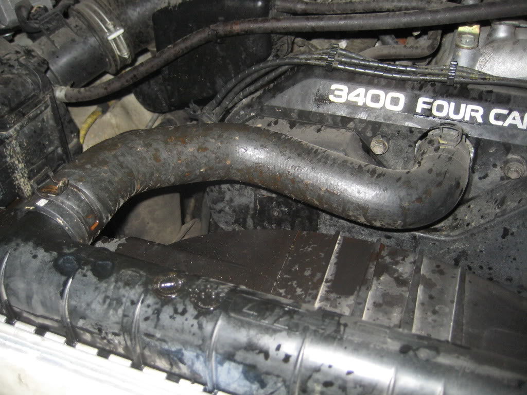

    My guess from that pattern is that your top hose clamp is weak and/or the hose is weak, it was spraying out (forward) and then being blown back by air coming through the grill/front of the truck. Those clamps are original, so they may be fatigued. Try a new top hose with new screw-type hose clamps and then observe.
    Also, hard to tell if that is the Toyota pink coolant or if it is really rusty. When is the last time the coolant was flushed and replaced? Or even the hoses repalced? Ever?

    To my knowledge, the hoses have not been replaced. It's been a while since I have changed the fluid; not exactly sure on how many miles ago...I know the last time radiator work was done, it was replaced with orange fluid - to answer the "rusty" question.
    Edit: Appreciate the tip...I'm really curious to find out if there is something wrong with the radiator now in order to replace it or have the system professionally flushed and get the OEM coolant back in there.
    Edit: I inspected the hose and clamp. It's on there tight.

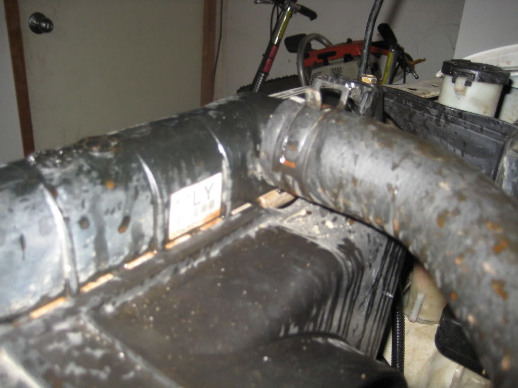

    The radiator upper and lower tank alum clamps might have failed, those see alot of heat cycles, and with age do flex and crack the plastic tanks.

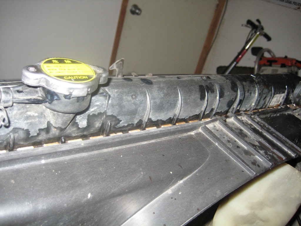

    In one of the pictures, I see 'wet' stains where the plastic meets the metal at the top. That would concern me and could be the problem. Over the years of the metal expanding/contracting - can cause failure to whatever it is that the fuse the two materials together with. My mother-in-laws Grand Cherokee had that same problem just last year.

    I think you are talking about the ridge where the fan shroud meets the radiator; I was somewhat concerned about that myself.
    I'll stop by the store and pick up some distilled water on my way home, clean off the spots, and run it in-garage. Thanks for all the help boys and girls.

    My bet is on the radiator. As stated above the seam where the top tank meets the fins looks to be the culprit.
