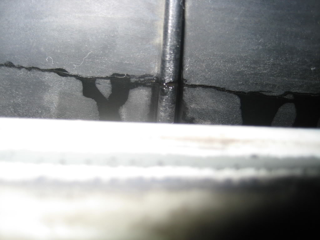

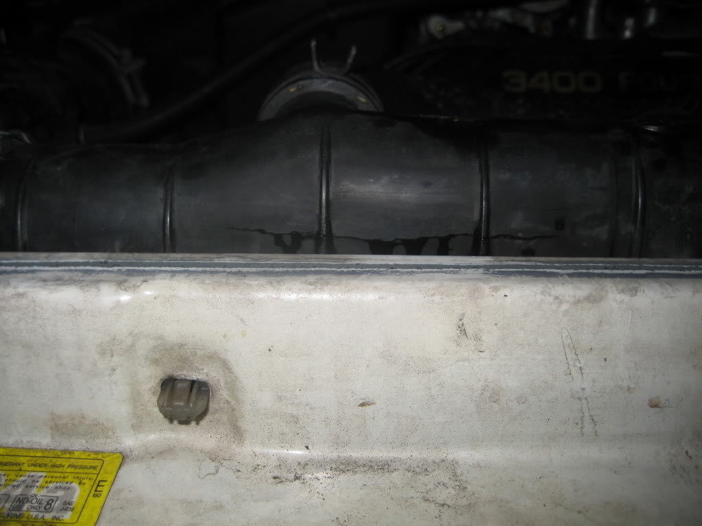

    Well, after messing around with it outside, the problem (assuming it's the only one) is quite obvious...you can even see it in the second picture I posted (counting from the top).
    My question now is which route do I take? I assume the best answer is to get a new radiator, radiator cap, thermostat, and hoses.
    I would like to hook up the engine to a pressurized machine and "flush" out all of the orange coolant/any debris? and replace it with the OEM pink fluid. Can this be done?

    Easy find, you got lucky. That crack wont epoxy, been there tried that, fwiw, to much heat flex.
    new cap also, along with hoses, clamps, radiator, coolant, ect.
    The Stant lev-r-vent caps are nice, all I buy. Easy to keep a eye on the level, without getting a mouthful/facefull.
    Good band clamps, if the parts store has them..
    http://www.turninconcepts.com/images/rad_clamp_3_big.jpg
    If you do a new thermostat, drill a 1/8" hole on the top side of the flanged piece (coolant has to touch the thermo flange in some spot, drill there). This will vent any trapped air in the block as you refill the system with coolant.
