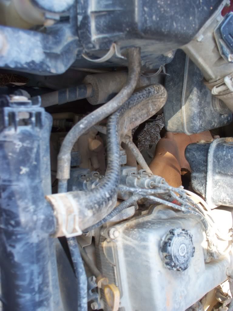

    what dose it mean when your radiator hose dose this?
    bad antifreeze?
    needs new hoses?
    what?
    its the only one that dose it

    May just need to be pulled off, cleaned, and attached with a better clamp. OR...It could have a small crack in the hose.

    also the radiator cap has some gunk around where the spring and seal are

    Clean it off. ;)

    The lower hose in my old talon did that. I read online that the cap usually causes this to happen. So i got a new one from the junkyard and changed the fluid and it never did it again.

    They are pretty inexpensive compared to a blown engine, I would replace the hose and the cap just to be on the safe side.

    Thats called the Monica Lewinzki! Change your rad cap.

    Could it be a thermostat problem?

    thats the output hose. the water is coming from that side of the motor. that side should have pressure. I would flush the system and see what happens.

    alright heres what im gonna do
    1 buy a new radiator cap
    2 buy (?) gallons of antifreeze
    and possibly a new hose
    anything else?

    Get Distilled water. or buy water made for this.
    Do not use tap water or filtered water.
    it has stuff in it that will rust your block out.
    I would asl get water wetter to add as well, but it is over kill.
