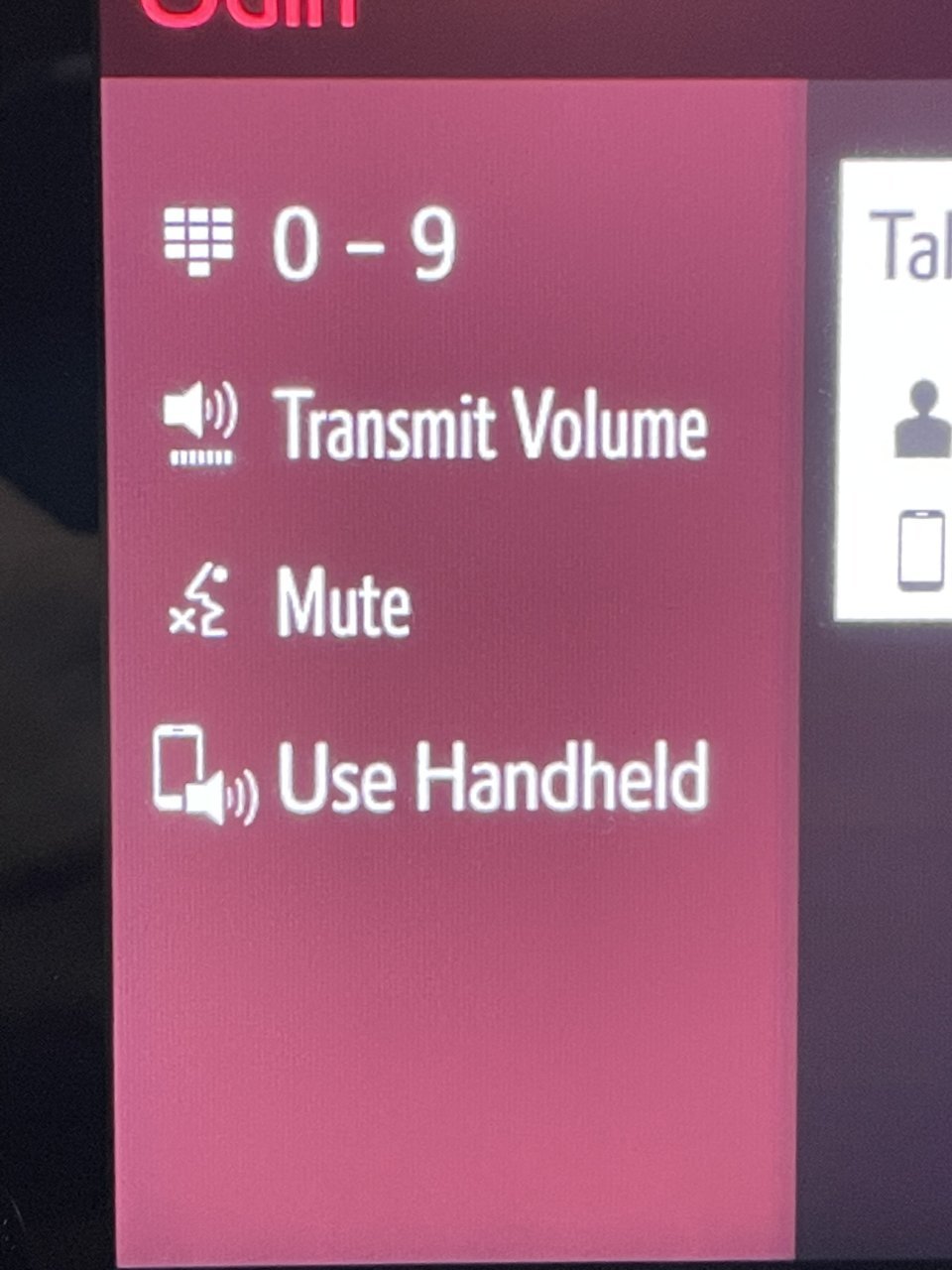

    I get the same issue. Although it is not a true fix, I simply turn down the ttransmit volume in settings and the buzz goes down to a minimum. Wife says she can barely hear it. Hope that helps.

    WHAT?!! @Jazc Man you get a gold star first post. After all the trouble everyone has gone through you pull out a quick win.
    Tried this quick and my wife said wow what did you do? The buzz is gone and I still hear you fine now. Just turned that transmit volume to the lowest setting.
    I never found that setting anywhere. It’s only accessible in an active phone call and I never noticed it. I didn’t even see it in Techstream.
    I assume Toyota has some bad amplifier feedback on some trucks? Really not sure what that setting does. My wife said she still heard me at the same volume, but the buzz died off each step down in the setting. Fixed it!

    #405224
    11
    Hello Gutentight...where is this setting?? I looked under all the menus while on a phone call and parked (truck running) and couldn't find it. It certainly sounds like the issue. Thank you!

    It’s only visible when on a call connected via Bluetooth. I have not yet checked how this behaves once connected through CarPlay after adjusting.

    As mentioned above, adjusting the Transmit Volume gets rid of the buzz on my truck...

    I turned that transmit volume all the way down & all the way up just so my wife could tell me if it got better or worse on her end & that was the case so I turned the transmit volume to the lowest setting but it still didn’t eliminate all of the buzz.
