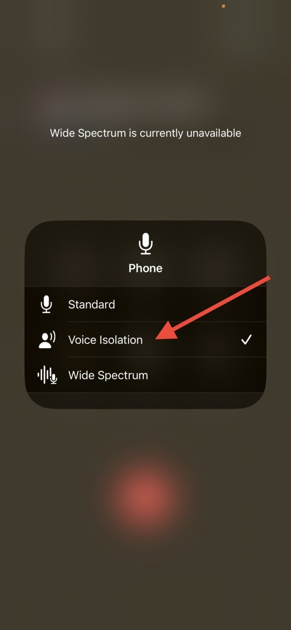

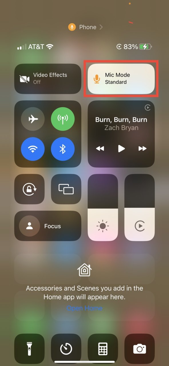

    Did u do the 2000. And save and turn off and then turn on again? Idk about the other values cuz i didnt try them. I dont know if it would make a difference but i waited like a minute before I made a phone call again.

    Yeah I tried 2000 the first time. It doesn’t change the audio quality for better or worse it’s exactly the same buzz sound. The isolation option instead of standard in the iPhone menu is still working for me. Are you running the truck with the engine on? That’s the only time the buzzing comes into play on mine

    Okay cool. I’ll give this a try. I still have the buzz when using CarPlay but was able to fix when I’m only using Bluetooth.

    Hey chief, sorry I'm Android gang so idk about carplay, but that above fixed it for me with Bluetooth only and android auto~

    That fix worked for me. Put my phone mic into isolation while on the call and my wife said the buzz was gone. Woohoo! Gotta love this forum. This always bothered me while on a call using CarPlay.

    I searched and specifically came here to post this exact same fix. It worked for me on my 23. Give it a try.

    I've been subscribed to this thread for awhile now and this is the first fix that worked. I was at the dealer the other day and they said that all of the Toyotas were like this and it was just the way it was.
    I'm so glad that this works!

    I am experiencing the same problem so the likely place for me to go to get the best answer or fix is on the Tacoma World forum, and as usual there it was "The Fix".
    After changing the setting the buzz is gone. OF course not being satisfied with having the problem solved I googled "voice isolation on Iphones and this it what I found out. Read the attched link for more info.
    Thanks again for sharing your knowledge .............. Joe
