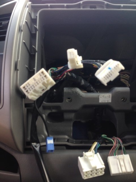

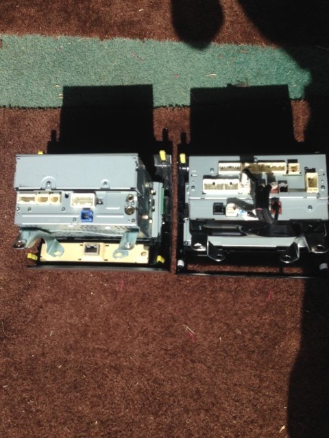

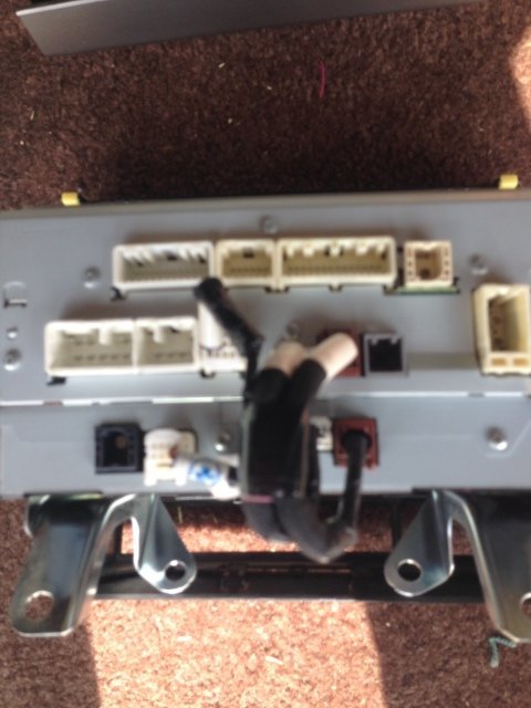

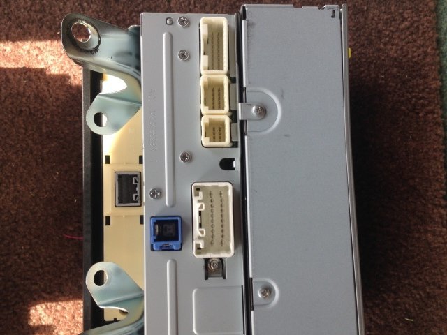

    i have a 2010 jbl unit and i want to put in a 2014 jbl nav unit, but i need help with plugs, different between 10 and 14. Any help or someone who might be able to help? 1. Plugs 2010
    2. 2010 unit 3. 2014 unit 4. side by side

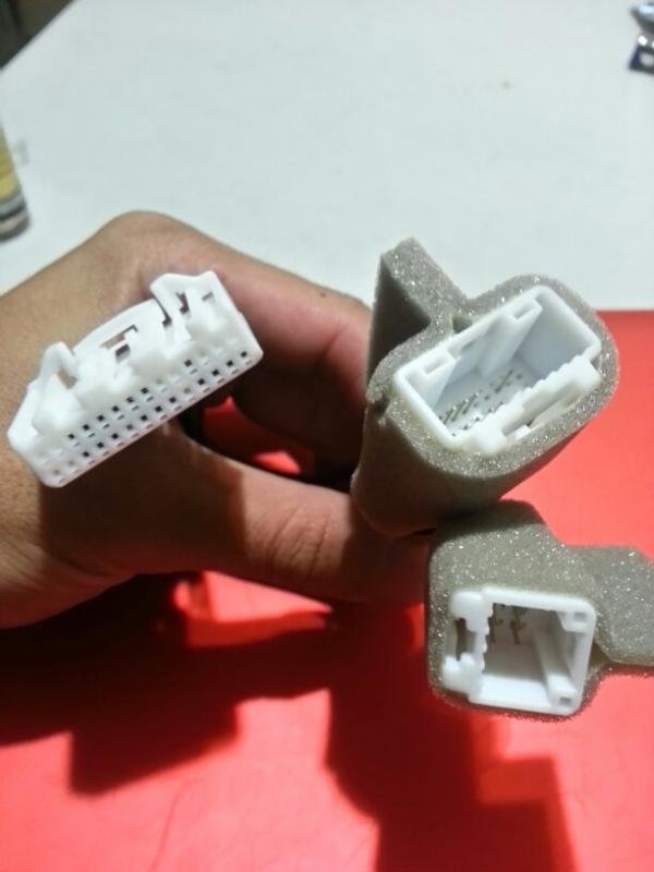

    i have the plug ! i use it on my 2012 that i did for the 2014 but pull it out right before my truck was a totally lost!
    you would need antenna convert and the harness convert which i have both it look like this
    that the radio harness
    the male connecter go to radio , top female is your stock radio harness and bottom female is bluetooth connector
    Hope that help you out !

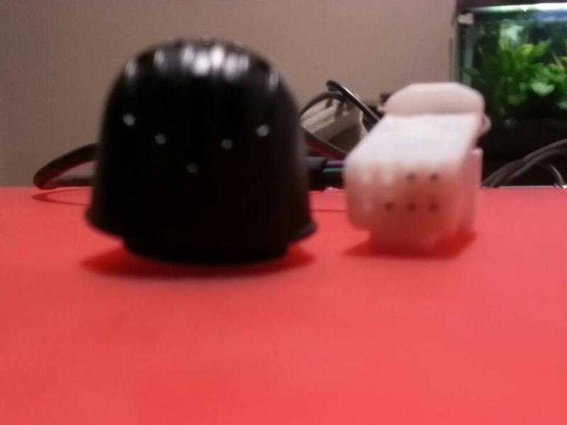

    this is the bluetooth thing you need if your car didn't come with bluetooth
    and i have the antenna converter if you need that too

    Thanks for the info but the plugs you show i all ready have what i neeeded was a metra 70-8113 to make a harness to connect from my radio harness to the 2014 radio. 2010 is single plug and 2014 is two plugs. got everythig just have to make harness and connect. Thanks again moonman50
