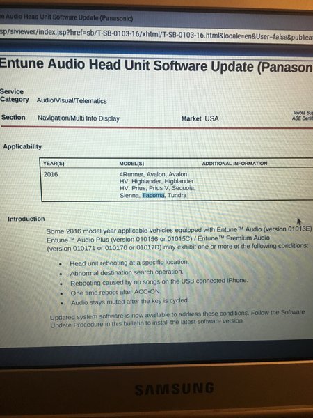

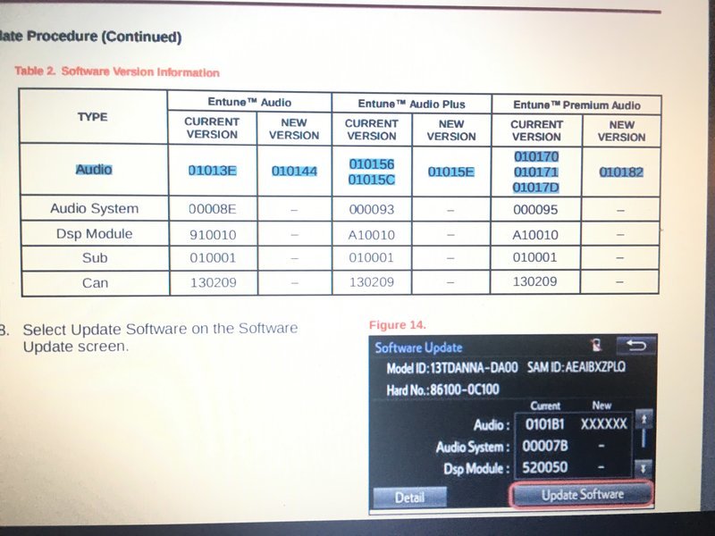

    Ok. I took it to my dealer this morning and this is what they said. They didn't look at it or anything. They said they had a bunch of them like that, Toyota had replaced a bunch of them across different models, and that there was not a software update for the 2016 Tacoma yet. He said it was the phone causing it, not the radio. He said that it loads every contact and item in the phone to the radio. Be it from instagram or facebook or your contacts, wherever. It then is overloaded or whatever.
    This goes back to my original thought that the thing doesn't have enough memory to handle the nav and entune. I still feel like the dealer was giving me the run around. I have emailed Toyota about it and will be calling them on Monday. I am beyond aggravated at this point.

    I think we're onto something. After leaving the dealership last week from getting radio looked at, I re-paired my phone over Bluetooth. When I paired my phone, it tried to upload over 3000 contacts. Thousands of these were just blank with the conference call number that we use at work. I suspect that somewhere my phone is storing the conference call number as a contact every time I dial it. Here are the steps I took to fix.
    1) Downloaded an app called CleanUp Duplicates from the app store.
    2) Ran software on phone.
    3) Went from over 3500 contacts down to 800 or so.
    4) Repaired phone with truck
    Knock on wood, it has not rebooted since. Will update if I run into problems.
    Thanks, Tex0322.
