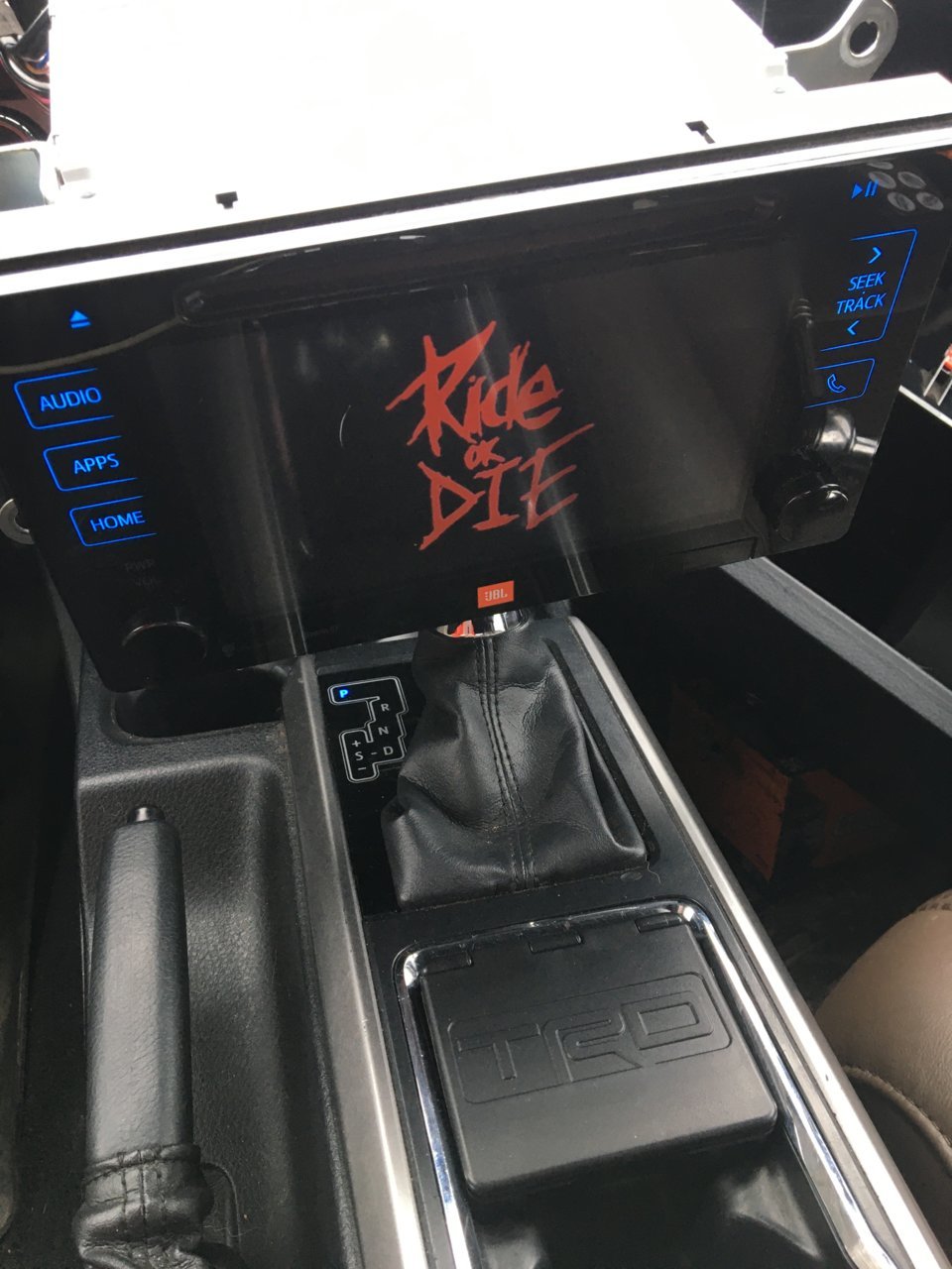

    this is also a good idea because yes the crux harness is difficult to remove, however I had the head unit completely removed yesterday, as well as the crux stuff and nothing changed.

    All right, first thing I’ll try is just plugging it back in.

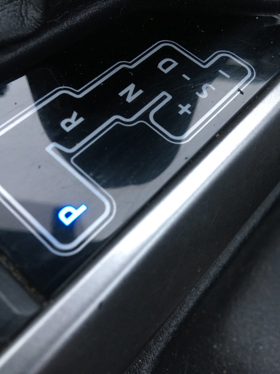

    So after 20 some hours of the battery disconnected I hooked it back up and received the same result. Pulled the rest of the dash and pulled off the start button, same result.
    There’s only 3 things I can tell that have power just by a visual inspection. The radio, the shift selector, and the anti theft which I believe is flashing normally as if the truck is turn off.

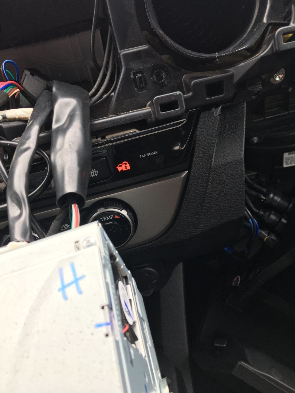

    yes sir, and I even remembered I got two relays installed for a power sliding rear window I haven’t installed yet. Power was all ready cut but I had them grounded off the OEM ground for the amp so removed it as well to be sure.
    I also have a power lock for the tail gate I installed myself, once again I uninstalled and followed the wires to be sure and inspected the factory wires around the area, nothing wrong there either.

    Just as likely a wire (or six) were fried during an install of something. They are incredibly thin wires. The first solution is to remove all non factory components and see if it still does it.
    edit; just seen your response.
    I would leave them uninstalled, then pull the lower dash and check for any melted wires. There is obviously something going on. Just yet to be seen if it’s warranty or caused by you. Not meaning to finger point, as there are several possibilities, but that’s where I would start. Check behind the radio too.
    I recently had a “thermal incident” as defined by Toyota. The dealer was happy enough with my wiring, and the fact that the burnt wires were no where near anything I connected to*, that nothing was on me.
    *fuse tap for switch power (to relays) and a tailgate lock.

    All right, so I didn’t get any where last night. Decided to take the truck to work this morning with no interior lol. Pulled in to park, shut it down and for a whole 1 Mississippi it was completely off and then the instrument cluster did it’s Tacoma intro and then went to a black screen, and then the light for the gear selector started to light up but very slowly and dimly at first for a couple seconds and then fully light up. Radio stayed off until I opened the door to get out and then it fired up.
    With that being the second thing to turn back on after shut down and the way it did it I almost think this is the first system I should check out today. It was probably trying to light up while the instrument cluster was doing it’s thing.
