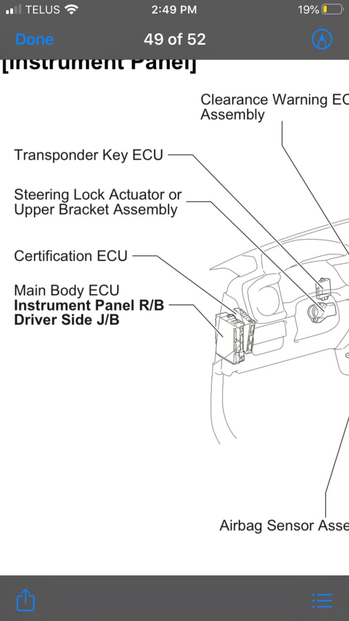

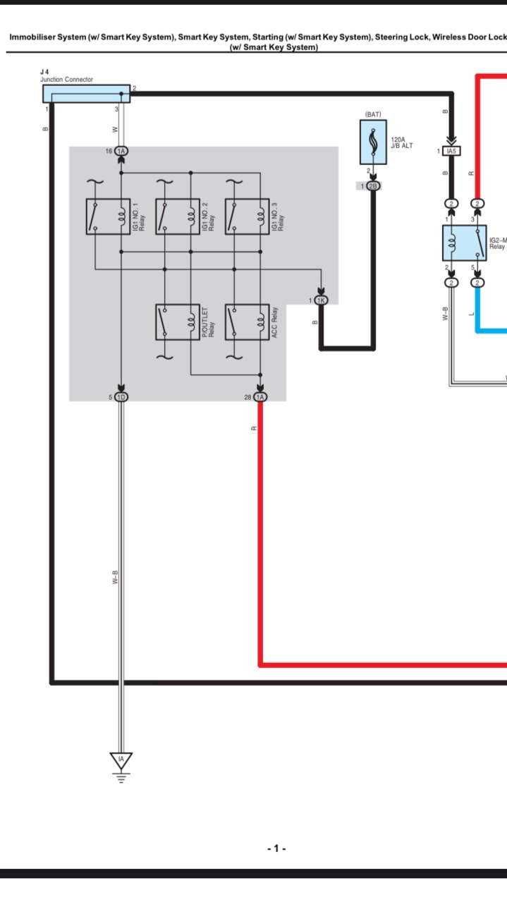

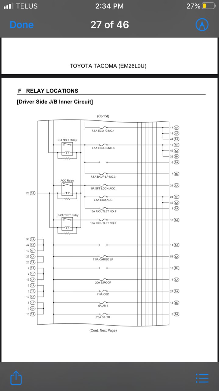

    Would any one be able to point me to the location of the ACC relay, I’ve found it in diagrams but not the location. I suspect it’s the problem since power outlet number 1 is connected to it and pulling that fuse and putting it back in causes a reset.
    So if anyone knows where that relay is hiding that would be sweet. Google search just gives me aftermarket relay accessories..

    It’s built into the J/B isn’t it.. is it even possible to disassemble?

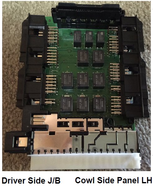

    The relay you seek is soldered to the junction block you have ID'd.

    oh great, I’m gonna remove said junction box and have a look, If it’s a single sided board I ain’t scared, well actually maybe a little.

    the reason I figure this relay is to blame is because when I increase load on it by adding on a illuminated double USB charger with a fuse tap to P.Outlet #1 it cause everything to reset and fire back up.

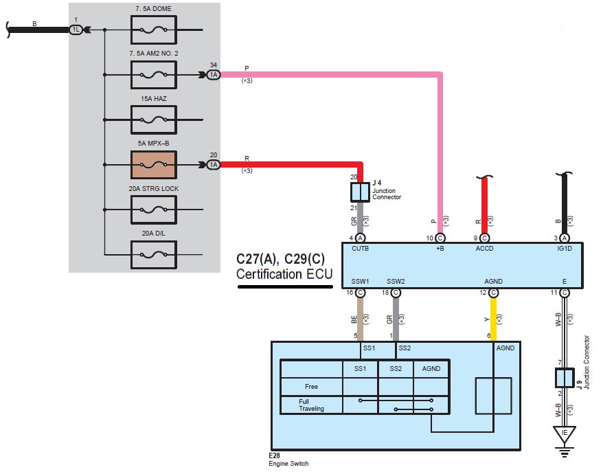

    So I figure I’d try pulling the 3 fuses that are connected to the ACC power relay, no difference. Then I figured let’s pull all the fuses until I hit one that turns everything off, so that’s what I did, fuse MPX-B will turn my radio off, turn the shift selector off and kill the door beeper, I think I found it. But I have no idea what MPX-B is and the fuse was fine.

    It’s strange though, with that fuse pulled I can start the truck, radio works shift selector works, turn the truck off and it all shuts down.
