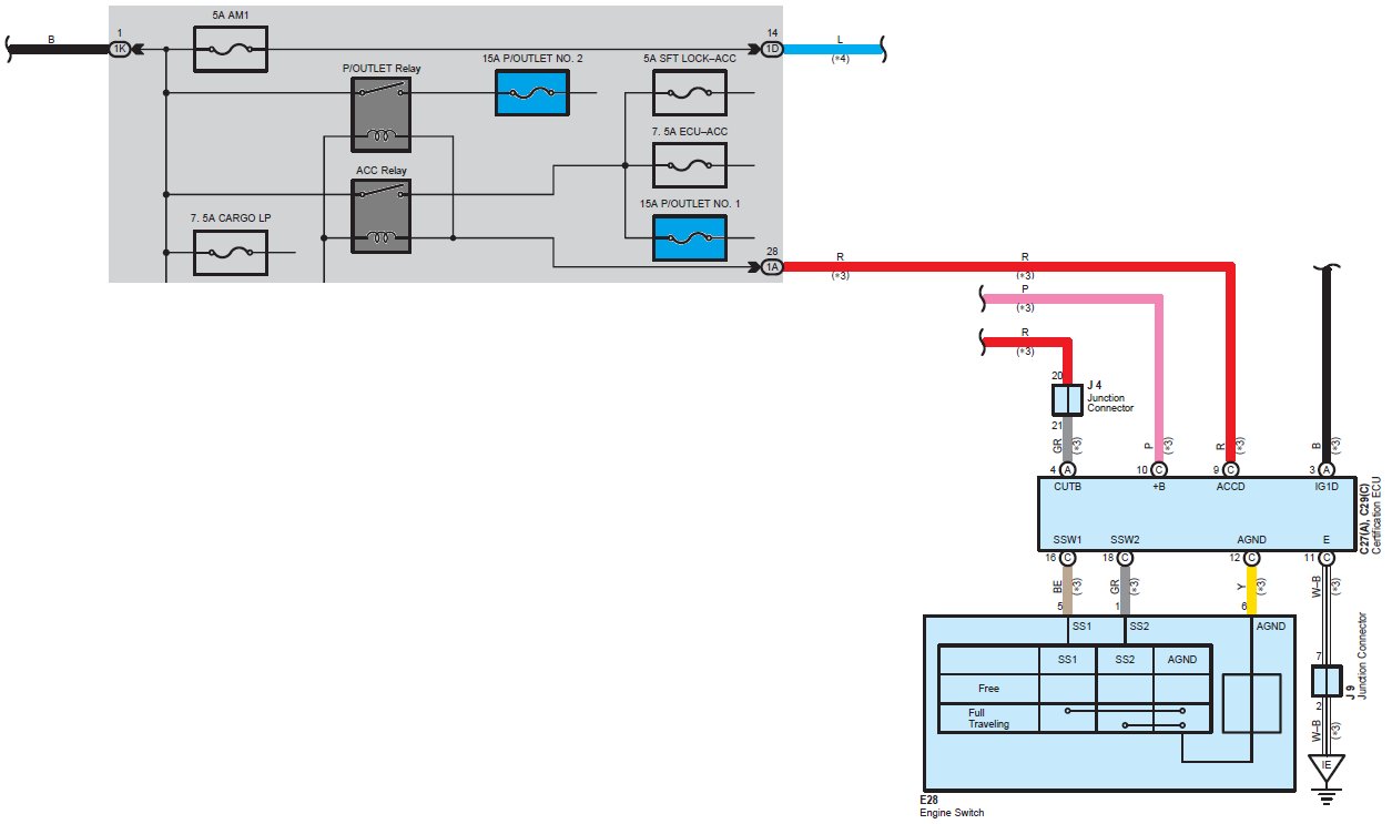

    Notice here that the Certification ECU handles the power to the relay coils you're having issues with...

    Dude thanks a lot! I definitely appreciate the help from you, I’ll take your advice and try a relay first.

    so just by doing a continuity test the relay doesn’t seem to be shorted across, its reading the same as the relays next to it. Do by any chance you have the relay diagram for these?
    and the next question is since that certification ecu is what controls these is it possible that’s what failed.

    OP, when you removed the fuse (5A MPX-B) the vehicle "returned" to all good?
  11. Mar 27, 2020 at 4:51 PM
    #71
    xMaverickx
    xMaverickx [OP] Well-Known Member
    Nov 28, 2018
    #274162
    396
    Jeremy
    New Brunswick, Canada
    2016 MGM Limited V6 4X4 DCLB
    yes other than I’d would say that also powers the smart key system so that wasn’t working but if I put the key up to the start button then the truck would run and everything all good. Instrument cluster is still behaving different even with that fuse pulled. Sometimes I’d heard that click like you normally would when the truck fully shuts off, but then the odo would appear back on the screen..

    Okay so that confirms that MPX-B powers the certification ecu, certification also controls smart key which was lost when mpx-b was unplugged so that makes sense. I’m going with a bad certification ecu.
    So just buy doing a google search on mpx-b, a lot of Toyota vehicles have problem with that system. In a Lexus it controls the tilt steering and power windows, in think it was a Yaris I read it controls the hatch, so basically for them it was killing their battery because mpx-b was remaining constantly powered. I’m gonna put mine back together and see if that’s the same case for me.
    looks like these certification ecu’s are known to fail, in fact if you google search the part number 89221-04050 you’ll find @jardoo was looking for one in February although he never mentioned why and @Skydvrr was trying to help him find one; and someone else posted that amayama no longer carries them so looks like I can’t get one there.
