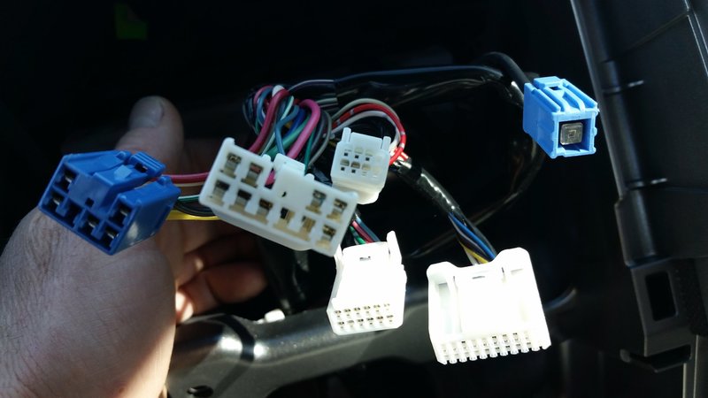

    There are 2 different radios in the 12s. I have the old non-touch screen one and this method does not work with a non-jbl w/nav HU. The radio will turn on but nothing works.

    That's really not an option I want to pursue. It could get quite expensive. The above mentioned mic runs $60. You also end up with a head unit you can't use.
    What radio do you have in your truck and what do the connectors look like?
    Mine look like
