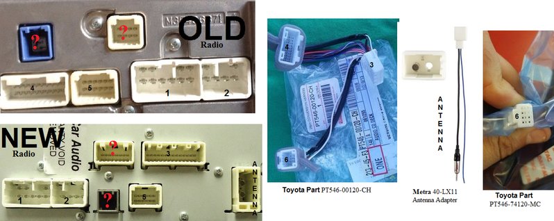

    So I came up with this little drawing, for trying to fit the 2013 unit into the 2012 unit.. there are just a few things I wasn't sure what they went to, and I labeled them with red ? Question marks, anybody have any ideas of what they go to? keep in mind my truck has no steering wheel controls, so if that has anything to do with that, I wouldn't know.. lol
    The numbers coincide with where they will attach in their new home (presumably)

    SixtyDashOne: The blue outlet on the back of the old radio should be for your sat radio antenna. This is the outlet I'm have difficulty finding an adaptor to go from that on my 2012 to a different jack on the back of a 2015 Entune I'm trying to install.

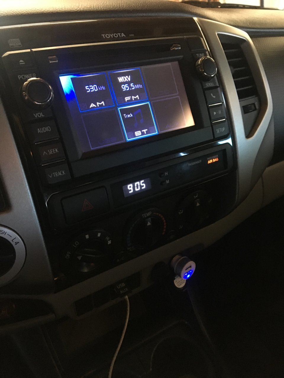

    I put the touch screen in my 2012 and my steering wheel controls work. That’s what one of the adapters is for.
    If you currently have XM make sure you get an XM compatible touch screen head unit. If you do that, the only thing that should be affected is the USB plug in. I believe that will still charge but it won’t play.
    Edit: The above picture is my phone plugged into the usb and these are my options. I did not get an XM ready head unit because I didn’t use it. But steering wheel controls are fully functional.
