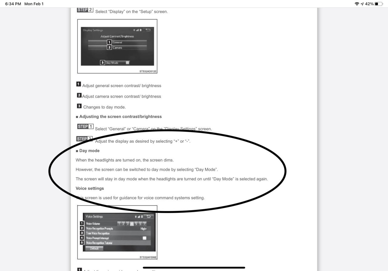

    If I have my headlights on when its raining and such the radio is too dim, the only adjustment I've seen to brighten is the one near the speedo and that still doesnt make it bright enough. Is there any other adjustments ? Note: skimmed the owners manual and didnt see anything.

    In your display settings I believe there’s a “daylight” mode. Give that a try. The Speedo adjustment knob won’t change the radio brightness.

    Yep, go to your display settings on your headunit while the lights are on and you'll have a daytime display option you can check. It's kind of annoying to need to do this everytime it's not dark enough outside for the interior to dim that much, but at the same time I guess it would be annoying to unchecked it all the time too.

    Thanks guys, just catching up on thread but yes my main issue is its too dim when I need lights on during the day (rain/overcast etc). I'll search for menu setting on radio, must have not looked hard enough before

    I believe that it’s kind of hidden in with the camera settings.

    I believe the setting doesn't exist unless the lights are on at the time you look for it. I haven't bothered with it in a while, but I'm pretty sure it doesn't stay on either once you turn off the truck (stop for gas... gotta turn it back on).
    Edit: It does stay on and now thanks to @CrazyAirborne, I very fondly remember this is why I stopped using the setting (getting blinded when it's actually dark was not fun).

    From another thread: https://www.tacomaworld.com/threads/2020-sr-hadlight-stereo-brightness.691783/#post-24439533
    Post #3
    The bright/dim settings are adjustable and do not have to be reset each time you start the truck.
    Edit: And I might add, both daytime and nighttime brightness settings are adjustable independently of each other

    I sometimes like to drive with my running lights on during daylight hours and notice this as well. Radio becomes super dim. You then check the box on the radio settings, the next time you drive it at night, you will have to uncheck that box or else your radio will be bright like the sun. Theres no winning.
