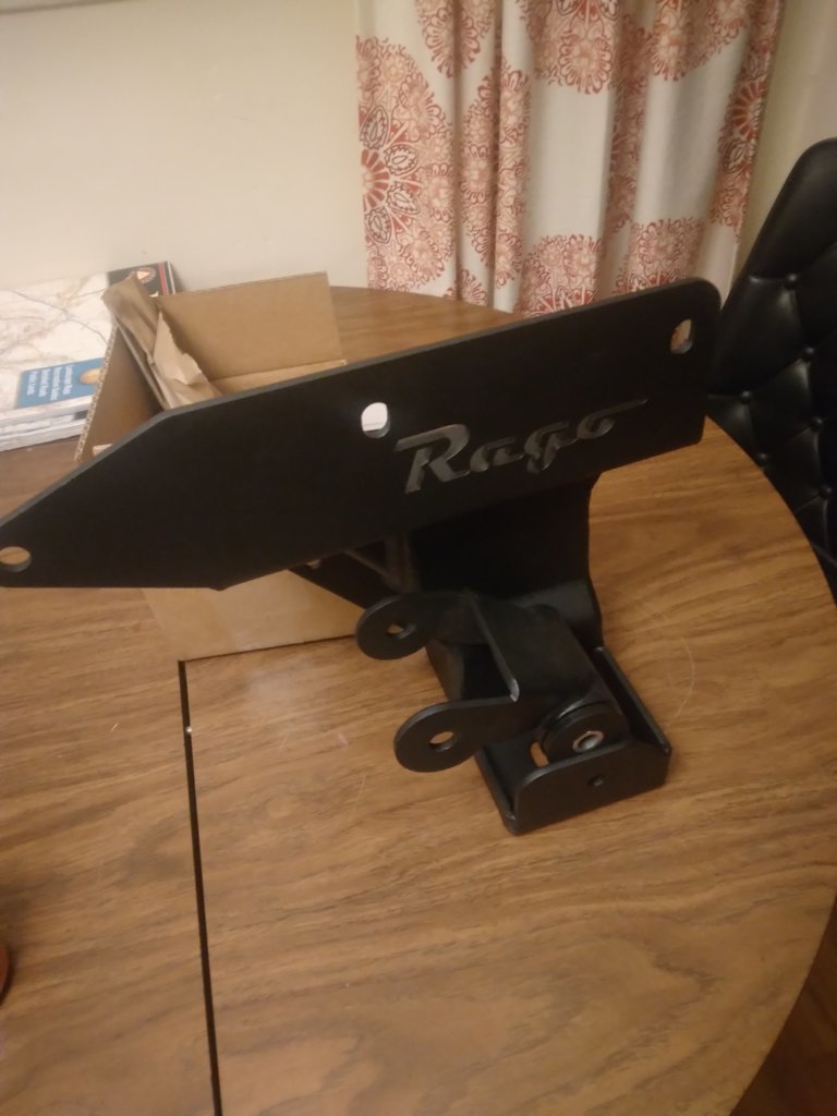

    I got the rago's I haven't installed them . R4t changed from archives to rago
    Pro's
    $420 on Xmas sale
    Beefy AF
    access hole/cover plate
    Back side bracing plate
    Con's
    They are not archive 's
    Welded at corner seems not bent smooth for slipping rocks
    No cross brace option
    Lame logo ..just sayin
    I choose them for budget reasons hangers with shackle $420
