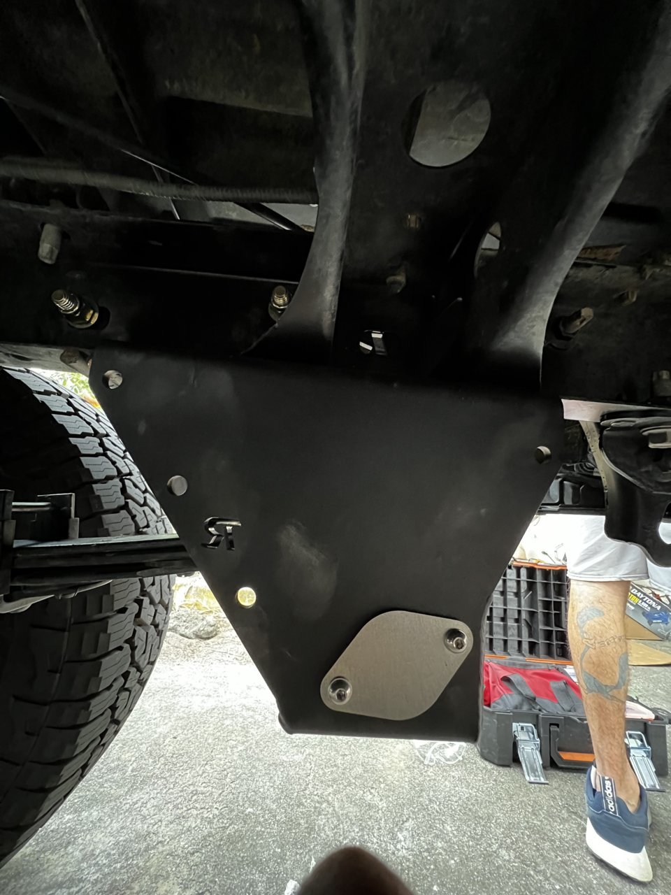

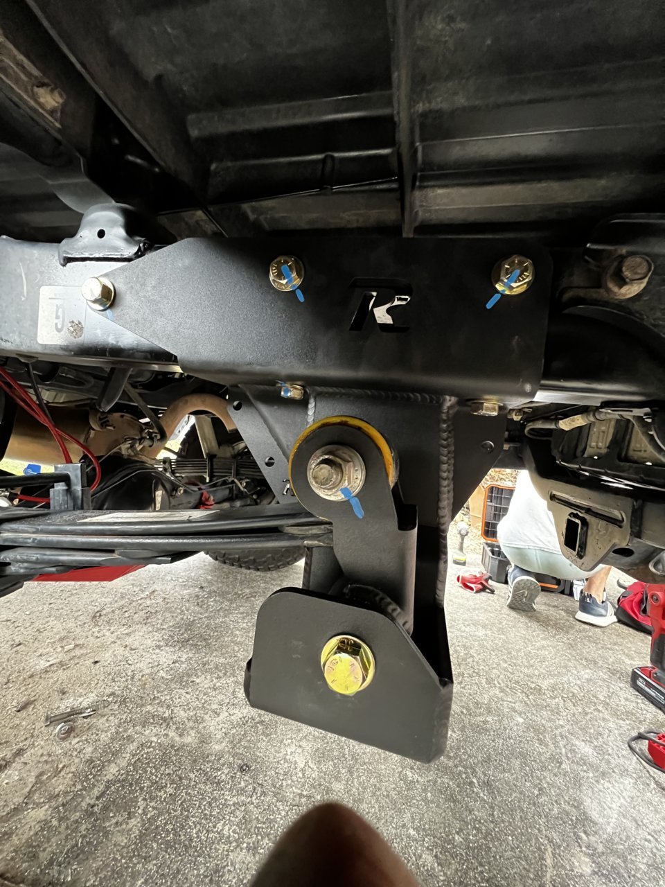

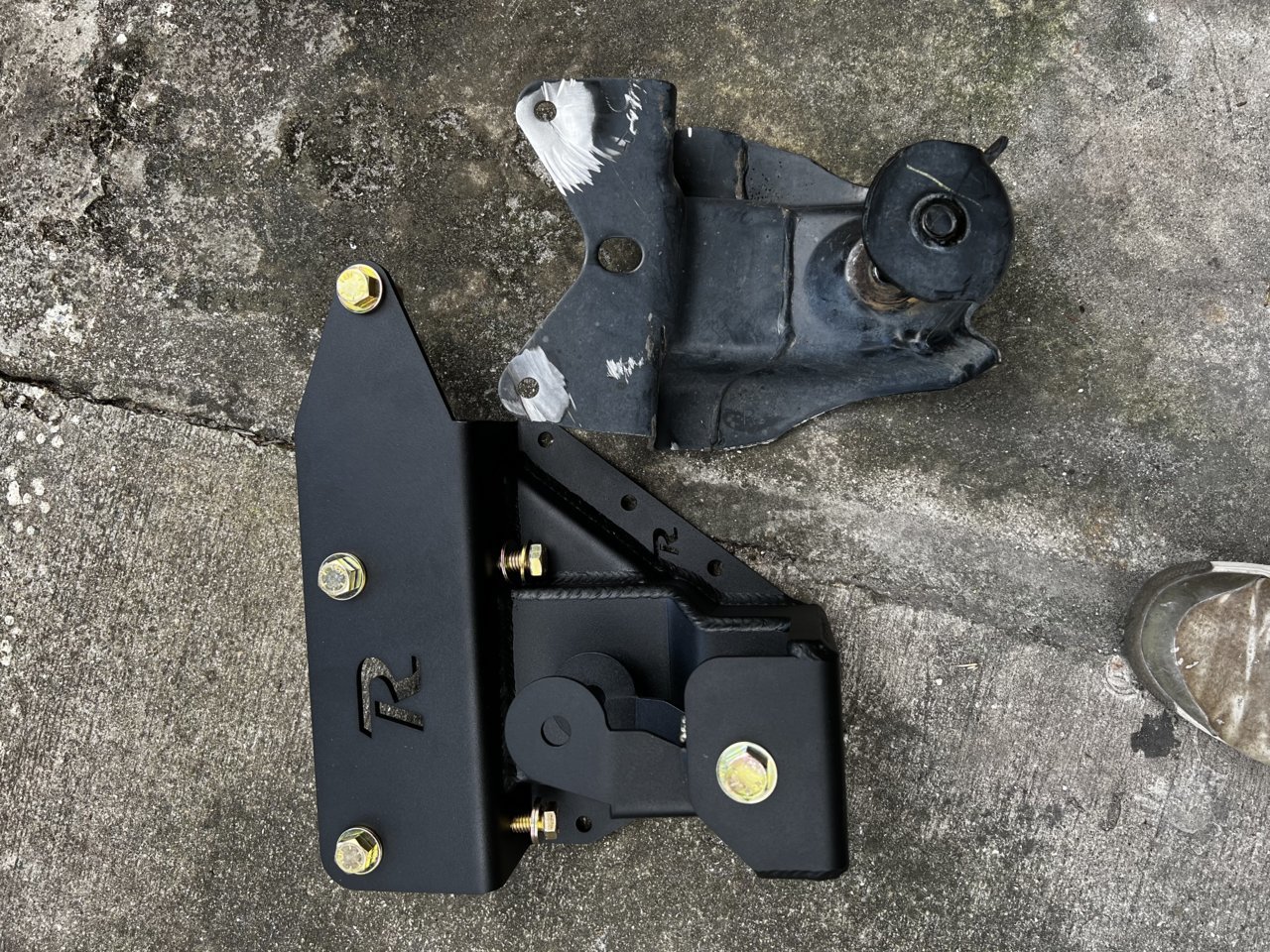

    Recently installed the rear shackle hangers by Rago fabrication and wanted to share some photos

    How do they ride?

    The ride quality has gone up, I noticed it more in taking turns the rear has more articulation to it. Have a trip coming up to citrus soon so it’ll be nice seeing how they can really preform

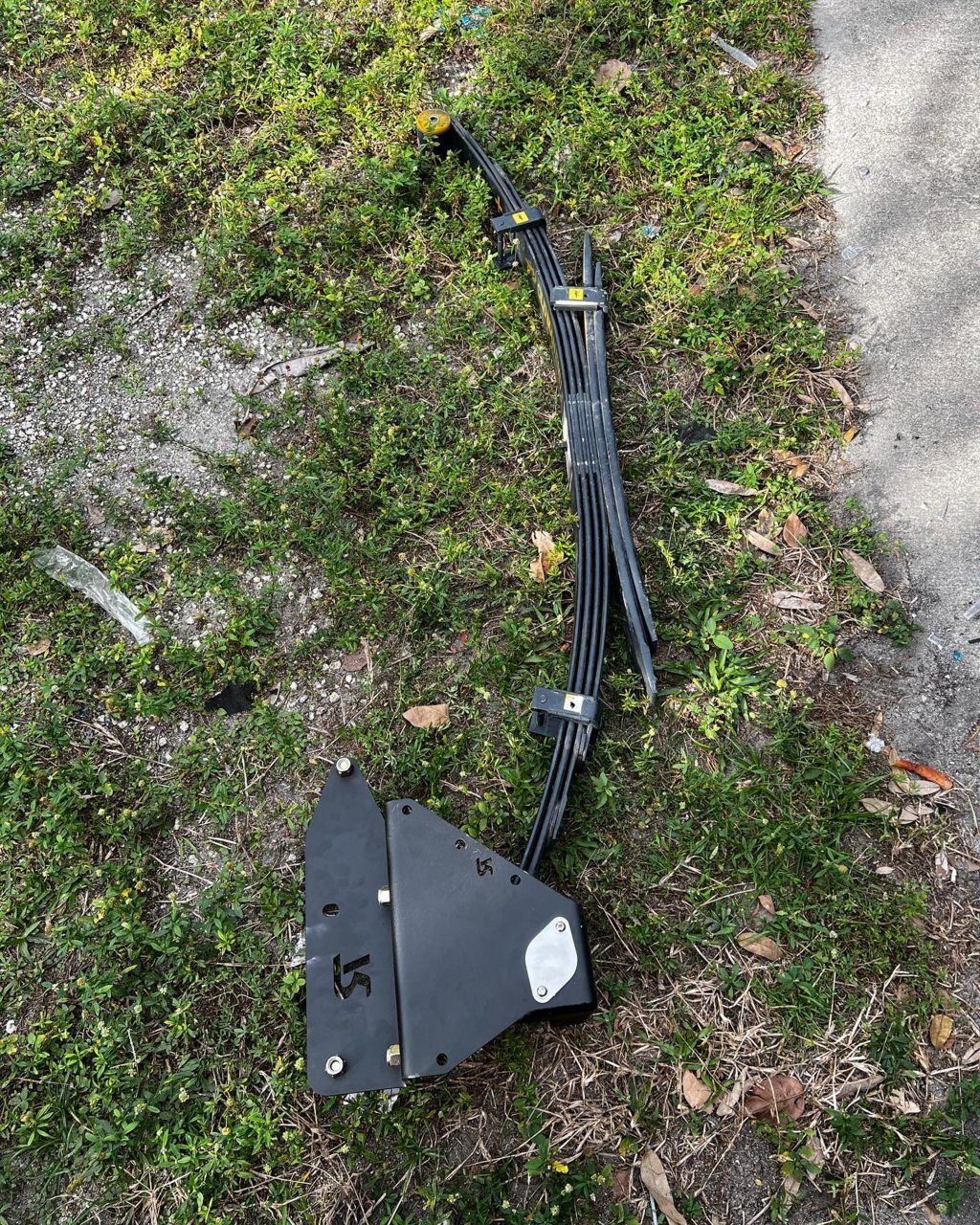

    Any tips OP? removing the OEM hangers and aside from dropping the rear, shocks lower bolt, etc..

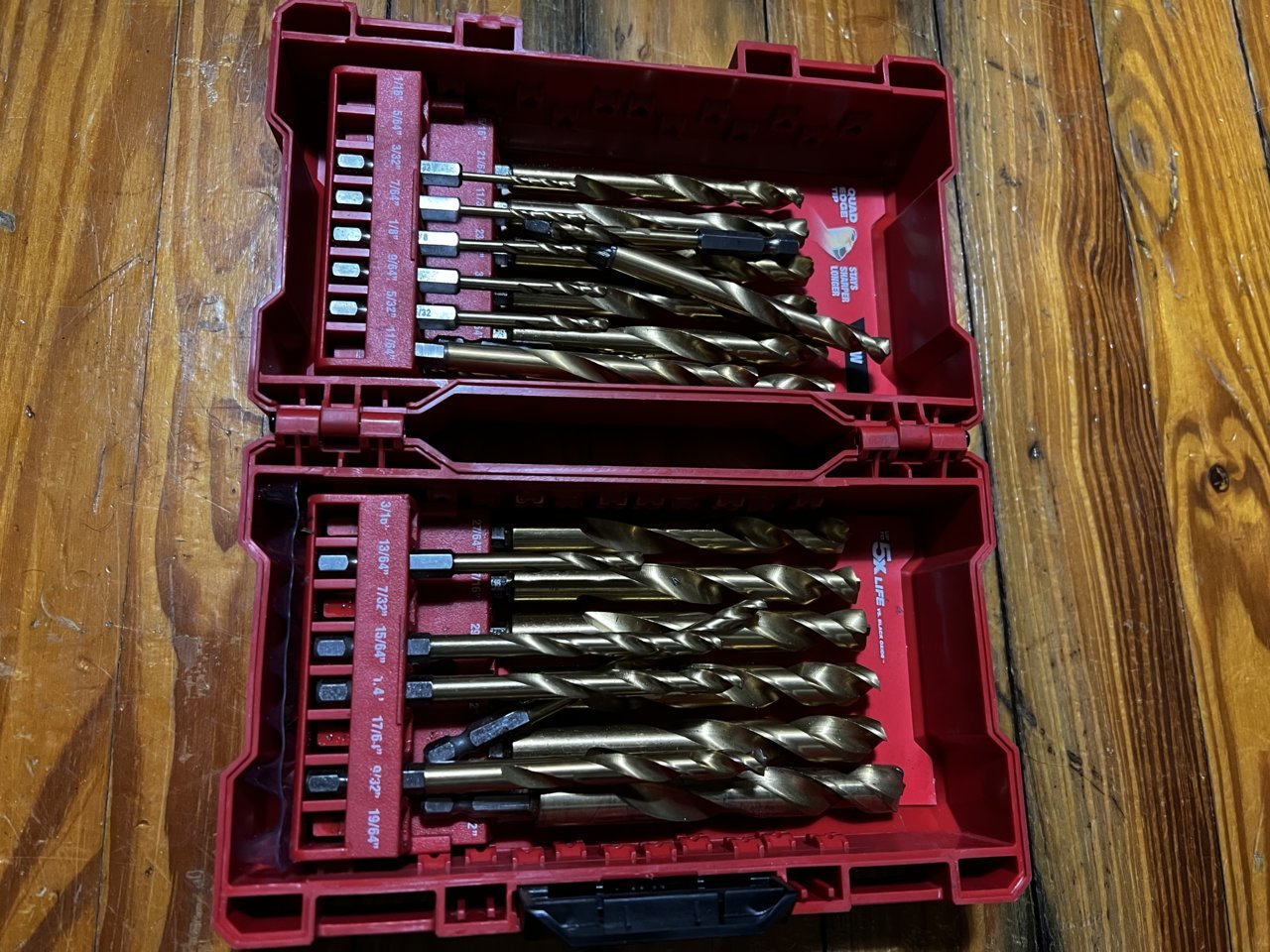

    I’d start by taking your leaf pack out, the Milwaukee metal bits Iv posted a photo of worked perfect for drilling straight through the rivets. Grind off the rivet heads after drilling through them because after you smooth them out it’ll be difficult to see the outline of the rivets. The two rivets on the inside of the frame are tack welded so I got a Dremel tool to cut them free. Then I just beat the stock hanger off the frame, in my case I bolted the hanger to my leaf pack and installed as one big piece

    Awesome tip, I did notice the pic with the hanger and leaf together. Great idea. We just installed Deaver leafs and hangers from bamf and it was bi#ch aligning the bushing and bolt, little room to spare for nut and bolt install.. Big thumbs up bro! Good looking out..

    Thank you! I forgot to mention the reason we put the hangers and leaf together first is because of the leaf bolt and not having any room to reinstall it threads facing outwards.

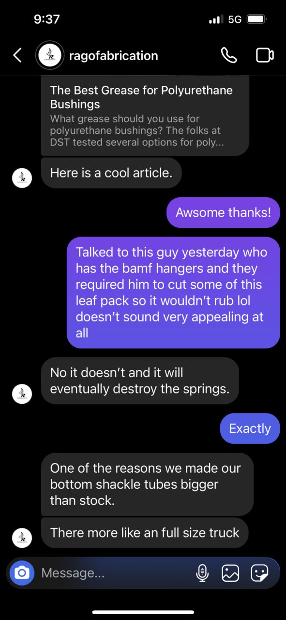

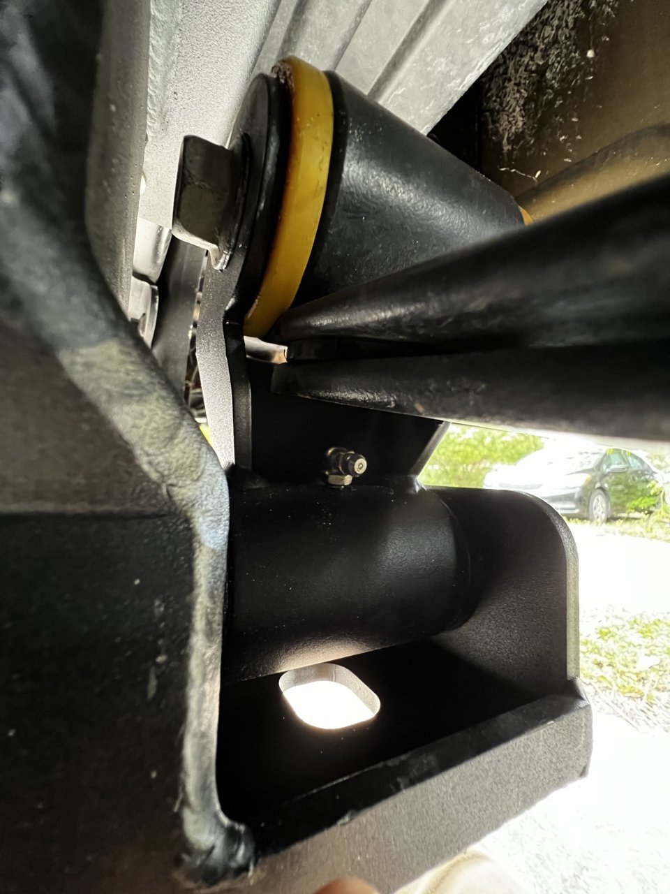

    Does the OME secondary spring make contact with the shackle?

    Not sure if I understand what your saying?

    idk how it would avoid it since its almost identical design to the other hangers on the market. Id still keep an eye on it.

    That convo really doesn't sound like he knows what your asking tbh.Idk why he is talking abut the shackle tube when that doesn't have to do with the issue at all. The issue is the first leaf makes contact with the shackle side because the Dakars fan out. Also in some cases can get stuck under the hanger its self. You just cut the very tip of the leaf off with a grinder. Very easy to do, painless. Leaf is the one right below the bushing eye.Mine is cut in this pic.

    This is the first time Iv seen that happen with ome, Iv had no issues with mine on stock hangers

    Thats because the stock hangers don't allow for the droop that a aftermarket one does.
