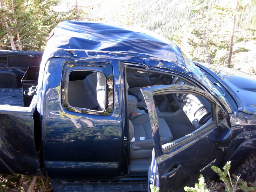

    Check out EvilX's rollover on a mountain. Note how the doors and outer edges held the weight and the center was just crushed anyway.
    Hardly conclusive though.
