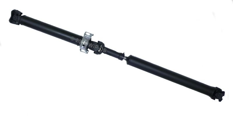

    do you know what a grease fitting looks like ? there will be one on each U joint on the drive shaft, and one on the slip yoke ( the piece that allows the drive shaft to move forward and back when suspension cycles)
    https://www.tacomaworld.com/threads/greasing-entire-drive-shaft-u-joints-5-zerks-total.56976/ ( info in link specs first gen Tacoma in earlier posts, info is similar to yours but not identical)
    there are 4 fittings, one on each joint and one on slip yoke ( picture may not be exact, but similar)
    unfortunately the center bearing is not grease-able

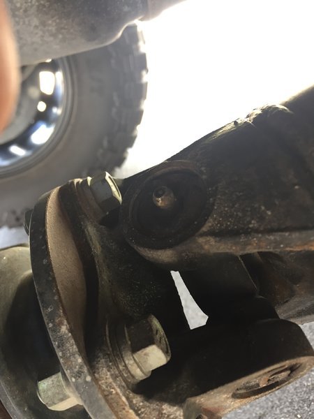

    okay so I've never seen a grease fitting. but a simple google search shows me its basically like a nipple that the grease gun fitting connects to, and i shoot the grease into each fitting until all the old grease is pushed out.

    I just went under the truck. This is what I'm looking for? I found a total of 3 on the driveline.
