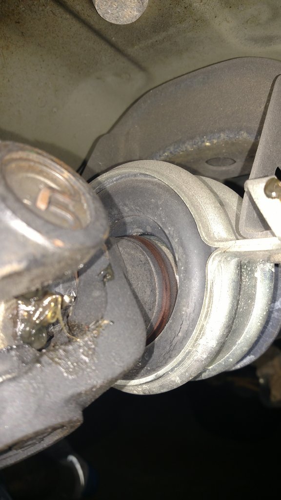

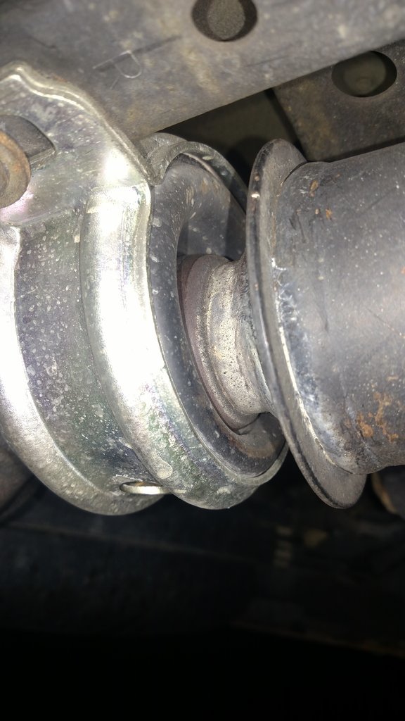

    I did that one for a ford ranger, you might as well do the u-joints in rear as well

    That's the annoying part, I JUST had all the u-joints and the carrier bearing replaced last year. I think this time I'll try it myself tho.

    really it was replaced last year?

    Do you have it turned the right way? Should see an arrow on the lower side.

    I can't remember exactly when but it doesn't seem to long ago, definitely not long enough for it to go bad.
    I'll check in a bit when the sun comes out, a shop installed it all when it was replaced

    Toyota put mine in upside-down when they replaced my frame. Simple fix, 2 bolts. I was happy they got the frame done as quickly and without any major problems.

    I remember mine was upside down when I got it back, I started driving home and the vibrations were horrible, I pulled over and noticed the hooks on it we're on the bottom while all pictures on here had them on top, I flipped it real quick in a parking lot and it was way better. I haven't noticed any arrows or markings on it tho.
