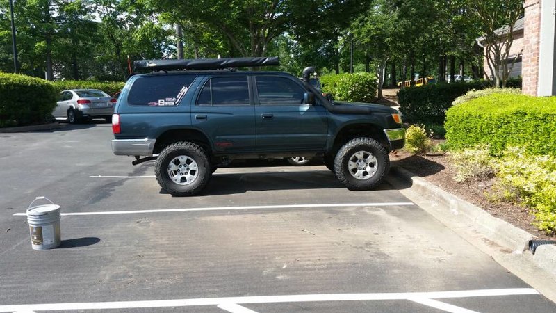

    How do you like your suspension setup? I'm apparently riding on 20 year old suspension in the 4runner, I was low riding with nothing but a full cooler in the back this past weekend lol

    Haha yeah 4runner are known for having a saggy ass. I like my setup for the price and performance of it. The lift height is good and does great offroad.
    I would do two things different. I would get a bigger shock to soften the ride up offroad. On road is fine.
    I would also swap my rear coils for something a little more load bearing as I carry a lot of gear. Maybe 200lb+-
    The ome coils I have in the rear sag a little with that weight and they're the stiffest spring ome offers for the 3rd gen. I think you can do land cruiser coils or toytec superflex and get more weight rating but then you get a stiffer ride lol
    Overall though i would recommend it to anyone who wants to offroad and not drop 2k on there lift.

    Rock Auto MOOG rear coils for LIMITED 2" of lift and some load ability ( Limited with auto, AC and leather are heavy pigs, they also apparently have more sound deadening in them adding weight). The coils were under $50 for the pair
    I used KYB GAS A Just shocks when I did the swap, off road wasn't a consideration at the time, but Towing was. I did also add air bags to the coils as my camper is a heavy pig and I didn't want to trash the new coils.
    I also replaced the front springs and struts with full strut spring assemblies ( also for Limited ) from Amazon, those were $190 for the pair shipped, you can't buy the parts and assemble them that cheap ( couldn't at the time )
    I got about 2" of lift over what it had ( mine is a '97 SR5 V6 5spd 4WD just throwing this out as a budget option, front coils can be had at Rock Auto as well.
    4 years later and my POS still sits better than most stock Runners on the road.
