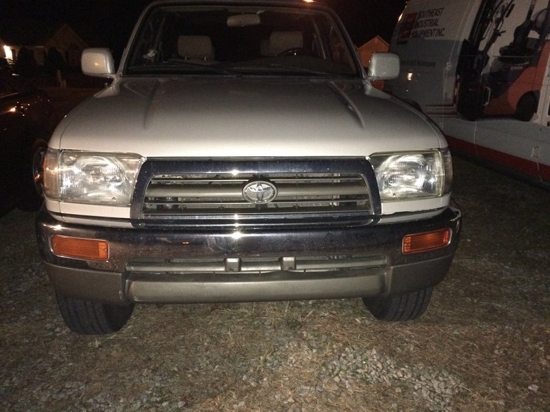

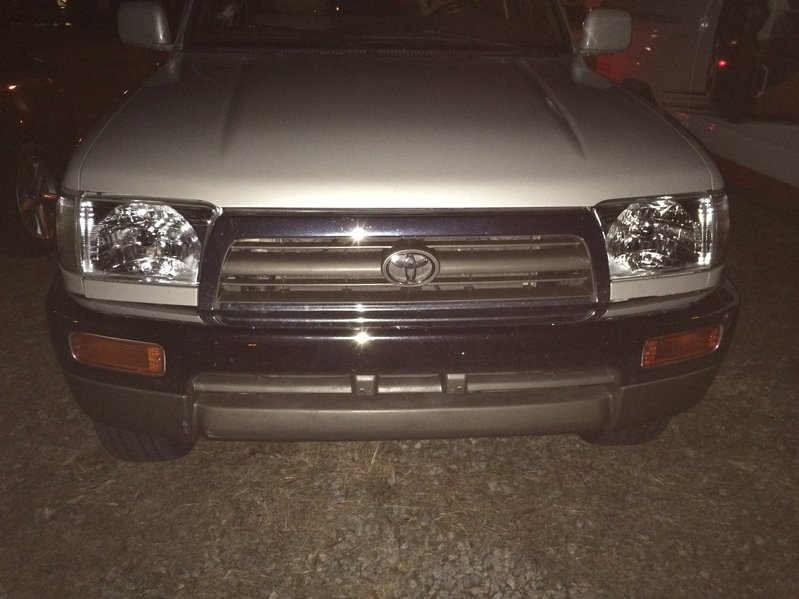

    Yeah the lighting is pretty terrible. I've already swapped for some 02 tail lights. I should have grabbed his head lights to but wasnt sure they were direct fit at the time.

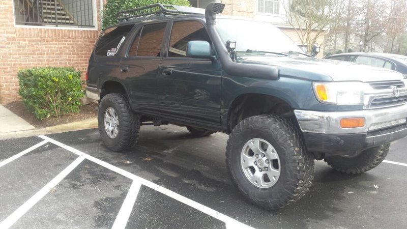

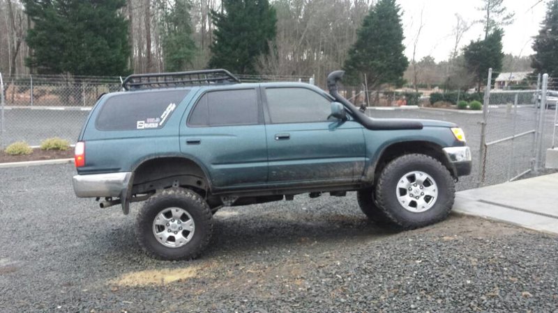

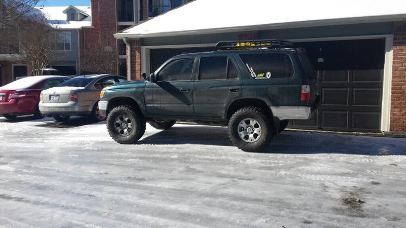

    Few things have happened to the ho runner in the past week or so.
    Got the windows tinted and put some 285 pro comp mt2's on!
    I'll try to snag some better pics in the morning.

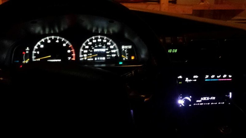

    Got the led gauges put in. Loving it so far. Makes such a huge difference.
    A few random pics
    Also the air compressor parts are in so hopefully that will happen this week!
