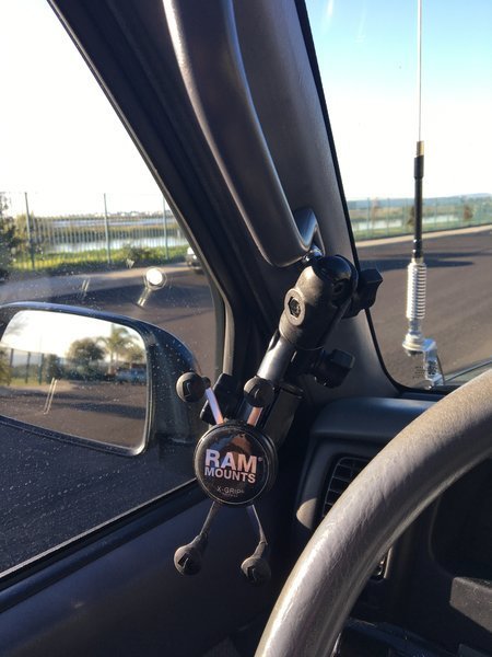

    This is my version of this:
    https://www.tacomaworld.com/threads/gps-install-hardwired-to-the-a-pillar.305904/
    I've got about $55 invested, which seems expensive for a phone mount, but you're all aware how easy it is to justify/rationalize spending any kind of money on our trucks. I used the part numbers in the original thread and found them all on eBay. A local hardware store provided the rest.
    The 99 Tacoma hand grip isn't as contoured as the one in the thread I linked to, but the end result is just as satisfactory. There's a philips head screw holding it in place under the trim cover. I used a knife to carefully pry the piece out. There's some locktite or something similar holding the original screw in place, so be careful not to strip out the head.
    Factory screw size is 6mm x 1.0.

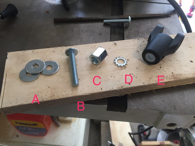

    With the trim cover removed the RAM motorcycle mount is too wide to fit into the recess, so I had to improvise a spacer.
    Here's what I came up with:
    A. 1/8 x 3/4 fender washers...I couldn't find 3/16 x 3/4 so I just drilled them out to fit.
    B. 6mm x 1.0 x 40mm...it's a philips head and happened to be perfectly sized for the RAM mount.
    C. 1/4 thread coupler...this is used as a spacer so that the RAM mount doesn't squish the hand grip. The coupler had to be cut down to fit so the mount was just above the handle.
    D. Lock washer...I had this laying around in my shop. It works out to be the same overall diameter of the 6mm screw head so it fits inside the RAM mount.
    E. The RAM motorcycle mount with a nylon spacer...the opening in the bottom of the mount is too wide for the screw, and I didn't want it to be able to wobble around. I bought a nylon spacer that was 1/2 inch OD, with an 1/8 inch ID, and then drilled it to fit the 6mm screw, and also turned it down on my lathe to fit inside the RAM mount. If I didn't have the lathe it would be easy to shave it down with a utility knife or something.

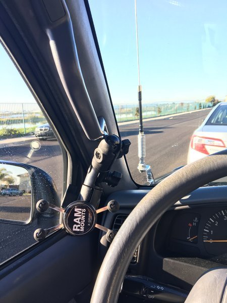

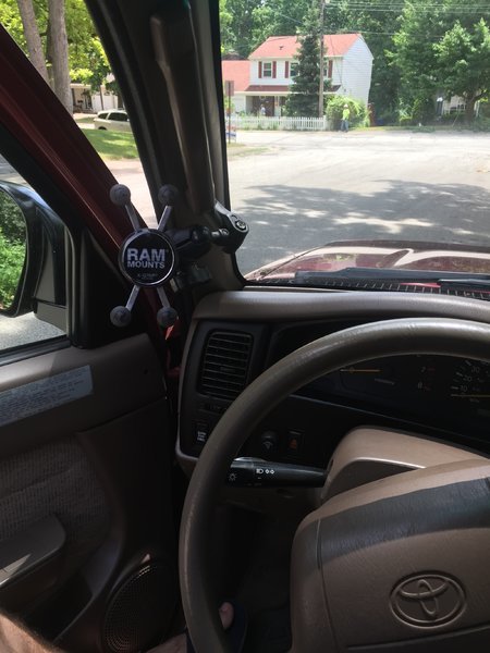

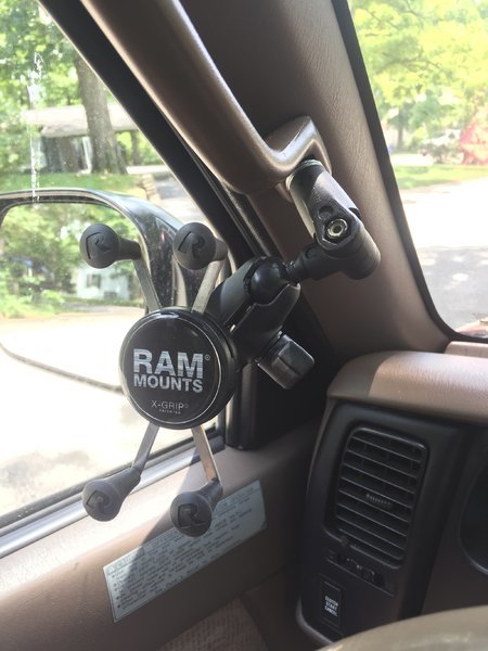

    Here's another angle:
    The way I've got it positioned it is far enough away from my steering wheel to not be a hindrance, and from the driver perspective it lines up with the A pillar so it doesn't cut off any view of the road.
    I omitted the charging cable at this point since I am waiting on the release of the iPhone 8, and there are rumblings of a different connector than the current "lightning" plug. At that point I'll run a cable like the original thread to provide charging capability. My stereo has bluetooth connectivity so I'm not worried about having to plug in for music.
    The modification of the hardware added some measure of complexity to the project, but overall this was simple to do, and actual time invested was about 30 minutes. I like the location since my eyes are not directed far away from the road if I change songs or whatever.

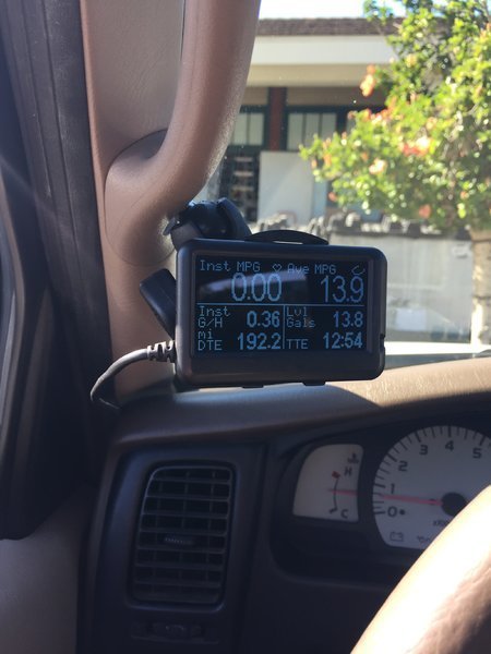

    I have a similar setup for my Ultragauge, love it!

    What did you do on the back on the UG to connect to the ram mount? I have one with the tape it up mod, and it kinda melts!:rant:

    I just have some double sided heavy duty mounting tape, Scotch brand I think. I have this for the ball mount and then adheared the Ultragauge mounting bracket to it. It's great cause I can pop the Ultragauge in and out as much want wothout having to redo the mounting option.
    The funny thing is the tape was supposed to be a temporary mounting solution, but hasn't shown any signs of letting go
