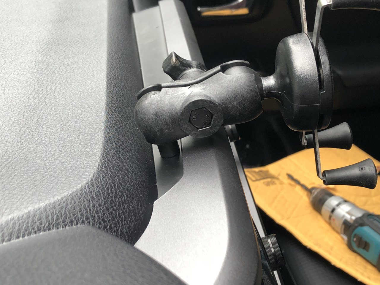

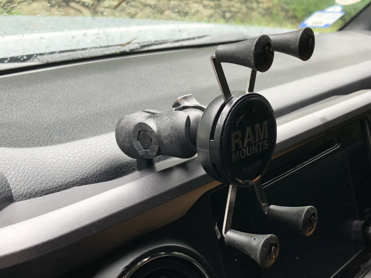

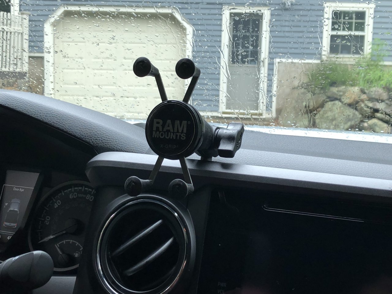

    I know there’s a few threads out there using RAM Ball products for a phone mount, and some vendors that have really nice no-drill options. However, if you’re willing to drill one 1/4” hole that you’ll never see, and want to save some money, consider this option I just did:
    Parts list:
    Ram Mount 1/4-Inch-20 Female Threaded Hole with 1-Inch ball https://www.amazon.com/dp/B006RKF1X8/ref=cm_sw_r_cp_api_i_NREyBbAAFB184 (I spray painted the post black)
    Ram Mount Composite Short Double Socket Arm for 1-Inch Ball Bases https://www.amazon.com/dp/B005KWPJ04/ref=cm_sw_r_cp_api_i_fSEyBb0BAEE74
    Ram Mount Cradle Holder for Universal X-Grip Cellphone/iPhone with 1-Inch Ball - Non-Retail Packaging - Black https://www.amazon.com/dp/B0055PH0XA/ref=cm_sw_r_cp_api_i_JSEyBb2DE2054 (Apparently unavailable at the time of this post...)
    And obviously a 1/4”-20 bolt and washer, which I picked up at the local hardware store for $0.50

    Did the exact same thing with mine. Only issue is I might put a bit of a backing plate below the plastic as when going down a really rough road it bounces a bit. But I agree, for the price, it was really easy to do.

    Thinking more about this - how solid is that? I feel like it would not handle bumps very well, would it benefit from a backer plate?

    It definitely would, but there isn’t much space back there. I couldn’t even fit a washer. An aluminum bar would work, but I don’t know how much rigidity it would add. It wobbles a little, but it’s fine for my puposes. Too wobbly to use as a dash cam, at least the way I installed it.
