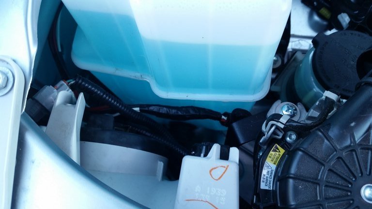

    So I finally relocated my smog pump using the brackets provided by K&N..
    I figured that if I relocated the smog pump, I had to elongate the wiring.
    Which side should I elongate? the end female end or the male end at the pump?
    the female end had weird wire colors:
    The male end at the smog pump had simple colors: red, black and two small white wires.. easy wire colors to buy at NAPA:
    Here goes the surgery:
    Soldering and shrink tubing:
    Finished product:
    Then I decided to plug it in and make sure it worked:
    Once operation was confirmed, I removed the cover:
    Installed the k&N brackets:
    Set the smog pump at its new location:
    Installed the cover back on:
    Routed extended wiring behind the windshield wiper fluid reservoir:
    Plugged over the air box tube:
    Trimmed the hose that connects to the smog pump:
    Final pictures:
    Does not stick above engine bay compartment:
