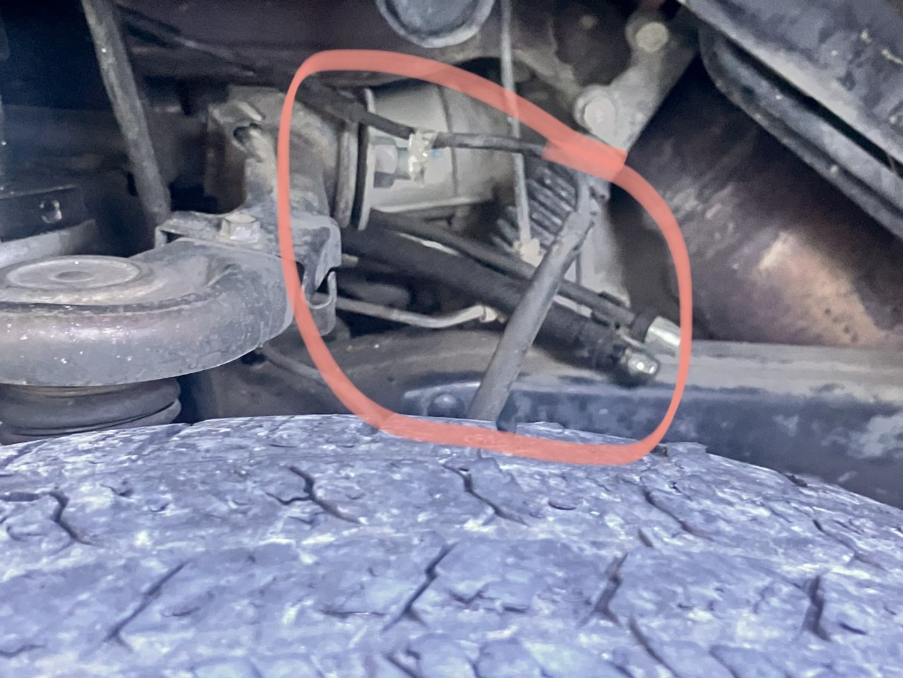

    this new hose is popping out behind my upper control arm, never been there before anyone know what it is and where it goes so it’s not in the way ?

    the brake line that is not in the clip? or the extended breathers laying on the frame??
    you can rest assure it is not new, and is original to the vehicle

    It’s not a hose, it’s a wire. That’s the abs sensor. It should be clipped into that bracket that’s bolted to your control arm.

    extended breathers! i know the break line is supposed to be there, where do they go originally and what the hell does it do if you don’t mind explaining?

    sorry for the confusion i’m looking at the tube right behind that

    Those are the breathers for your front diff and transfer case. There’s a bracket that holds them to the back of the engine. The bracket must have failed which is why they fell into that position.

    Where they normally go. This is looking down your inner fender where the battery and fusebox are:
