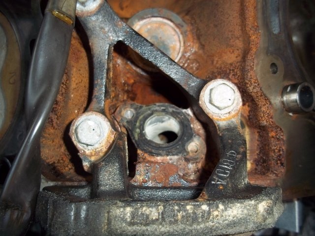

    Reseal the front end of the "coolant bypass tube" under the intake, yellow arrow in the stolen pic below.
    2 bolts, 10 minutes and a smear of RTV. No gasket or o-ring.
    CodeSeven likes this.
